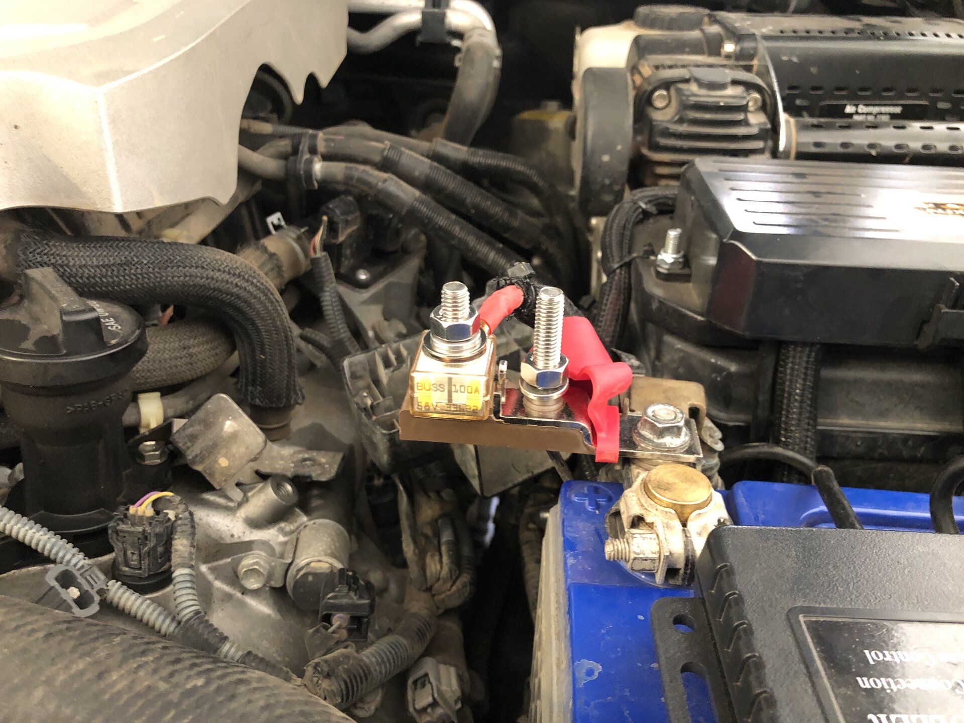

Here is what I ended up going with for my battery terminal setup. Blue sea makes a battery terminal mounted bus bar. It has two posts and they make special fuses for it up to 300 A. I mounted it to the positive battery terminal, and then mounted my accessories to a 100 amp fuse. Probably overkill since I already have fuses or breakers on the accessories, but I wanted a fuse as close to the battery as possible, and this fit the bill. It came with a cover for the two post, and I was able to snip a small bit of the factory shield back to accommodate. Now everything is fused and covered right at the terminal, and I have an extra post for expansion in the future.

I like you were able to keep all the positive posts covered!
I'm not a fan of the big exposed blocks connected to positive due to risk of shorts.
I set mine up with two wires going to positive. One goes to a breaker which then breaks out all accessories. The other goes to the winch. I also have all my grounds collected on a plate that is inline with the chassis ground, rather than on the battery. Two exceptions to that are the winch and the switch pros which specifically call out a direct ground to battery.
The two relays on top are for lockers :D.
Clean Set-up. Where did you get that battery tie down bracket?
