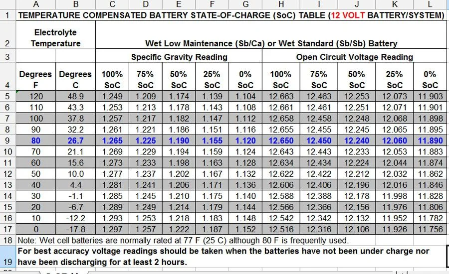

Yikes ... just put the Fluke to the Panasonic battery: 12.22v at rest. The new battery might find itself in use far sooner than expected. Can't complain though, April 2012 through June 2018... 6 years plus for the OEM is a good run. Oddly, cranking the beast shows no hint of a dying battery, yet.
12.2 at idle or engine off? If engine off that sounds fine, what would you like to see?
A charged 12v lead acid in good condition should read 12.6v or higher after sitting a few hours.
