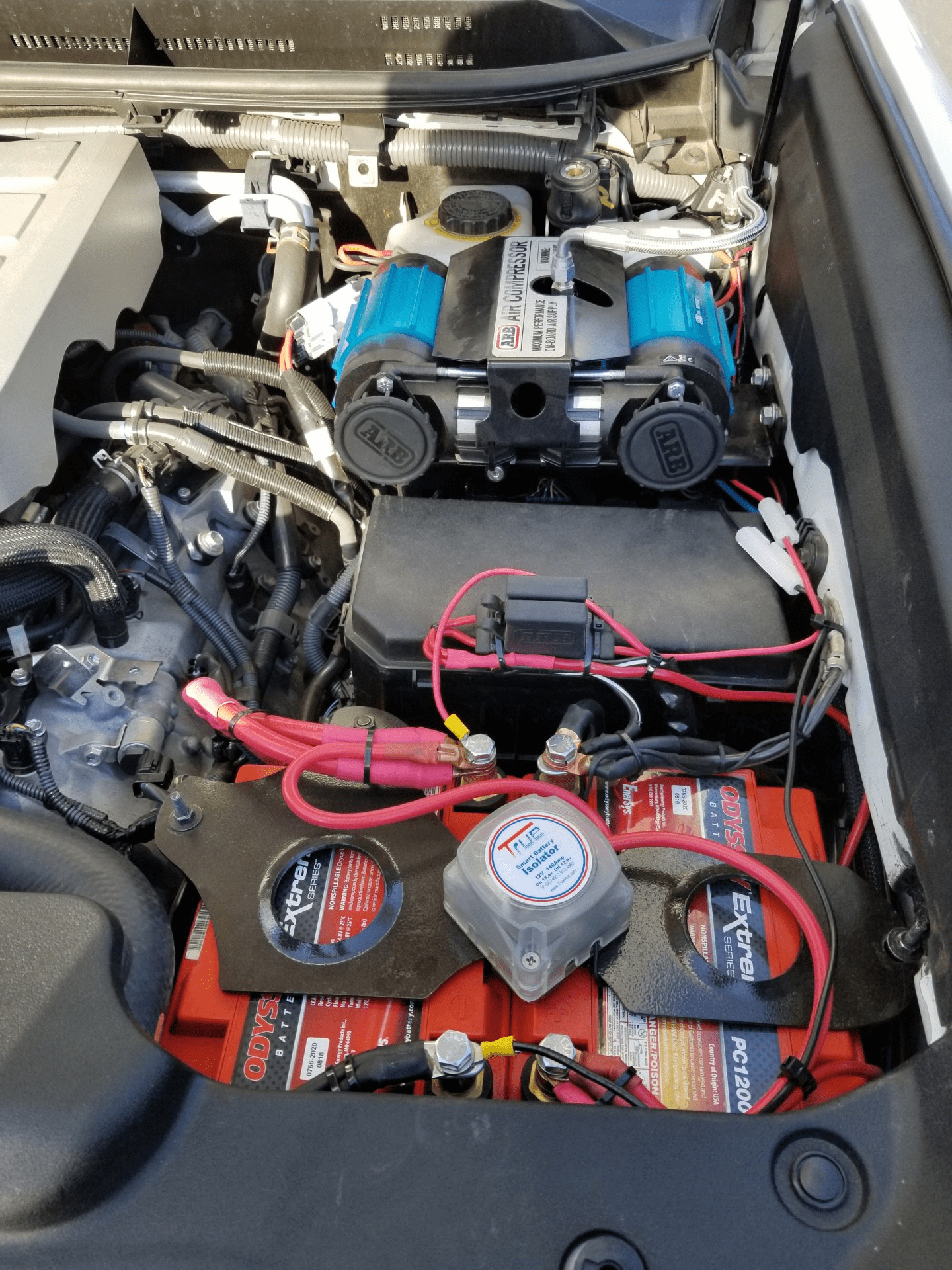

I've been using Odyssey batteries for almost 20 years in all our vehicles.
I use 2 P1200's in the same space as the single factory. They are expensive, but worth it.
