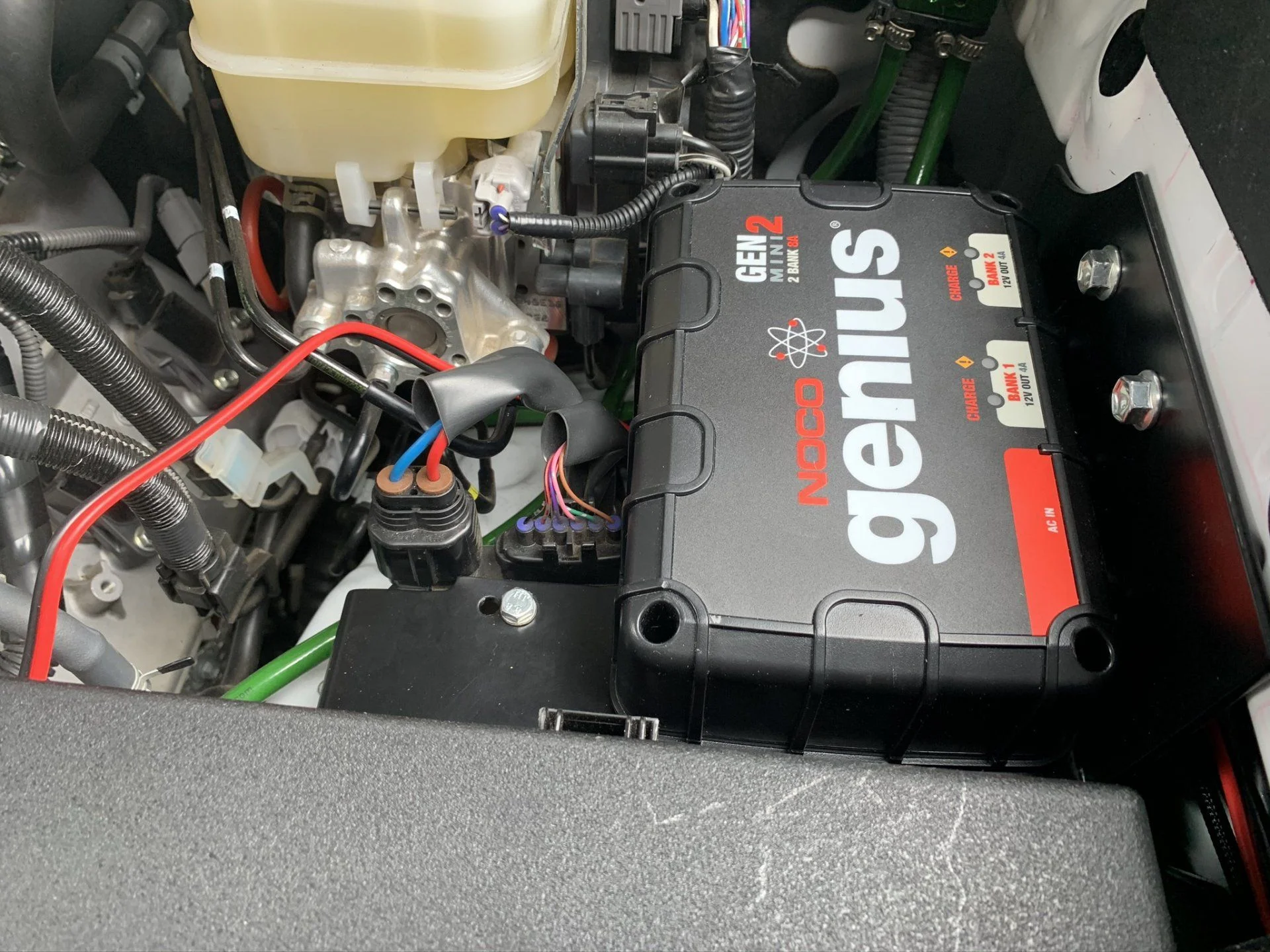

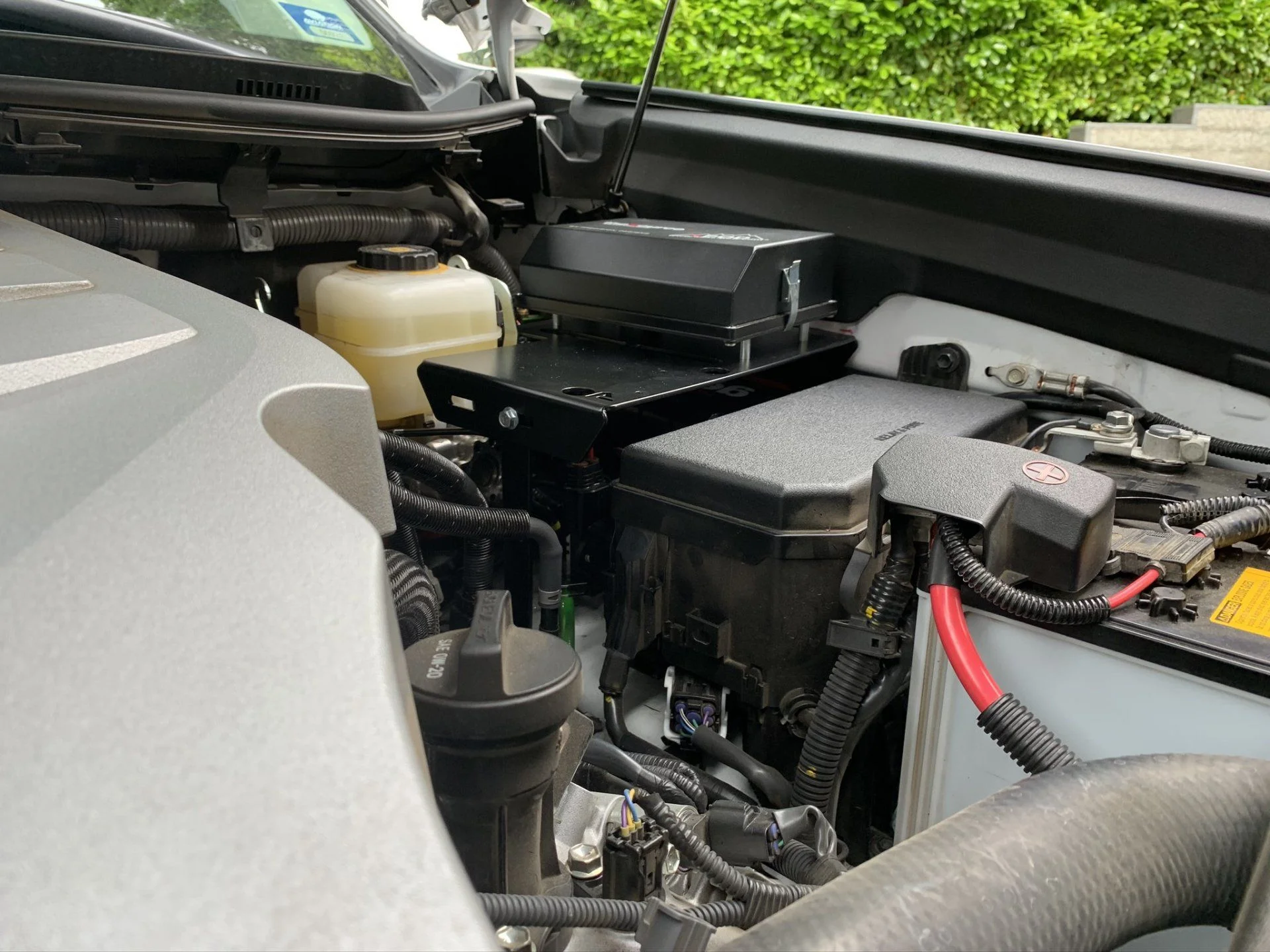

I second going with 27F. Fits perfectly and since mine is AGM I installed the NOCO dual bank battery charger. Mines not a daily driver so I plug it in. Keeps everything topped up and great for loading the fridge up the night before a trip. I went with a Northstar 27F, 160 amp hour reserve 880 CCA.
Is it basically this one since Northstar and x2 are made the same.
I ended up going with the x2 27f AGM and it fits like a glove without any modifications. Now just need to figure out if I need to up the voltage using a diode or something
