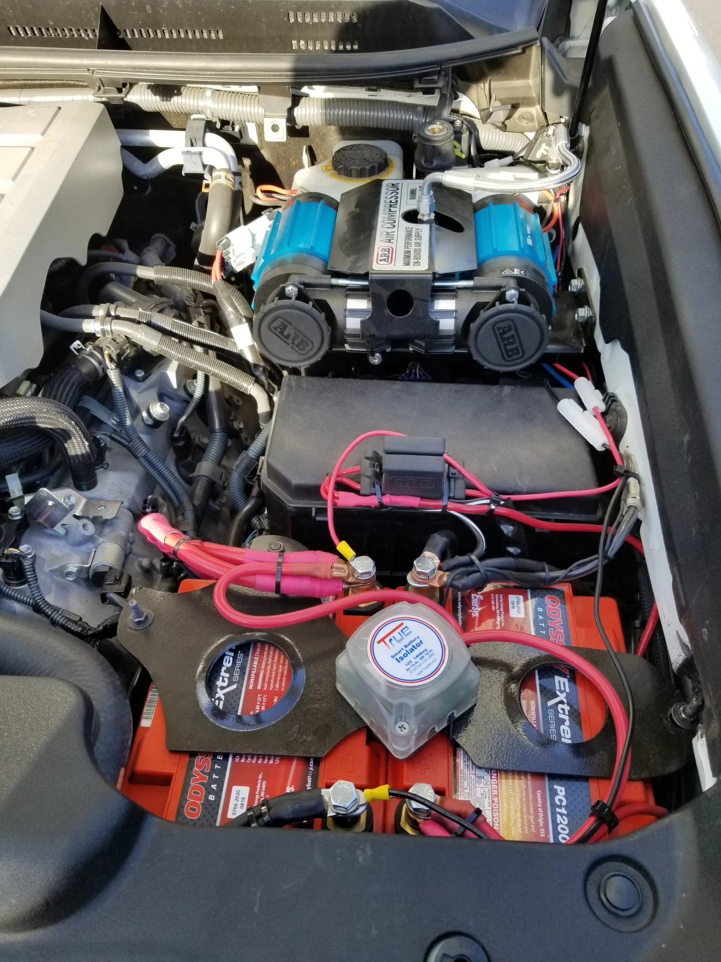

I've been using Odyssey batteries for decades. Smaller than lead acid, but heavy. I have PC1200's in the stock location, one for house, other to starter.

Was looking for folks’ battery setups - this one’s great.
Can I ask where you went to ground from the battery negatives in these photos? Did you take the 1/0 AWGs down to the drivers side frame? Did you find a threaded hole somewhere?
Also did you upgrade the engine ground, and if so where did you connect to the engine block?

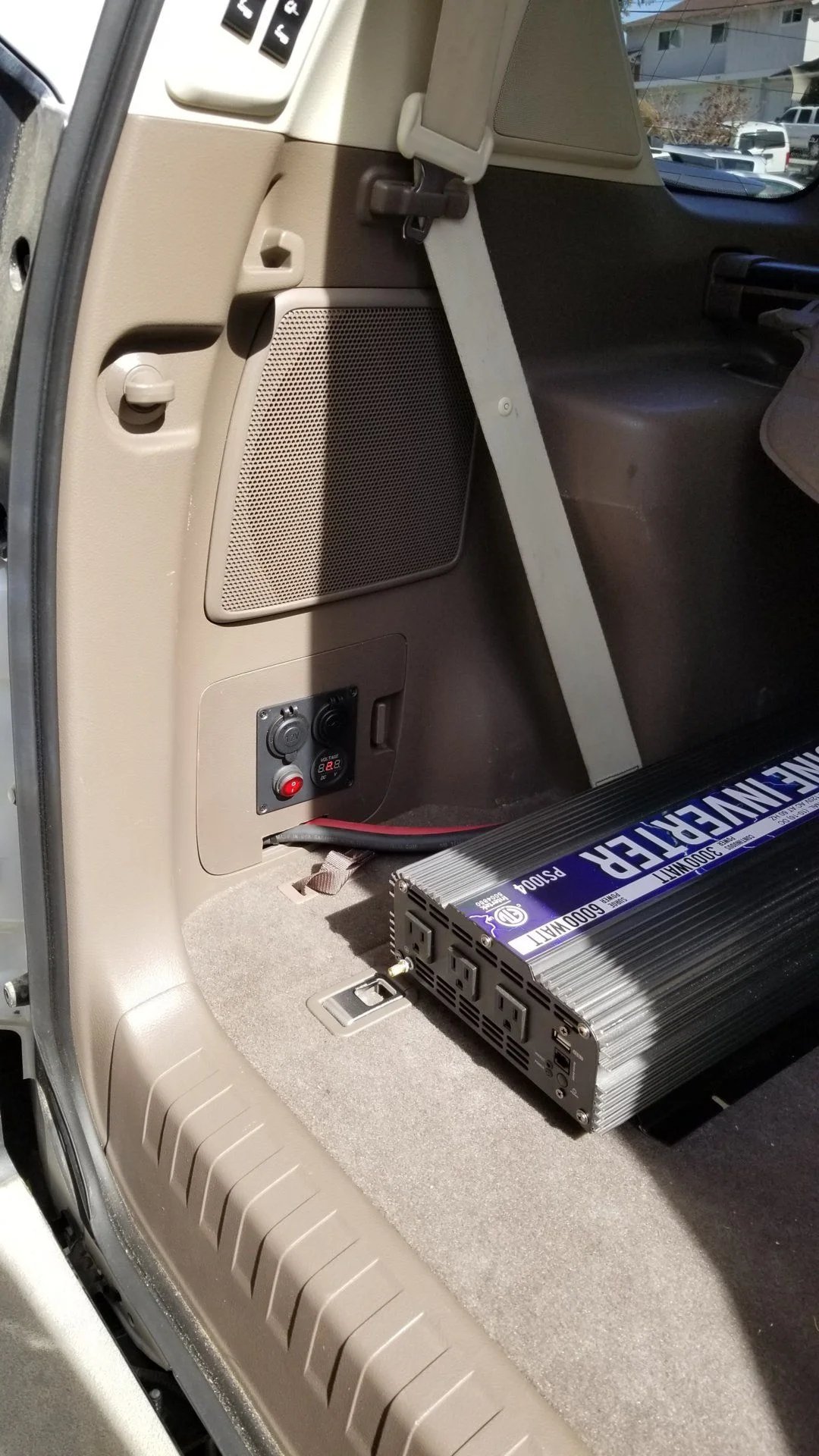

Kept the factory battery ground and ran the 1/0 AWG and all other grounds all the way back to the battery. The 1/0 AWG black and red run underneath and tucked up under the driver side rock slider, up and over the rear axle and then into the rear fold down seat area via a factory rubber plug grommet on the underside. I don't have a spare tire under there, so that grommet may be hidden by a spare tire. I then go up into the driver side cubby (where the jack is kept) and then to the 3,000 W inverter and accessories plugs..
I wanted to make sure it was a solid ground, even though 20 feet of 1/0 AWG black wire is a little expensive.
Thanks that’s helpful and wow what a run of giant cabling hah!
I needed that gauge for that 3k W inverter. I run our fridge and e-chainsaws off of that thing and they pull some juice.
