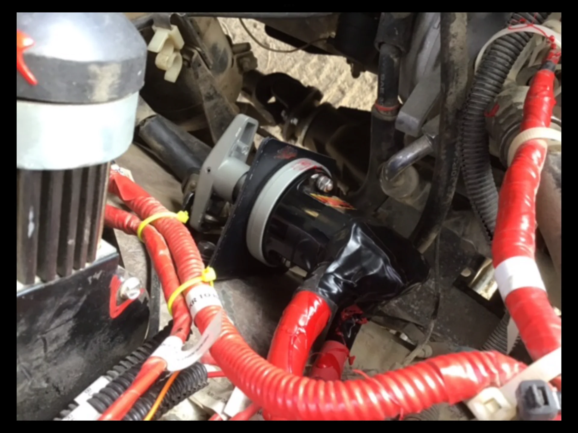

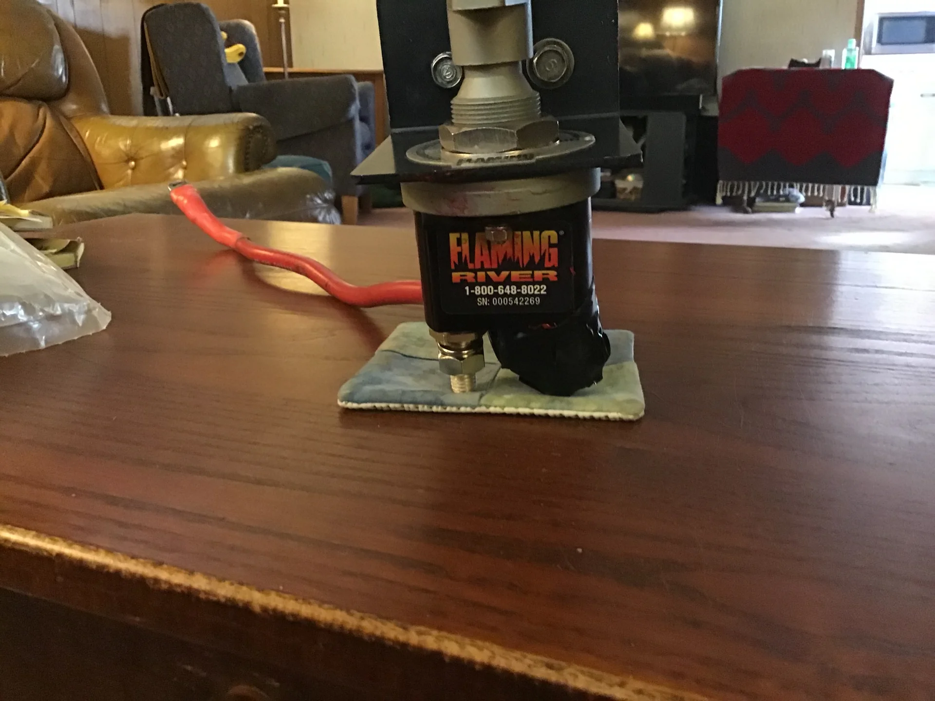

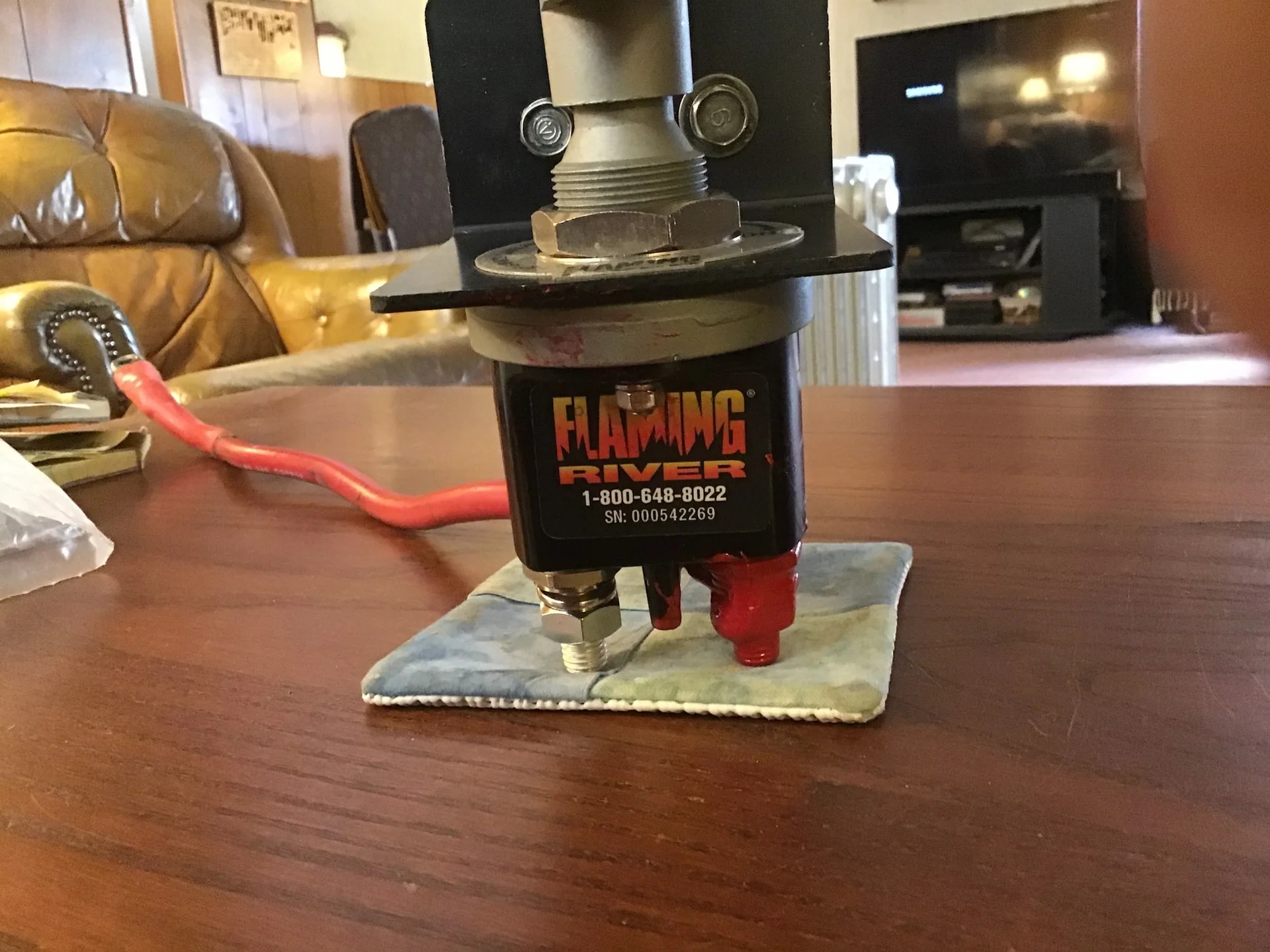

I also use the Flaming River Cut Off. Mine also has the ability to lock it on/off with a padlock.
