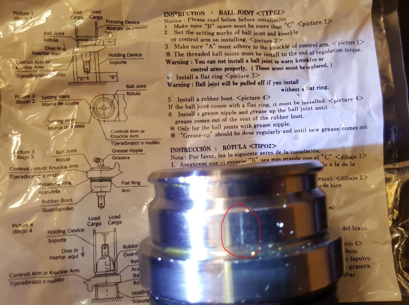

Received the 555 ball joint today; it says Made in Japan, whether believe it or not. On the boot removal (I understand it is pressed in situ without the boot) I do not see much grease. I'd prefer the grease rather being squeezed out during installation rather than a void left to be filled with water and dirt. What grease is suggested to coexist with what 555 put there?
Also, the included instruction says a mark on the joint 'must adhere to the knuckle'. It is barely seen and not exactly matching to their picture. I'd say there is slightly less-pronounced mark at the opposite side of the joint.
Anyone can shed a light on that?
Those that installed 555 upper ball joints.
Any issues or concerns with the oversized gap for the lock ring?
The factory ball joint has a much tighter tolerance vs these 555 joints.
