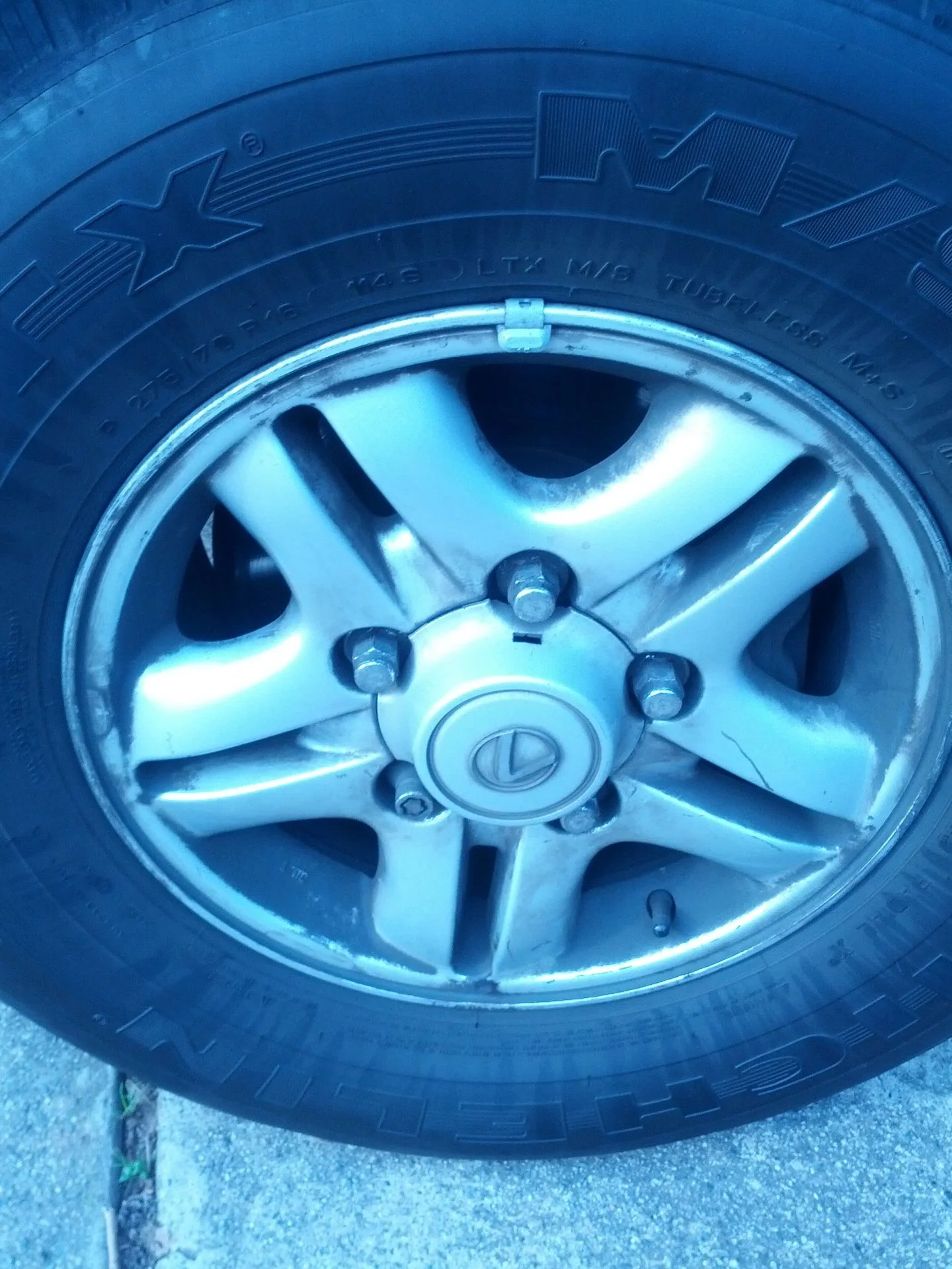

1998 LX that's probably had very little cleaning from new has done serious brake dust baked in. Some mild car wash, mild agitation and pressure washing didn't even dent it.
Can anyone recommend a product to use?
Its so bad I think they may need to be professionally refinished. I'm thinking I may plasti-dip them if I can't clean them.

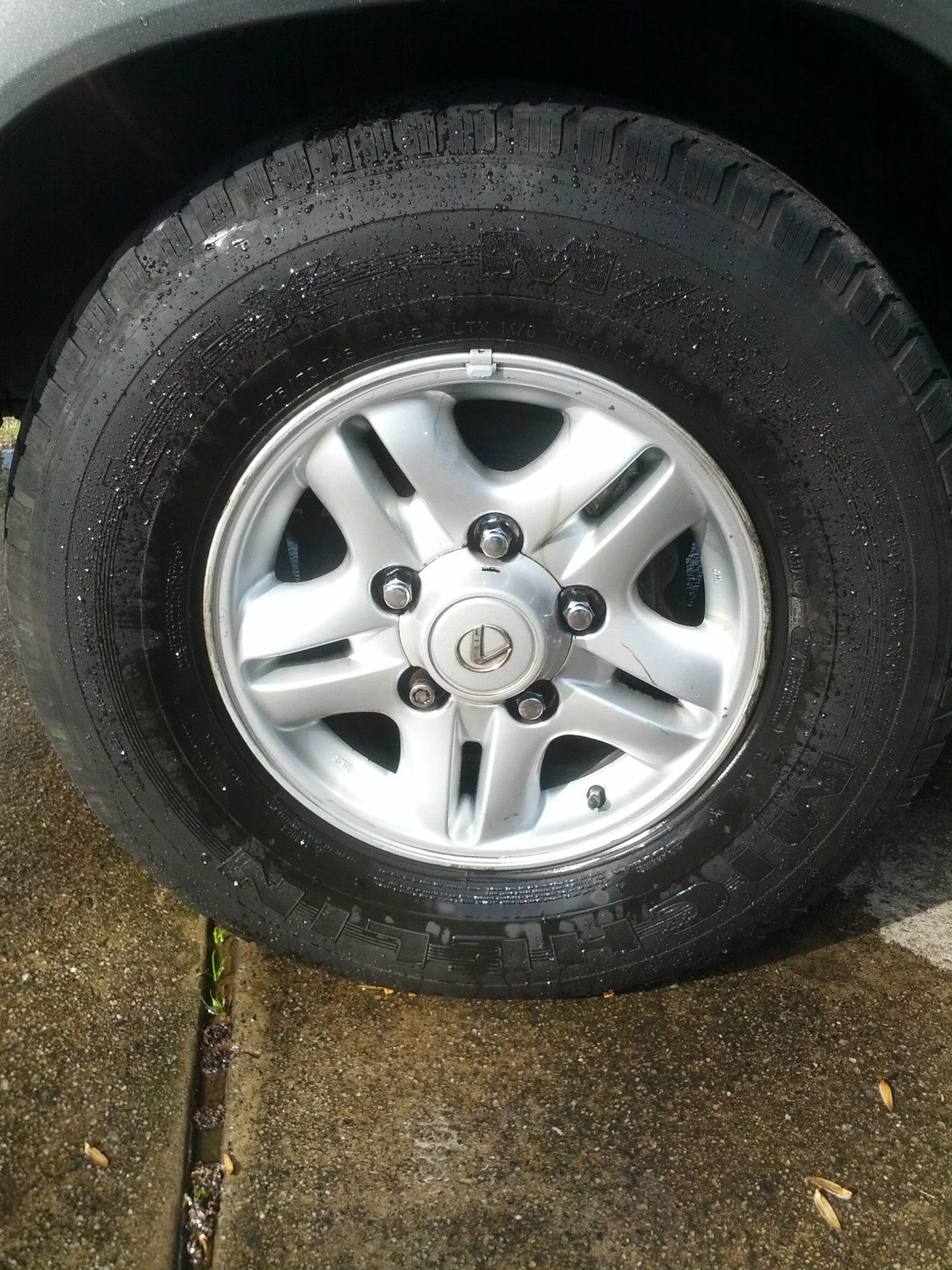

I am apprehensive about the unconventional cleaners and too impatient to order something, so I tried Dub.
I am pleasantly surprised (not by the smell, this stuff smells horrendously!). Three applications and aggressive agitation (I needed brushes, never had or let a wheel get this bad):
