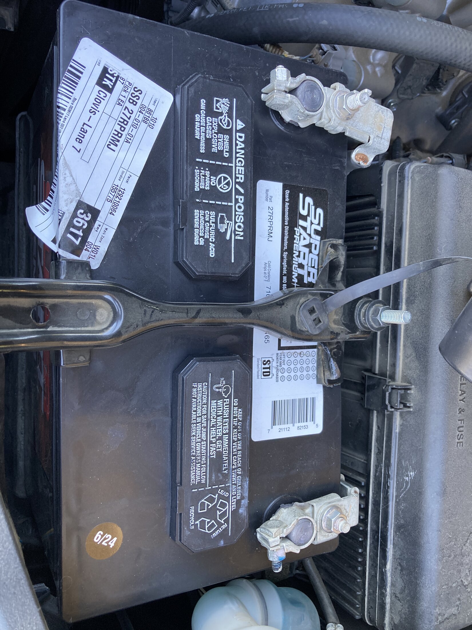

I believe I was sold a 27RPR battery. See picture.

After running around this afternoon, I think the problem may have been solved (fingers crossed). Stopped by the dealership and they couldn't test my battery at the time so we set up an appointment for tomorrow. The service guy said he believed it was a battery issue because starters usually work or they don't. Next stop AutoZone for a second opinion on the state of the battery. They tested it and said the battery was fine, alternator was fine and the starter was faulty. The kid at AutoZone said it was due to having a push button starter - they just go out faster than a keyed ignition (hmm?). After running my kids around I went to the original place of purchase - O'Rileys. They also tested the battery and instantly said, the battery is bad, it has a charge but wasn't strong enough to work properly. The kid at O'Riley said he'd never seen this before and had no problems warrantying it. Swapped in a new battery, the LC started right up like normal. It ran like normal with no stuttered starts later on. Hopefully the new battery swap will do the trick.
