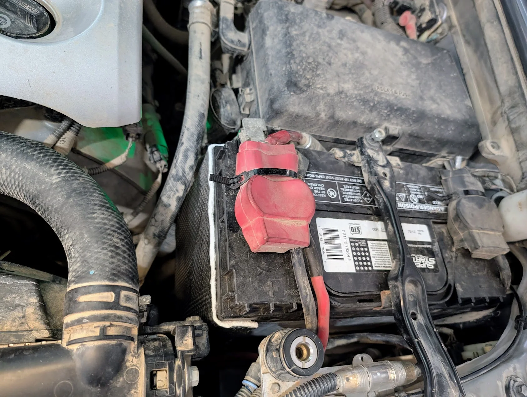

Interesting thing I've noticed a couple times now. I have a larger Group 31 starting battery. Old habit of watering lead acid batteries from my camper. I've noticed consistently that the water level on the cell closest to the motor is lower than the other cells.
For normal commuting, this is probably not a significant factor. As I do offroad crawl and camp a lot more than most, in the southwest desert, engine bay temps can really spike, over 160° F (EDIT - can see over 200° F) these use cases. I'm wondering if the relatively higher heat exposure on the side of the battery closest to the radiator and motor can be a factor in the overall life of the battery. I'm beginning to think so.
Since I've been insulating the fuel system to keep fuel boiling at bay, I have insulating wrap on hand. Can't hurt to put some insulation on that side. Easy as cutting a 7" x 9" self sticking piece and stuck it on.

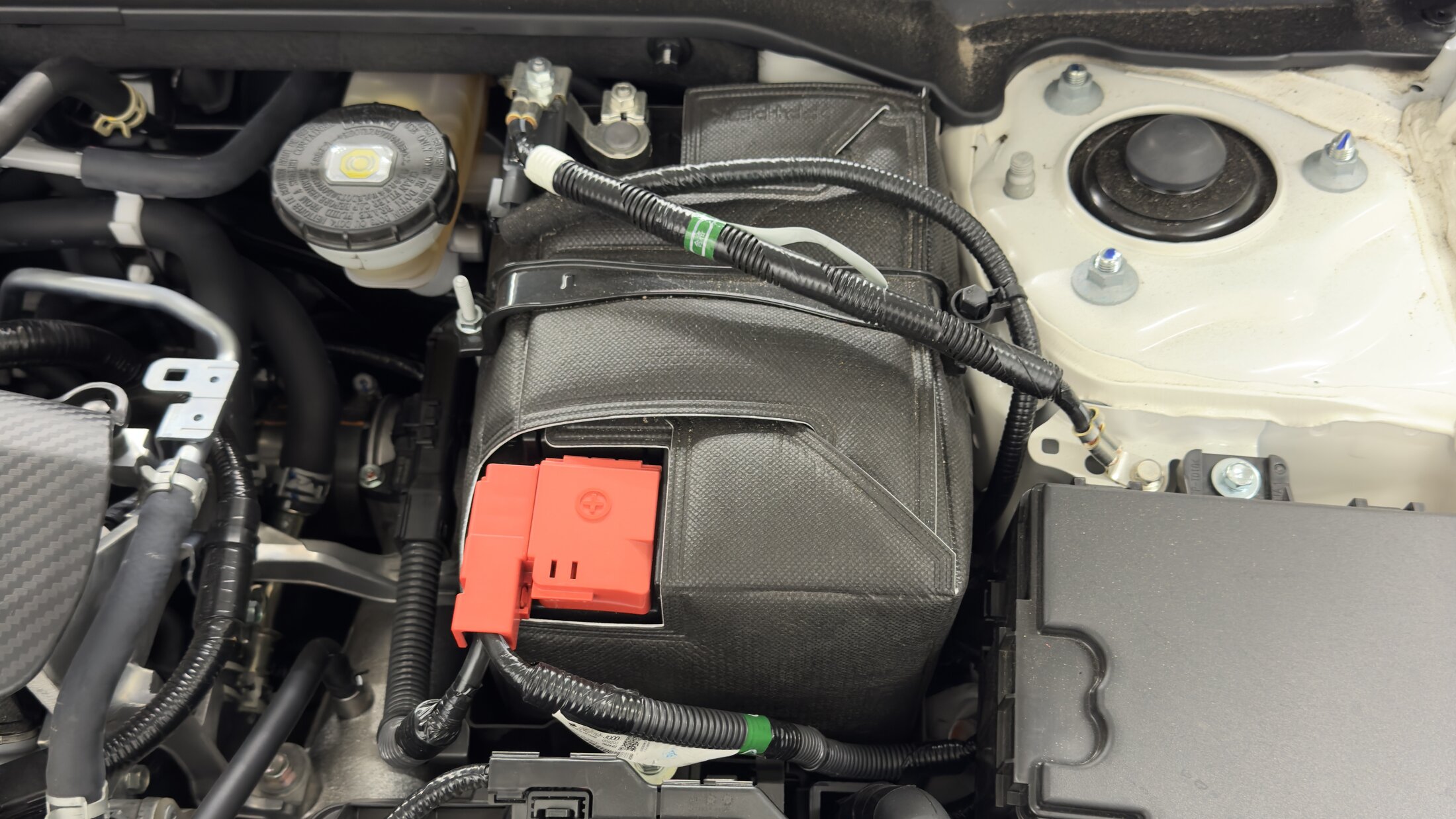

If it helps, this is what Honda now does on the Type R. I thought it was neat when I first popped the hood.
Do you know if there is a aluminum layer in there? Black otherwise does not seem the ideal color to reflect radiation heat.
Hard to say, but it's black on both sides. There's a decent amount of insulation in it though. I'm guessing they are less concerned with radiant heat and it's more about convection with all the hot air in the engine bay.
VW has been doing this for a long time, no foil layer but something like a fiberglass mat. And as I understand it engine bay temps are part of why many other european cars put the battery in the trunk.. but also weight distribution and engine bay packaging.

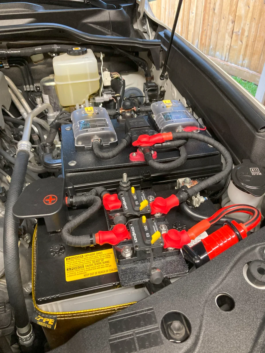

Speaking of aluminum shields, @gluaisrothai did some fine work making a high end heat shield solution for a lithium battery
