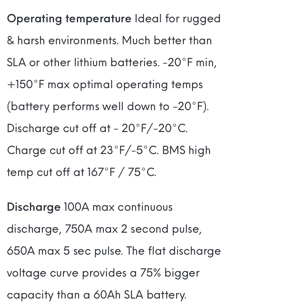

Ya I hear those points. The dakota lithiums put out 1000 CCA and have advertised operating temps that are equal to sla/agm. You guys don't trust those?
Not 100% duty cycle high current battery. And under hood temps can exceed the 167.

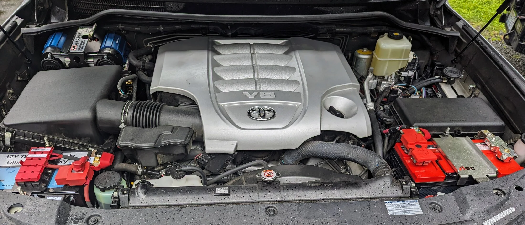

I have had a Dakota Dual DL+ 135Ah Battery on order since September; they were having production issues and hope it ships out in January. I plan to install as a second battery for deep cycle loads (fridge, lights, etc) and as an emergency backup for starting. Similar setup as @gluaisrothai
What have you done to your 200 Series this week? - https://forum.ih8mud.com/threads/what-have-you-done-to-your-200-series-this-week.818471/post-15443181. Will have the RedArc 25A DC-DC charger and a high amp solenoid for momentary connection to the main start FLA battery for emergency backup and boost power if I install a winch.
I am very impressed with the specs on the Dakota battery, but I would not give up my reliable FLA battery for starting and do question if the Dakota would survive reliably starting our big 5.7l engines if used as the main start battery.
I have had a Dakota Dual DL+ 135Ah Battery on order since September; they were having production issues and hope it ships out in January. I plan to install as a second battery for deep cycle loads and an emergency backup for starting. Similar setup as gluaisrothai - https://forum.ih8mud.com/members/gluaisrothai.180031/

The Dakota 135ah has internal heating to support charging below 32F. I was more concerned with excess heat during slow summer crawls so I made an active cooling system.
Function and capacity have been excellent. I run a fridge pretty much all the time and Starlink a lot of the time…topped up with the 25A DCDC and 200W of roof solar.

Have a 75Ah in the 200 and a 180Ah from them in our trailer. Carl is great to deal with.
A 75Ah lipo battery is like having a 150Ah AGM/FLA battery given its usable capacity profile. The size/weight/capacity tradeoffs made the price tag livable for me.
