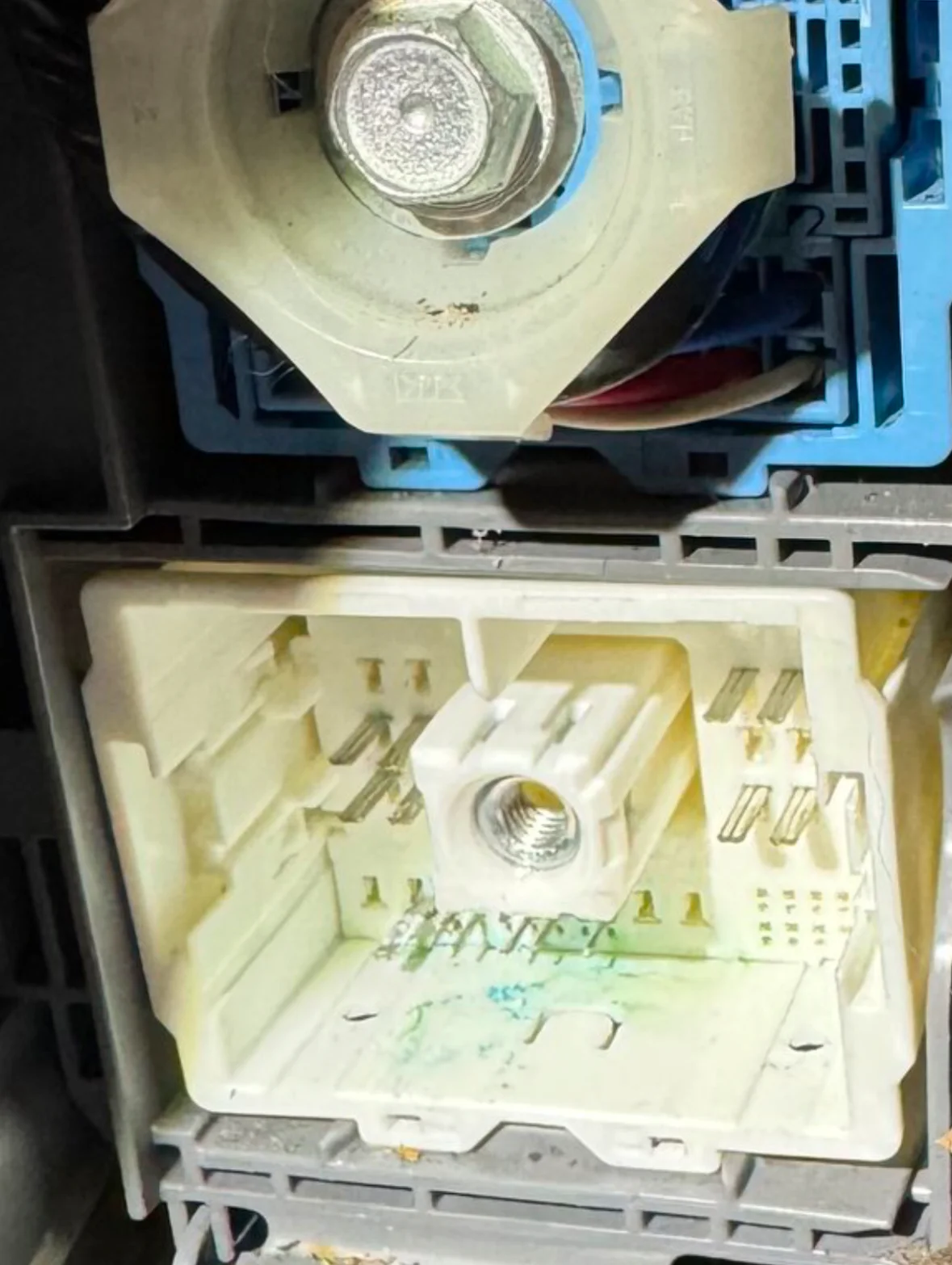

I have been chasing an electrical gremlin as well. 2009 LX with 190k miles. This issue occurred several times during a 1400-mile round trip over Thanksgiving. Right after my wife said, “we haven’t had any problems with this vehicle.” Haha
Here’s a 0:13 video. This happened to us multiple times during our trip. The headlights would brighten up as the voltage surged, and all of them ended up burning out. No high or low beams or DRLs. Radio volume would disappear but would come back when the LX was started again.
Notice voltage rising to ~17V. Every single time was within hours of precipitation or a car wash. My first thought was water ingress.
With my uncle’s limited tools, I tore the LX apart in his garage—door sill panels, kick panels, removed the wipers and the cowl—and I found no moisture whatsoever. I ran warm water and about 18” of trimmer line through both sunroof drains. Drivers side drain was slow to drain at first. It appeared to be at least partially blocked. And like you, I found some corrosion in the bottom multi-connector on the drivers side, but no moisture anywhere.
The voltage issue happened again multiple times after cleaning the sunroof drains on our way back to Tennessee.
Once we got home, I removed sill, kick, and dash panels once again and could not find any moisture. I opened up all 6 multi-connectors held by a 10mm bolt and cleaned them out with Deoxit anyway (recall that the one had some corrosion on it). While letting them dry, I went and bought a single headlight bulb at an auto parts store. Came back and put it in on the passenger side, buttoned up the kick panel wiring, reconnected the battery, and the headlight WORKS.
What in the world! So I go back and buy the other three headlights. They all work! While removing the battery to install the drivers side bulbs, I notice a lot of corrosion buildup on the battery tie down strap. I clean all of that off the top of the battery and the terminals, reinstall the battery, and now for the life of me I cannot recreate the problem.
I was planning on replacing the alternator, but I’m going to start with the battery and give the terminal ends (especially where they have that bend in them) a good inspection.
TL; DR: my voltage randomly spiked to 17V, burning my headlights out. I cleaned a bunch of kick panel connectors, cleaned the battery with a bunch of corrosion on top under the strap, bought new headlight bulbs, and I can’t recreate the problem. No codes, no other symptoms. I’m watching the voltage meter, and it stays at ~13.8-14V all the time.
@LX Cruiser glad you got it sorted it out. Spending time troubleshooting on a trip is not fun. Happy it wasn’t the alternator.
