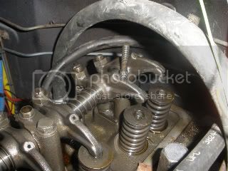

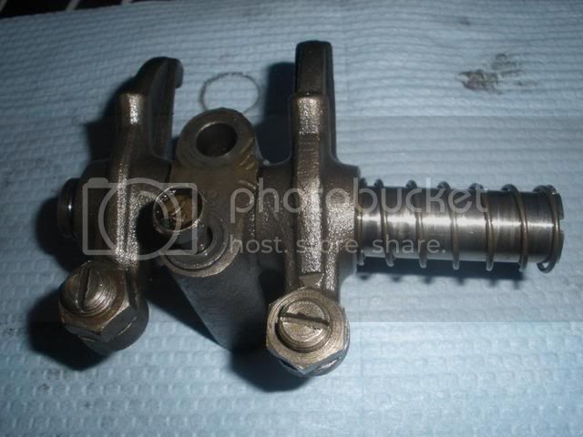

Following Marks advice, I took vacuum and compression numbers and was getting the feeler gauges ready to adjust the valve train. I popped off the valve cover and found, much to my dismay, that the #6 intake and exhaust rocker arms extremely loose. The reason they were loose is that the rocker arm shaft pedestal and rocker arm shaft were broken in two! I was effectively running on 5 cylinders!
I have a few decisions to make regarding this situation. Do I fix this F motor's valve train, go with the SBC conversion route, or say screw it and get a Prius?
Thanks again folks! You guys as usual are a great source of info!
Some broken cruiser porn for you!
