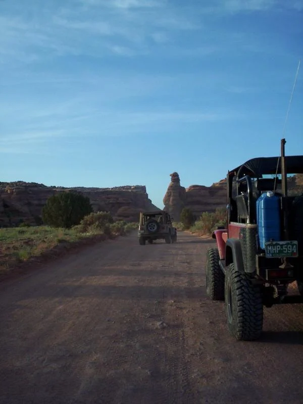

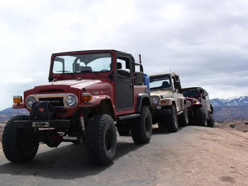

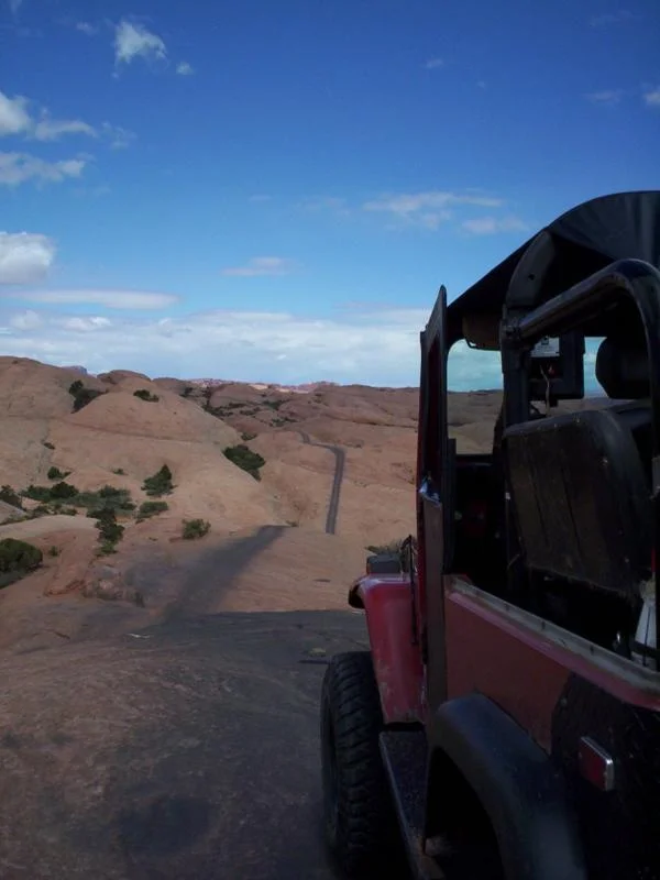

Hi All:
I'm using a set of plain white "wagon wheels" that have 3.75 inch backspacing. On the rear axle I'm running a pair of 1.5 inch MarlinCrawler bolt-on wheel spacers. These spacers help provide enough clearance for the rear wheel travel of the OME 60 Series leaf springs my rig is running (the tires still rub the body tub just a little bit.)
