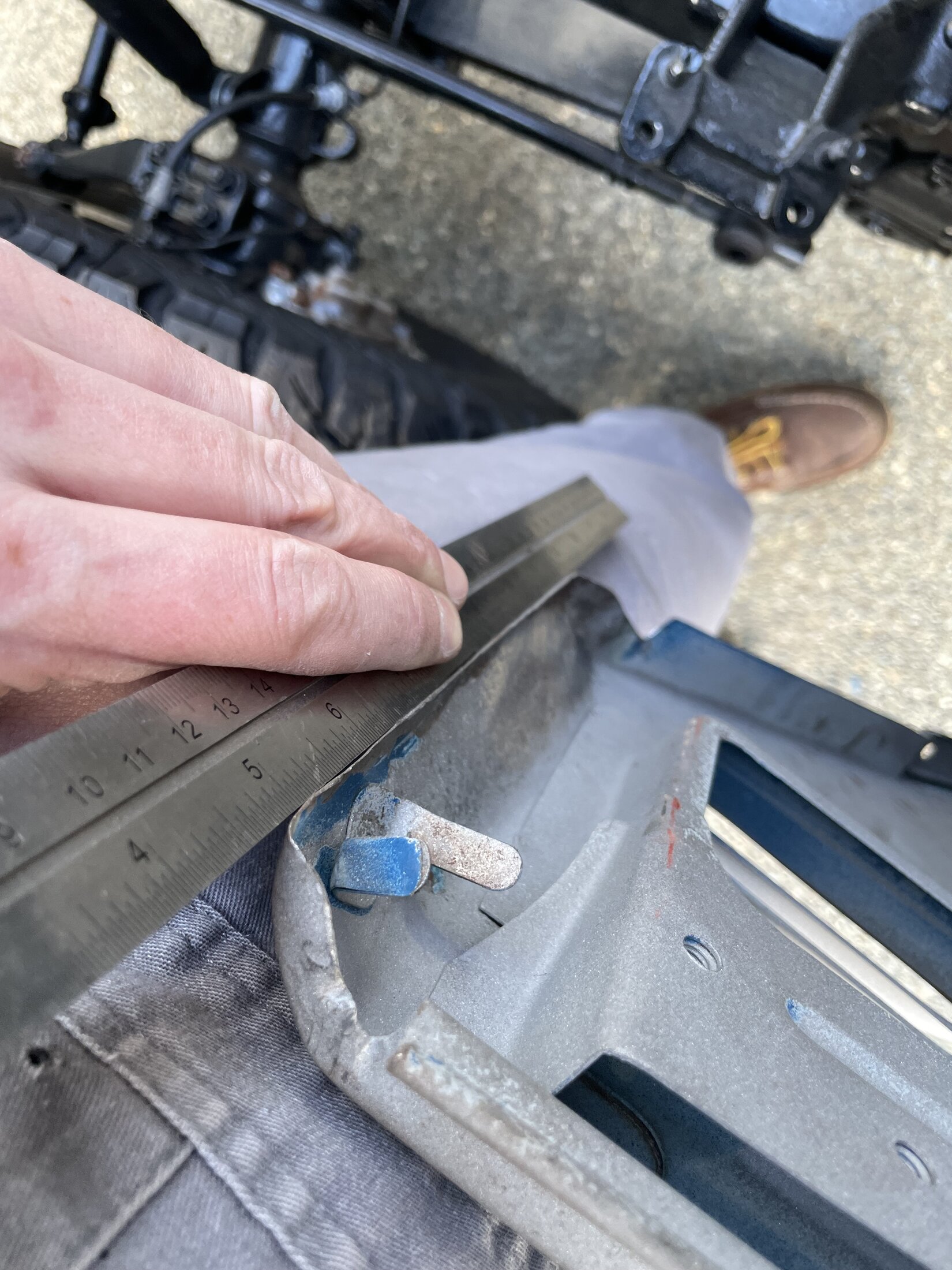

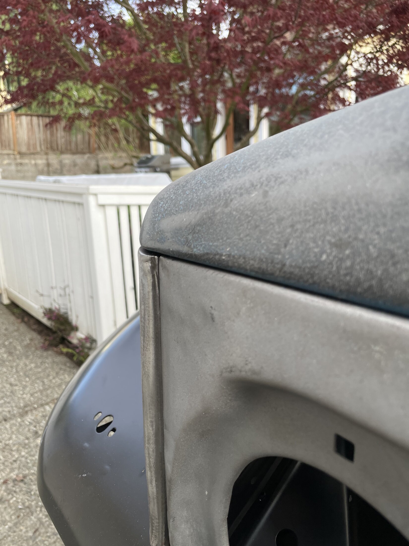

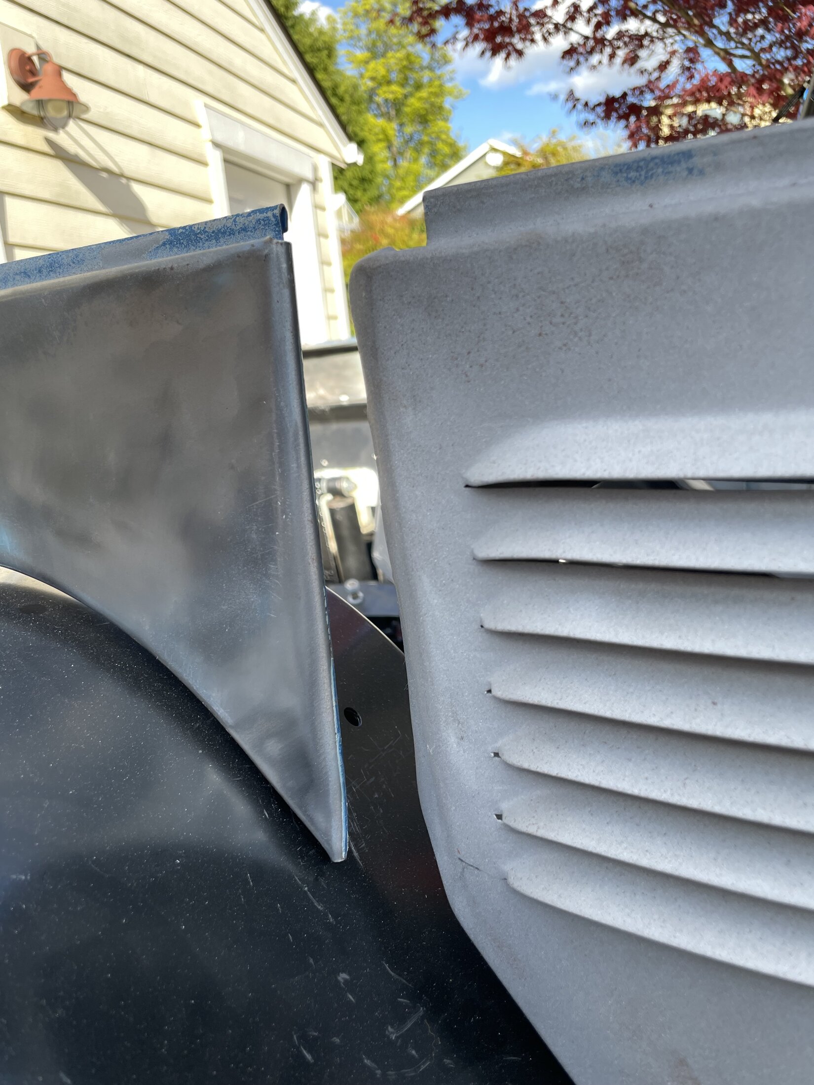

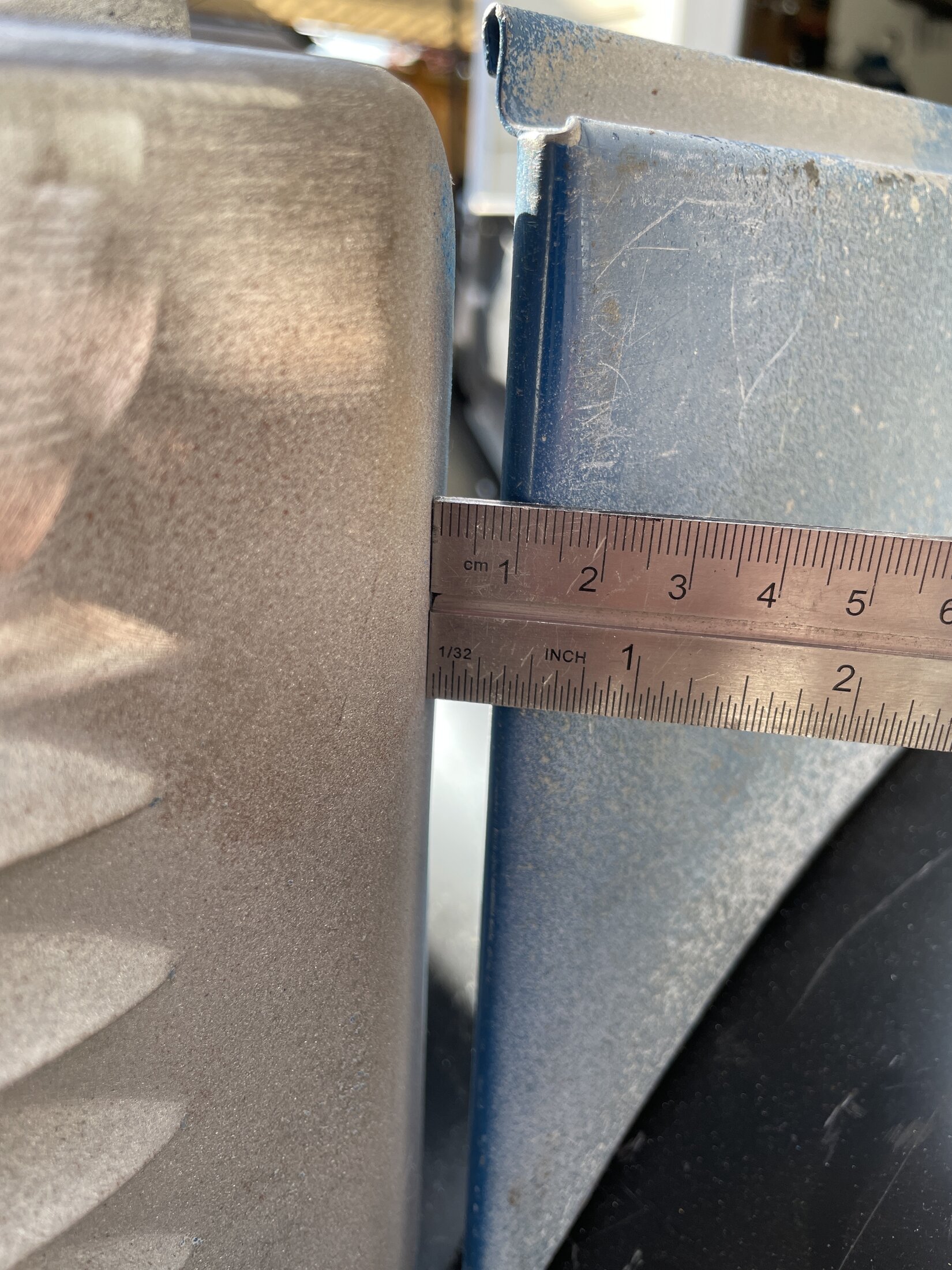

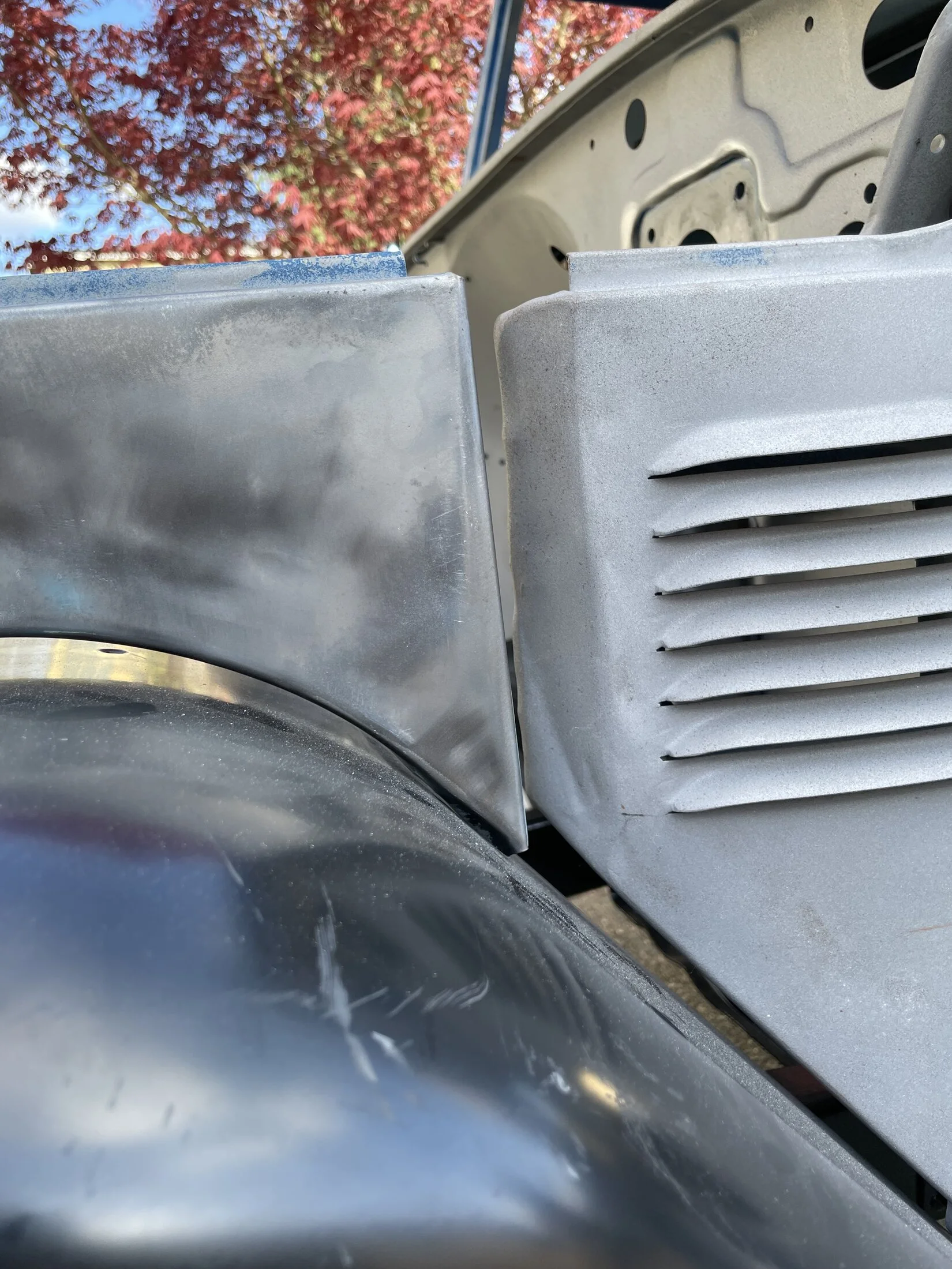

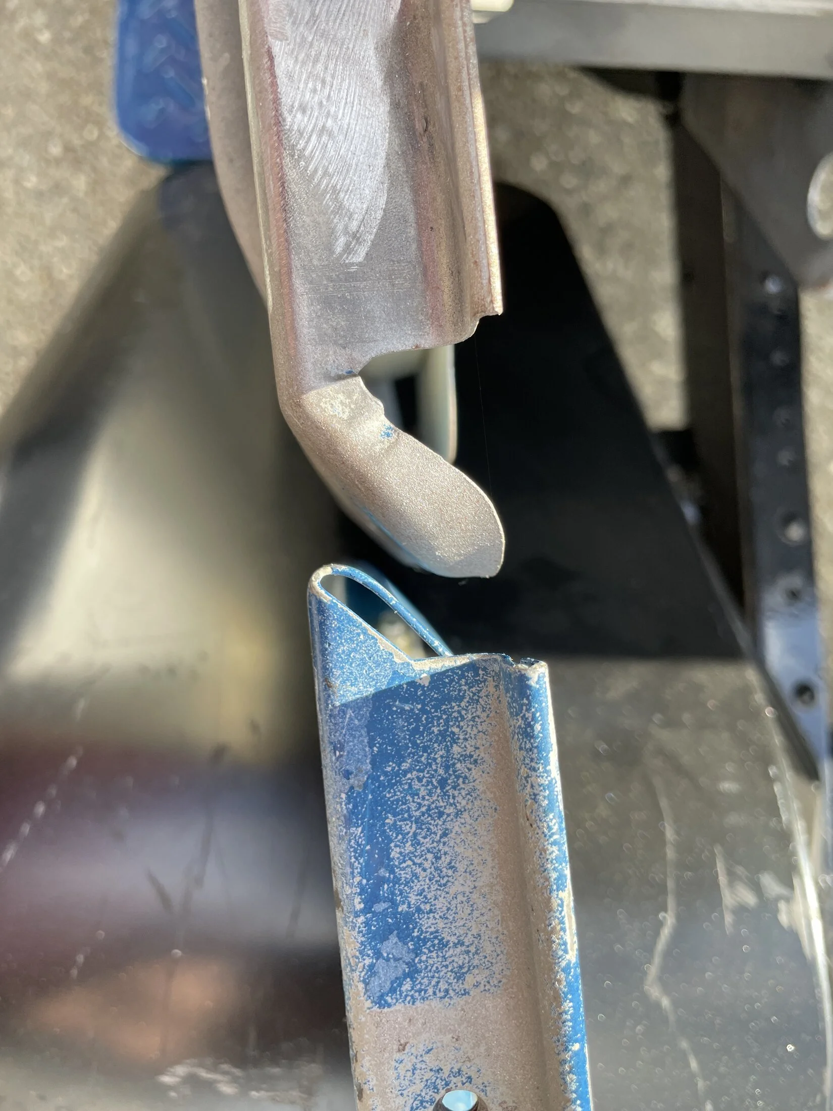

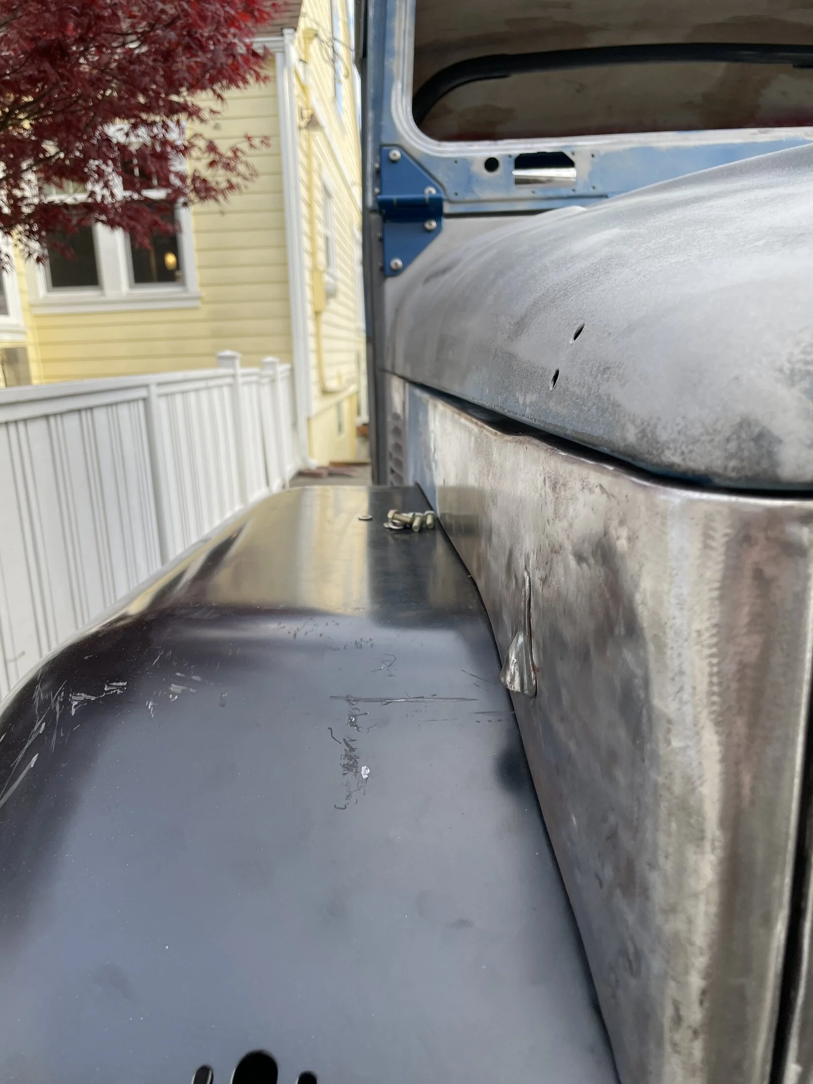

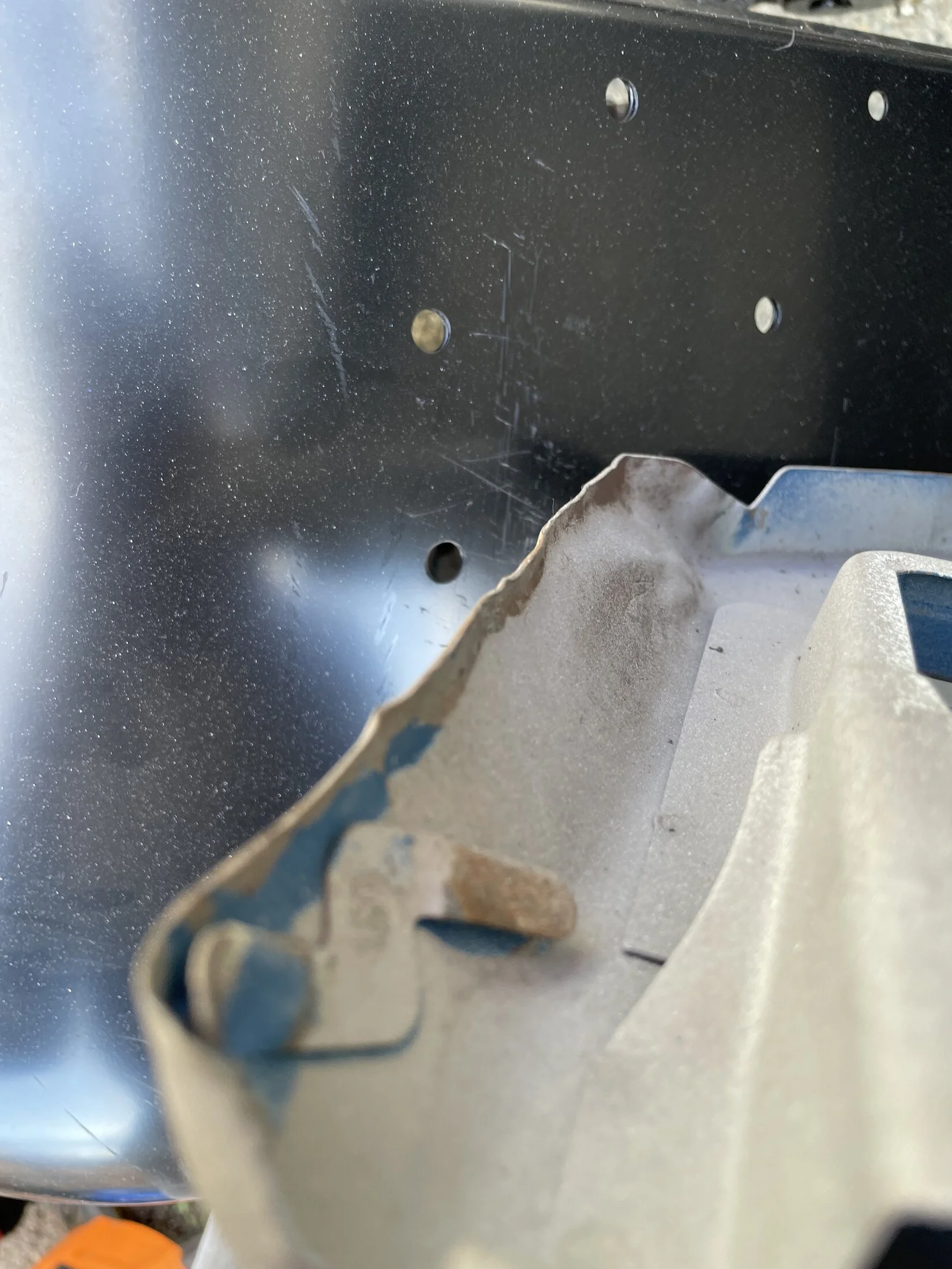

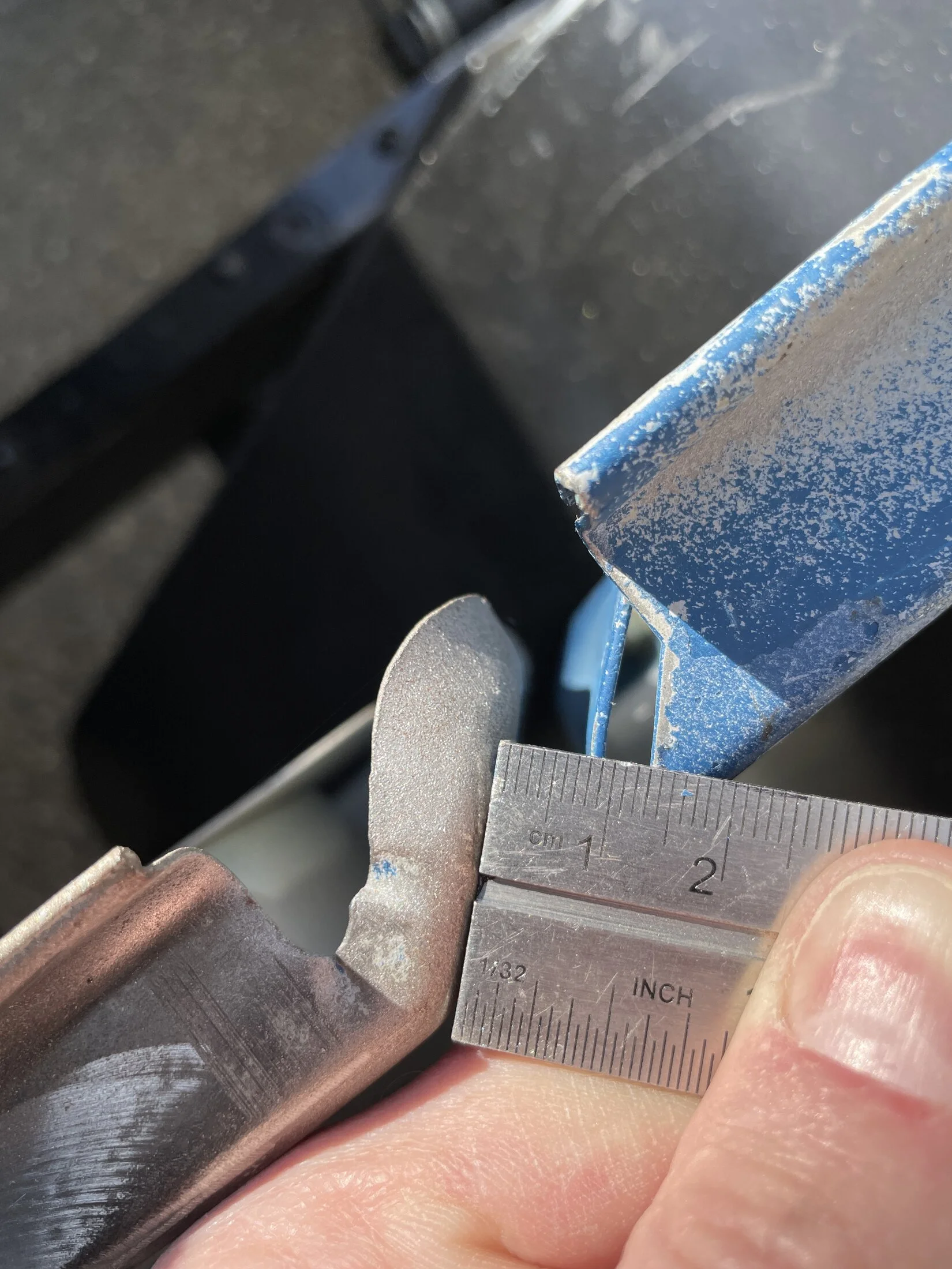

Anyone able to help give me some pics or quick measurements for how much space there should be here? The drivers side is hammered dog S, and I want an accurate representative of what it ‘should’ be. 1981

You gotta get the aprons to fit the fender 1st. Keep in mind there's a rubber strip that attaches on the end of the aprons thar help fill that gap..
To get things lined up, I found starting with hood and bib 1st. Check out this thread,

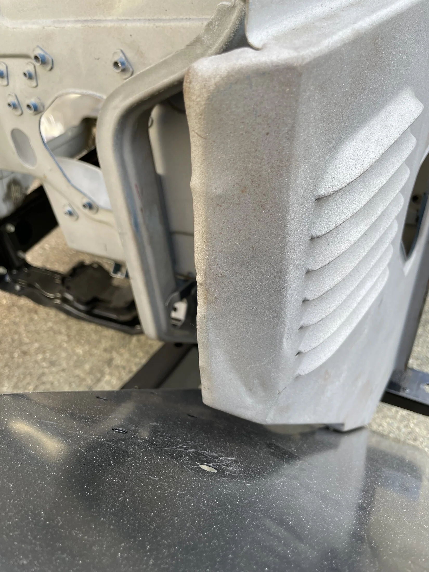

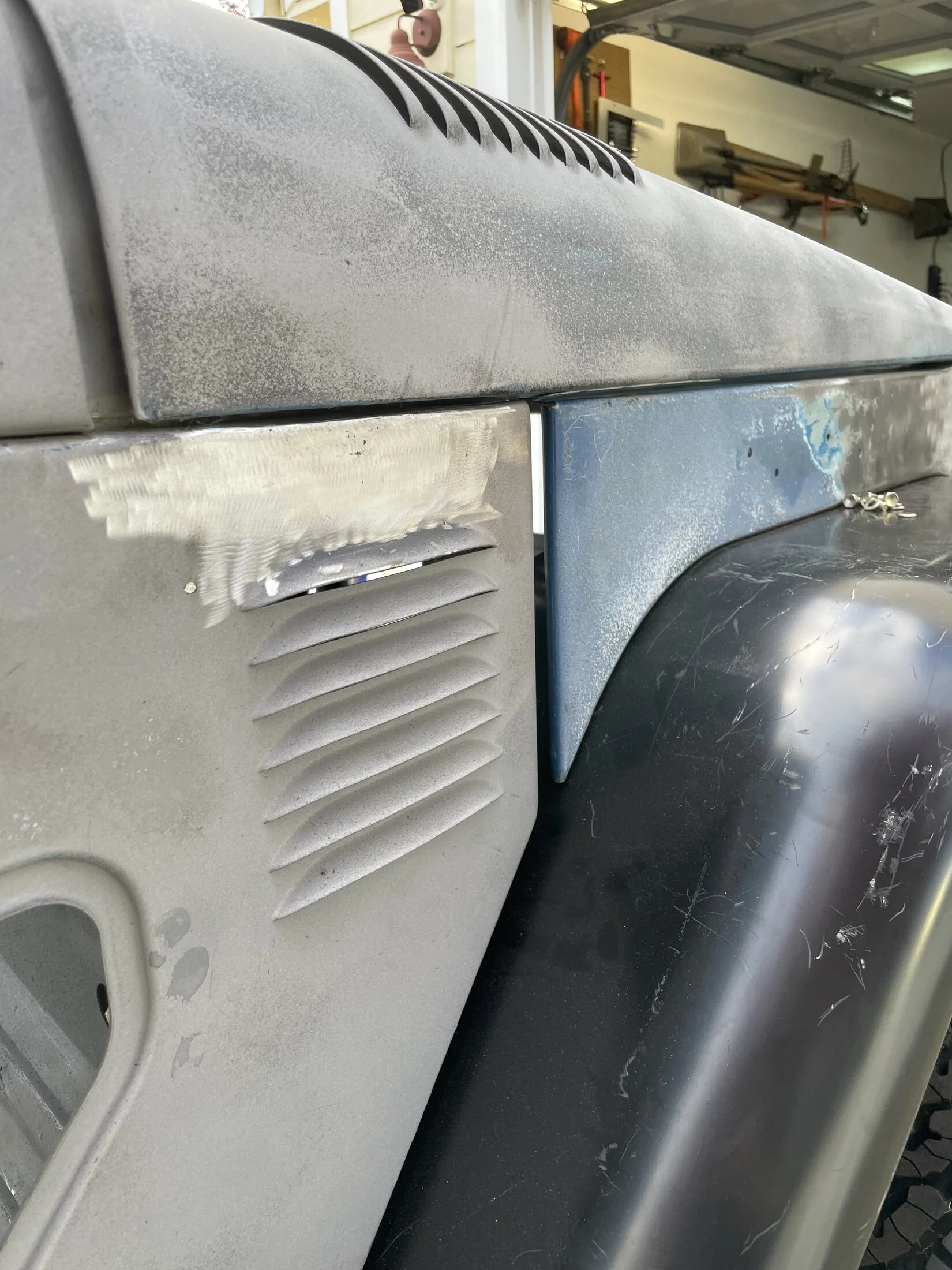

Cheers for recommending the hood. The passenger side had massive overhang when I bought it but it also had a bent frame back then so… who knows.
First time I’ve had the hood on it in almost 2 years. Lines up well on the passenger, I’ve hammered out the smashed part of the tub on the drivers side and it’s looking decent. Suppose I should just aim for even on both sides vs going for a specific measurement?
