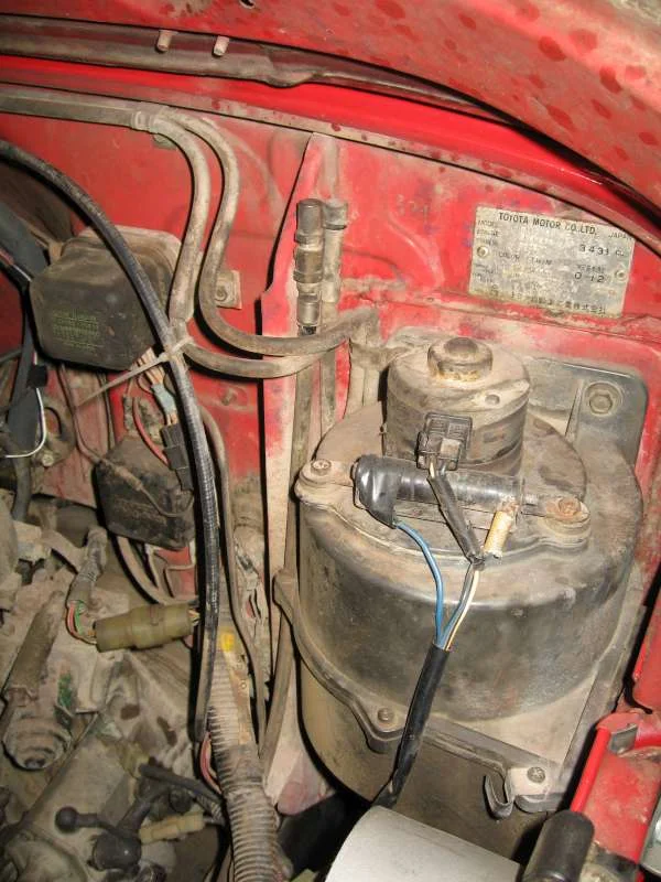

Well, in retrospect, I think I'm full of s*** :D. Mine are there, but looking closer they don't looks as stock as I remember them, and I can't find anything in the EPC about such lines. In any case, see them below. A long vacuum line runs inside the frame rail to the rear axle, while the front line snakes through the motor mount (where it has a thick anti-rub sleeve) to the front axle.
Its odd, because I think this setup is functional and fairly clean... which would be totally out of character for the PO.

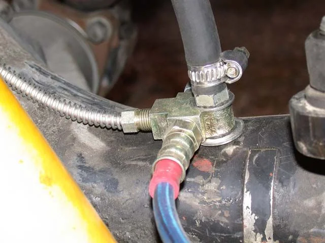

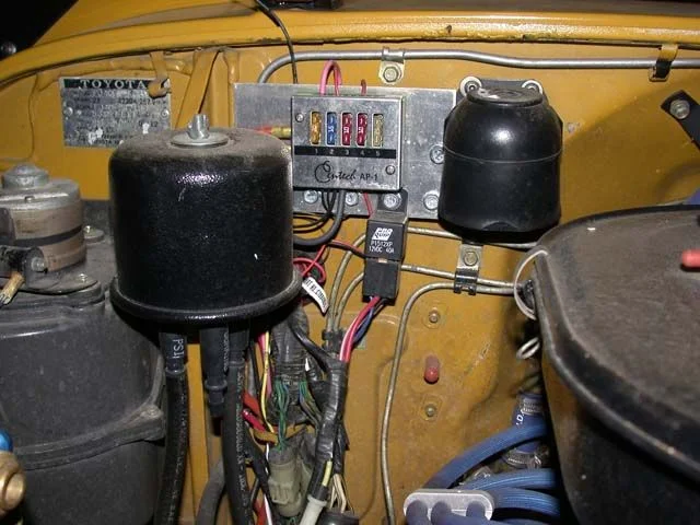

Don't have a lot of photos but here is the rear. The line is fed into the frame and connected to the K&N filter under the hood. I don't have a photo of the front axle but can take one if you need to see it.

just to make sure, the k&n filter is the black bell shaped thing on the left with the wing nut holding it down and the lines running down (right ?) and do you have a part number because i haven't seen that one before. or i guess i can go to Google and see what i find.
thanks!
thanks!
That would be yes to your first question. I went to the K&N website and could not find the housing. They may have discontinued it. I installed it at least 5 years ago.
