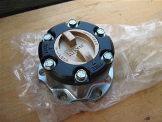

I wouldn't want the cost or labor of installing the part time kit. I was just wondering it running AVM selectable hubs upfront instead of machined drive flanges would allow you to just flip a switch in the event of a front diff, axle or CV breakdown.
You would still need to disconnect the front drive shaft.

I believe AVM offers a standard hub and an HD hub. Get the HD hub. Or better yet, see if the Aisin Hubs from a 105 work! Added bonus, the selectable hubs look a whole lot better than the bulbous dust cap that is there now.
