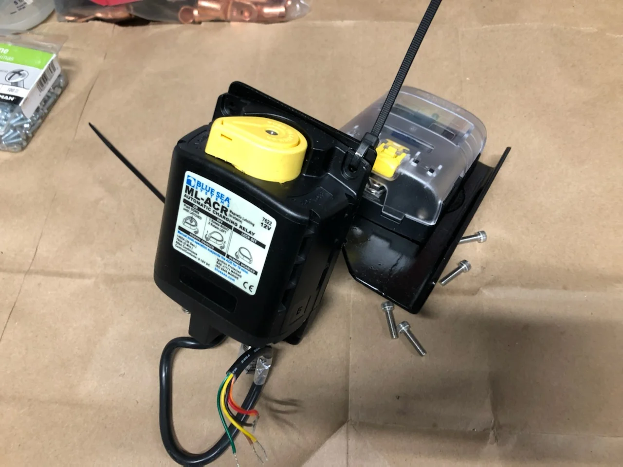

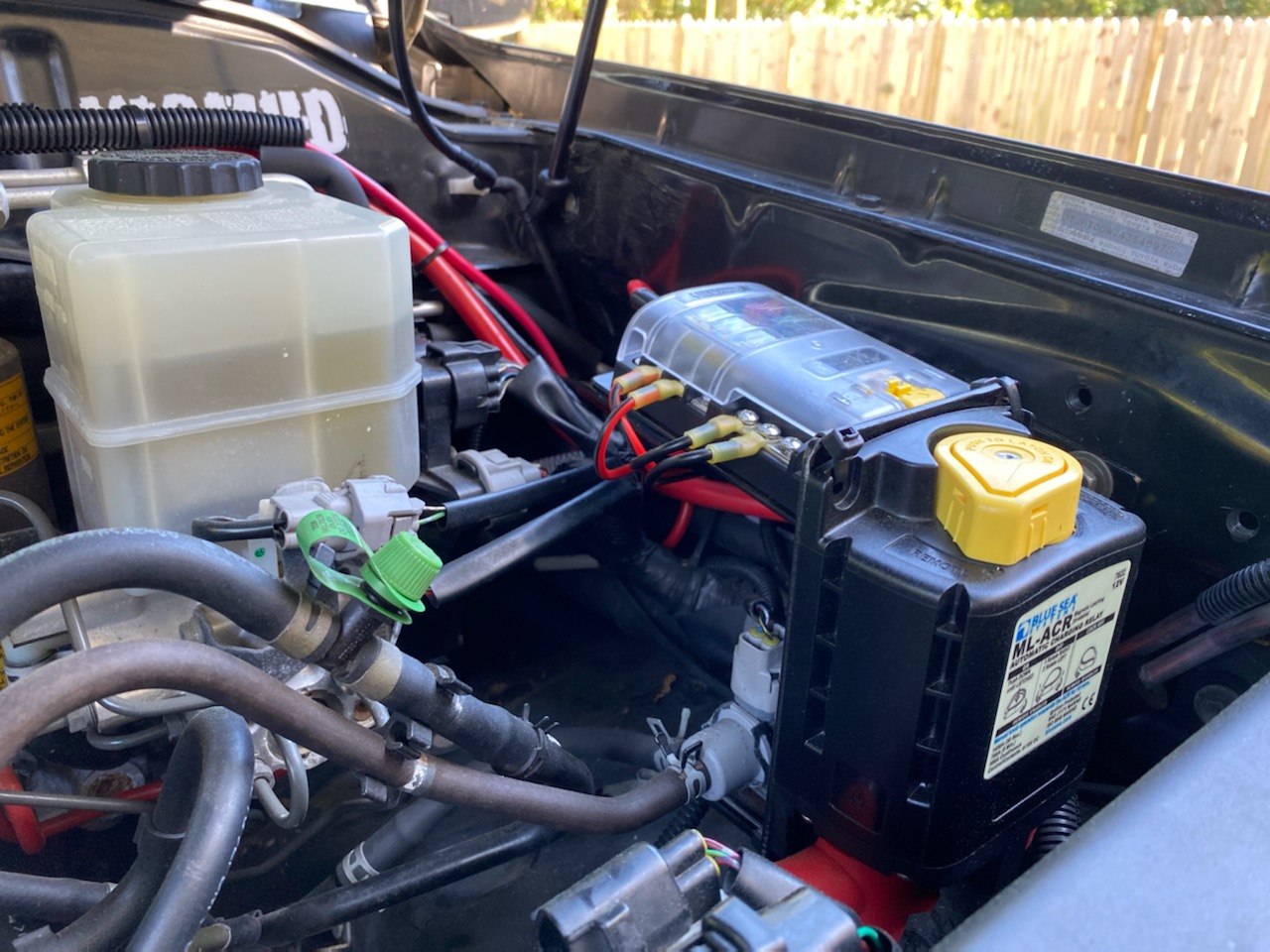

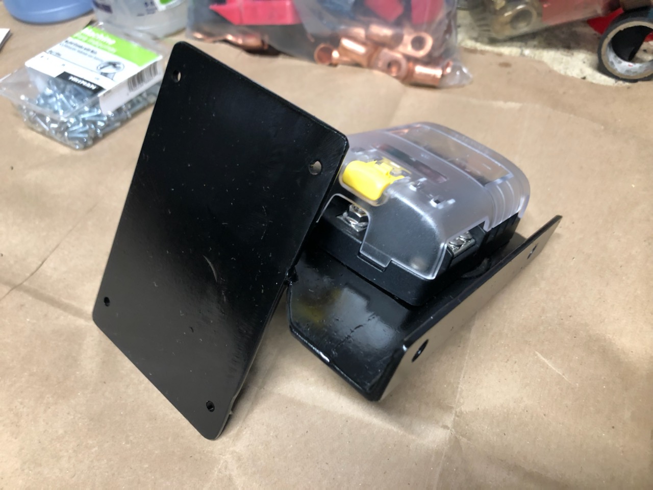

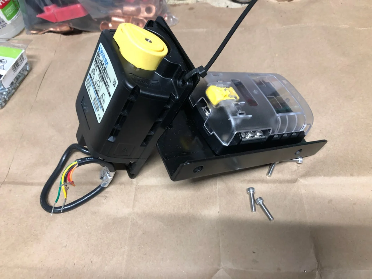

i made this one for my Blue Sea ML-ACR and switchanel

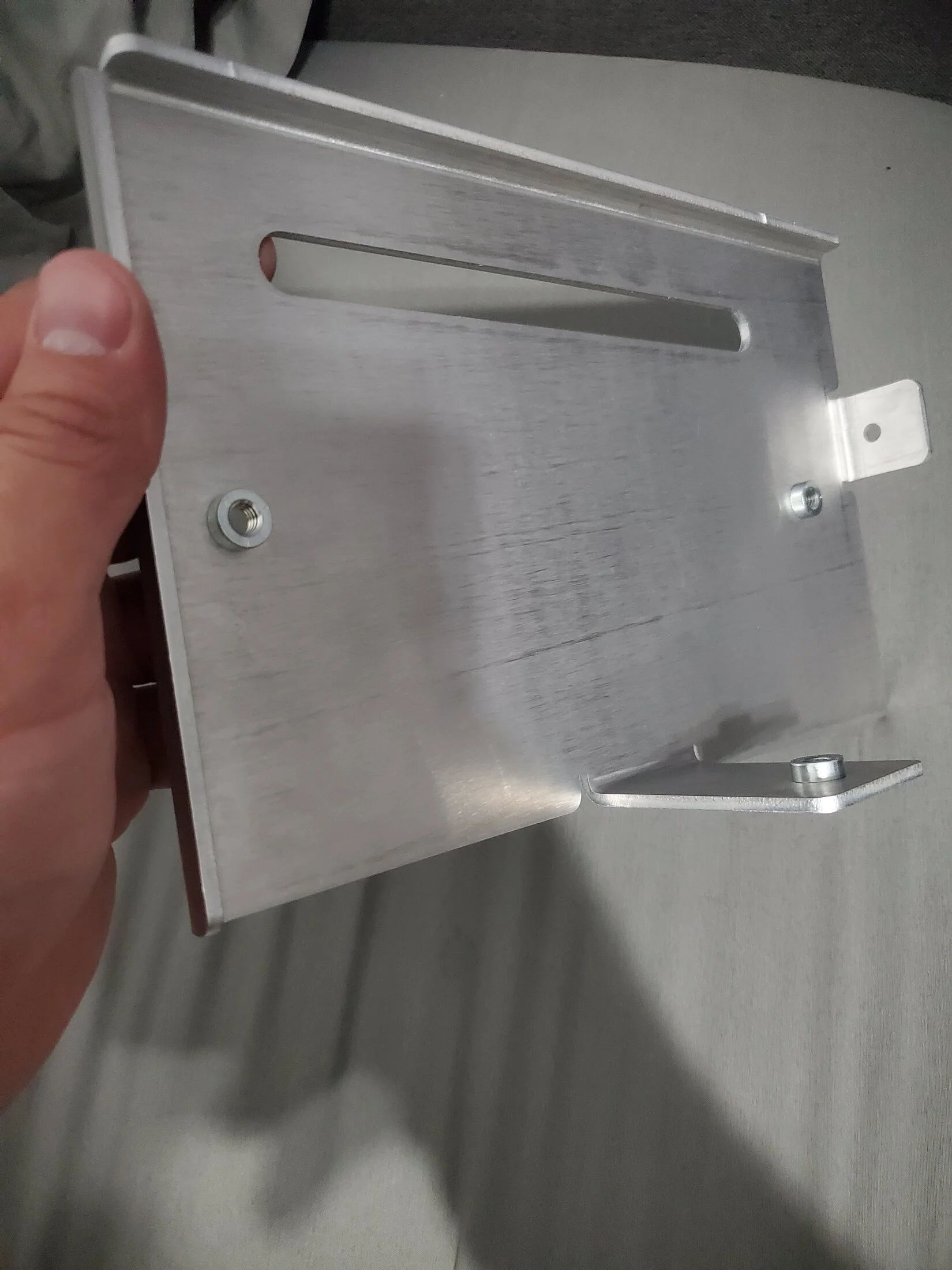

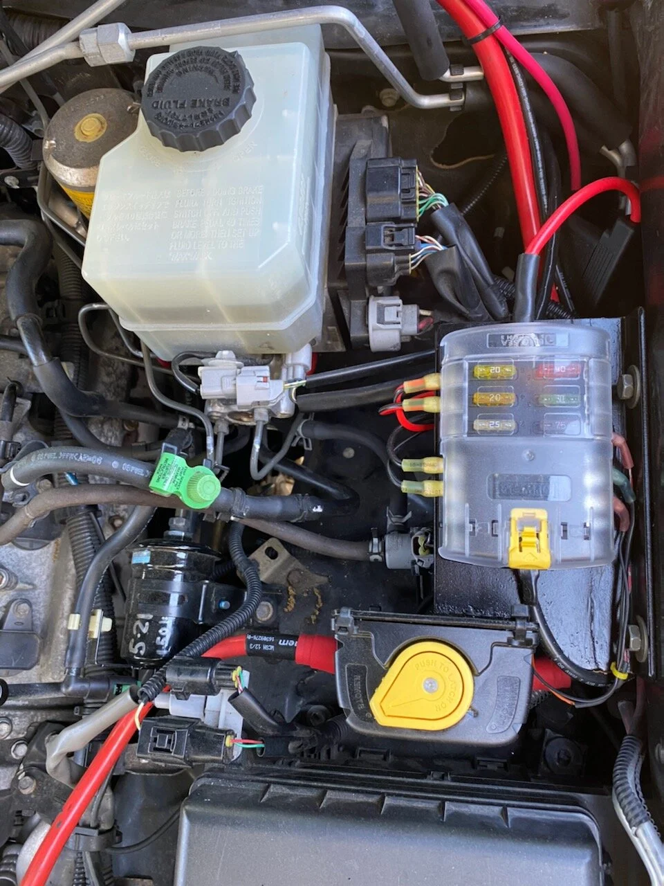

I made a custom bracket for my auxbeam so it can take the place of the second battery on the slee compressor/2nd battery tray also leaves room below it for buss bars and the breaker.
This picture isn't the 100% finish product as I made a few changes but same same but different

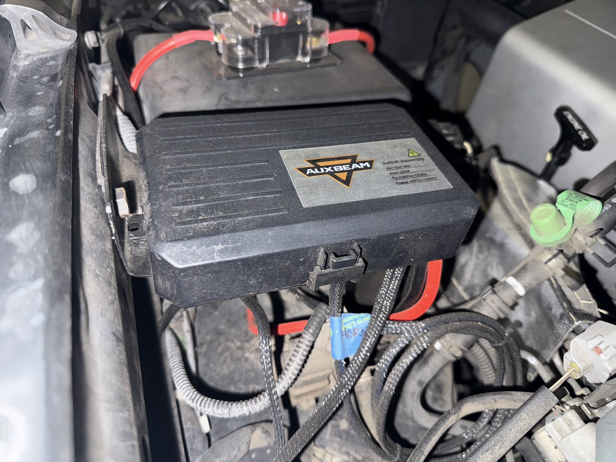

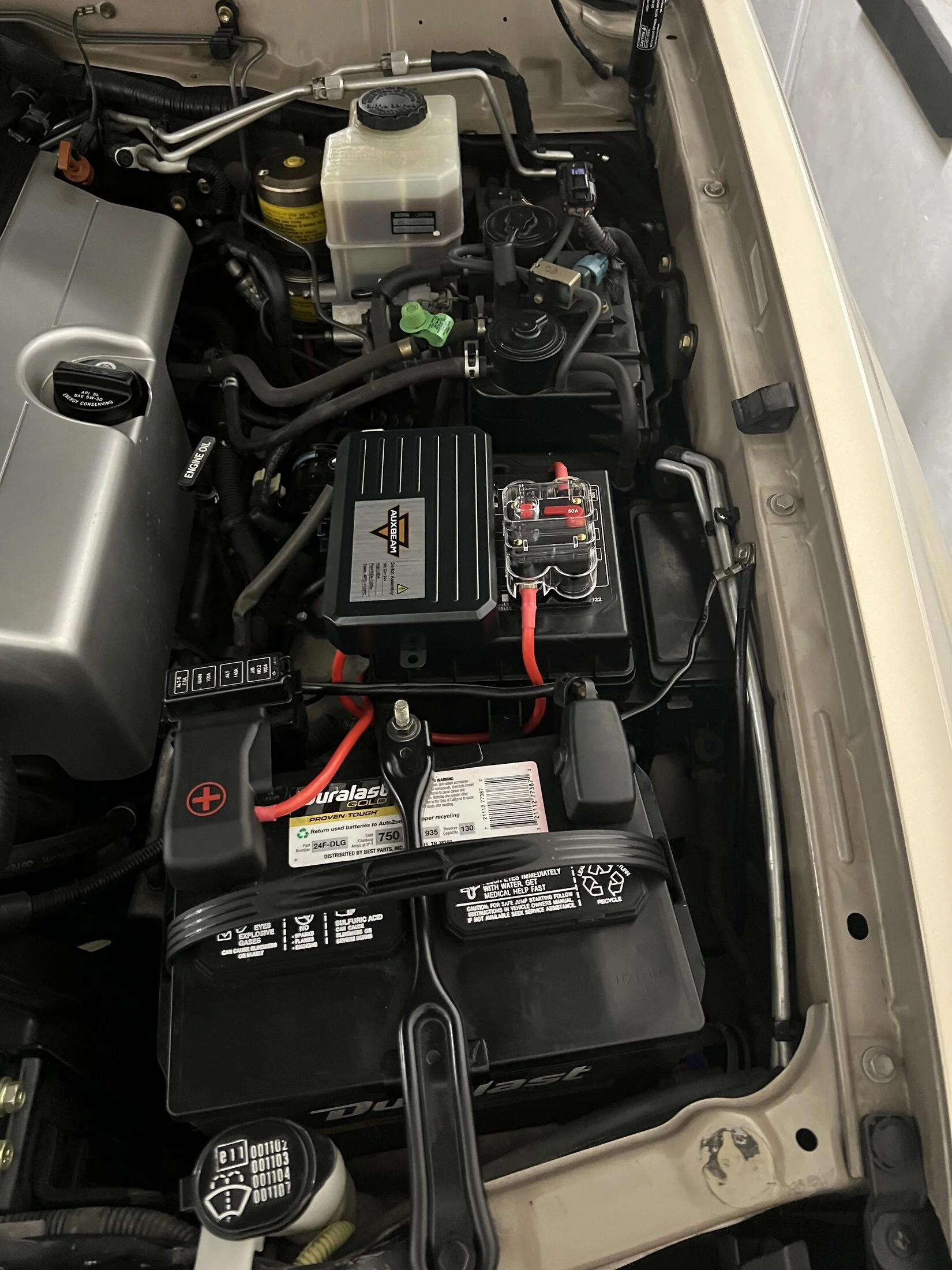

I went the lazy route and velcro'd my Auxbeam on top of my engine bay fuse box on my '02 LX470. No issues so far after approximately a year. Granted, my rig doesn't go off road though besides an occassional beach excrusion.

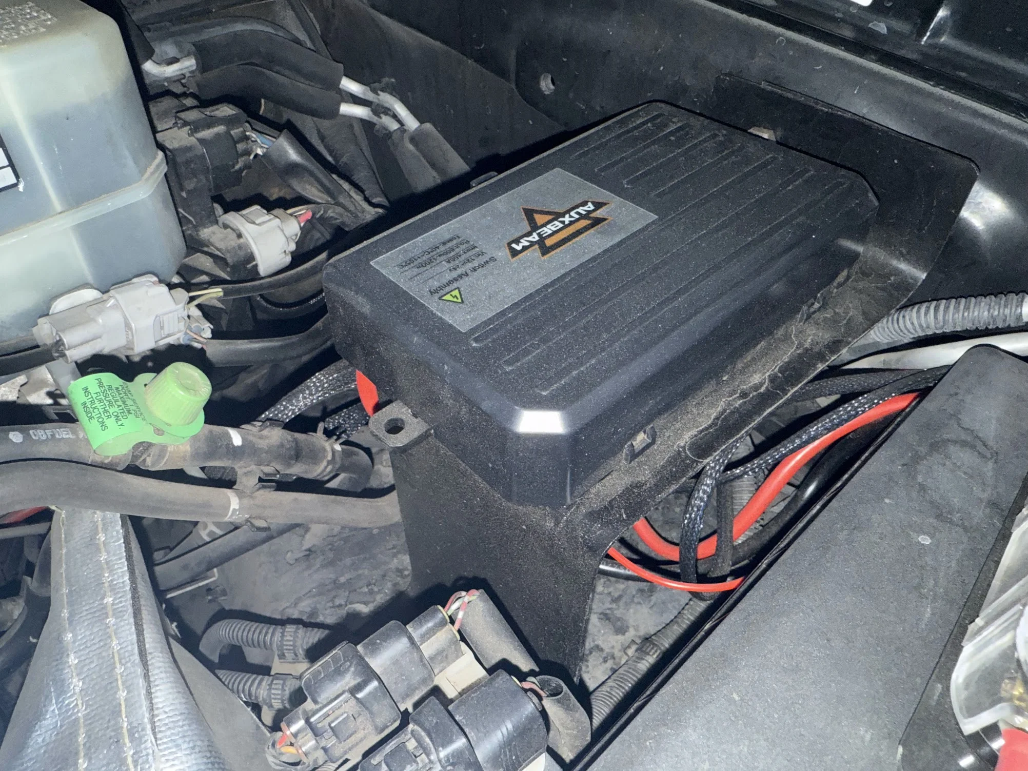

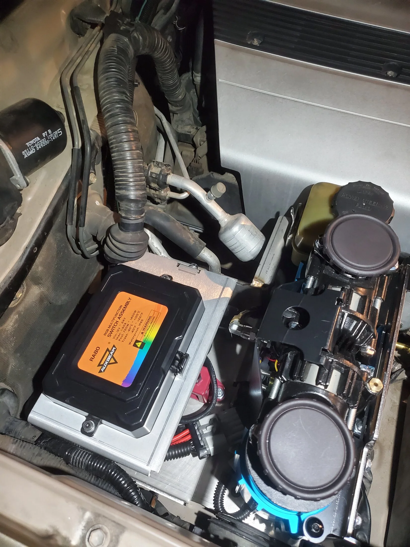

I have an 04 LX and bent some aluminum sheets to sit adjacent to the fuse box. Just couldnt figure out a better location to mount the fuse box though so I velcro it to the top of the factory fuse box
