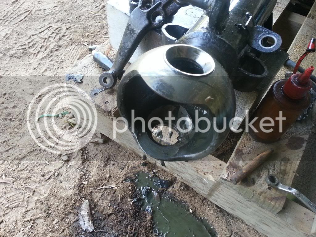

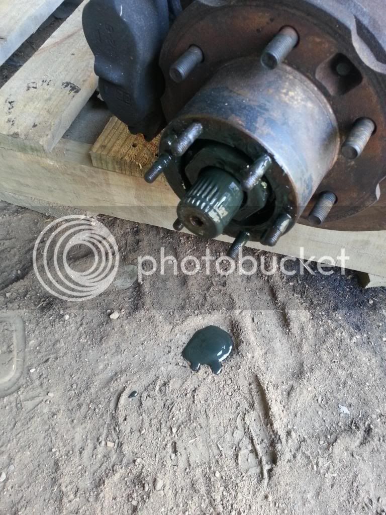

this weekend I started the rebuild of the steering knuckles. They had a serious notch that in the forward pointing position which needed to be fixed.

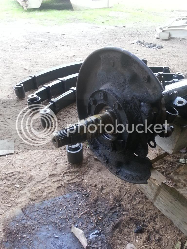

The freewheeling hubs came off nice and easy. That said, there was no gasket behind them. They were held in with silicone so I am not sure what previous work has been done.
I managed to get the nuts for the wheel bearings off without the required SST. this is good 'cos I have no idea where to get those things...

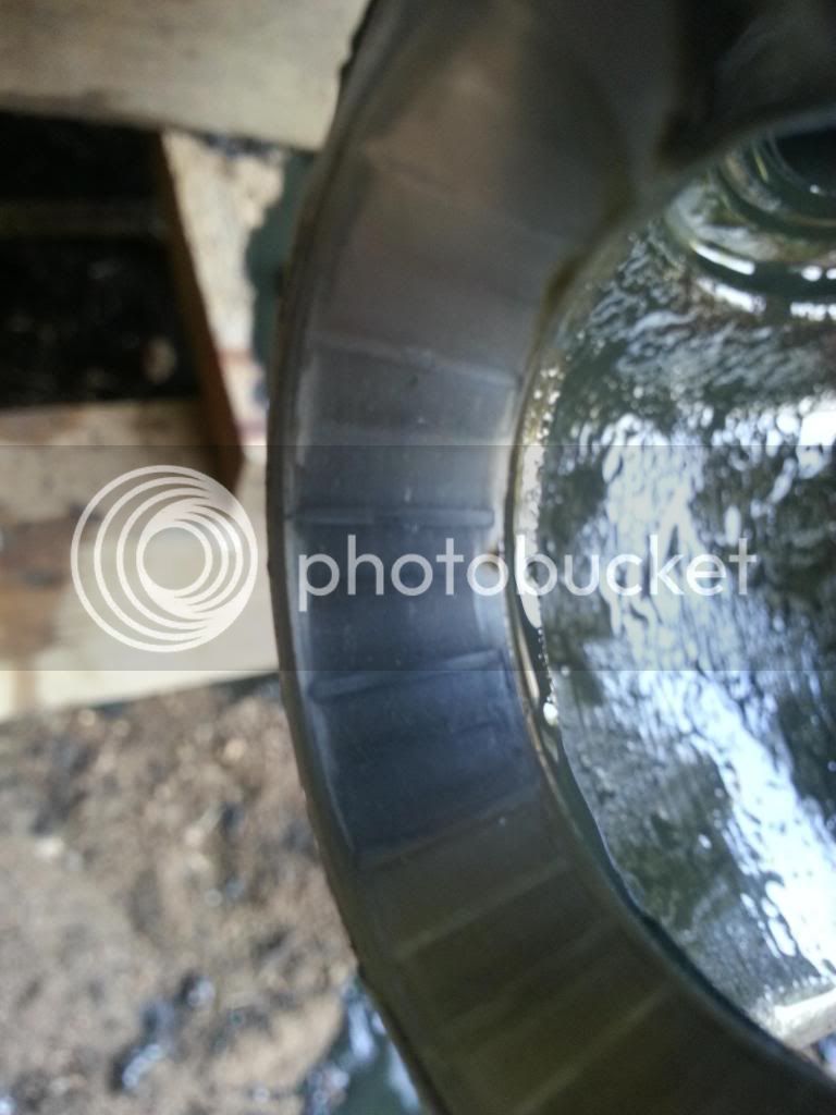

The whole lot came apart as quickly and eaqily as i could have asked for. luckily, the rust and roughness cleaned up with a bit of sandpaper so I am hoping that the knuckle seals last for a fair while.
The photo doesn't do justice to the roughness in the bearing seats. they were really, really lumpy!

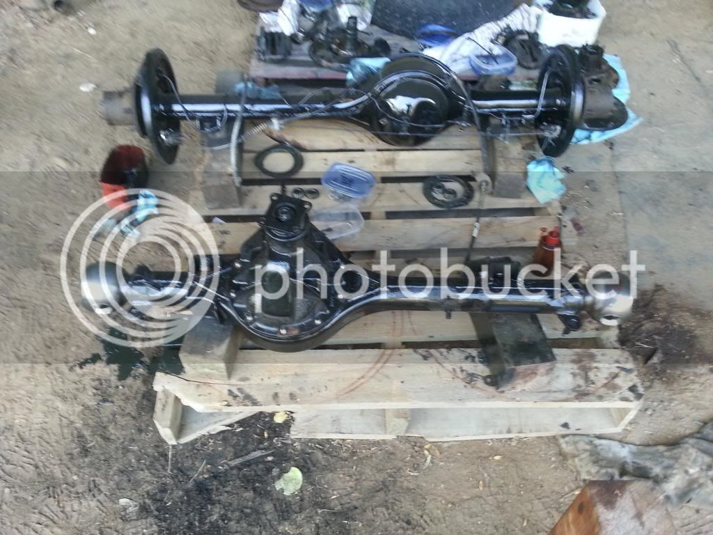

now it is all sitting in pieces while I wait for someone to give the front diff the OK (i'm not sure that the backlash is correct, but I am also not sure that I care enough to fix it)

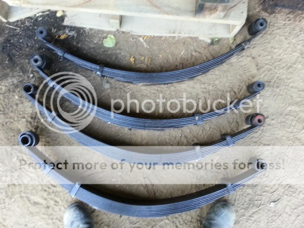

Speaking of pieces, the local spring guy had a gift for me.
The have been tightened up, raised a little (so that it will settle in to the right height) painted and had the bolts replaced. Now i am just waiting for ARB to get back to me with the new greasable shackles and steering dampener.

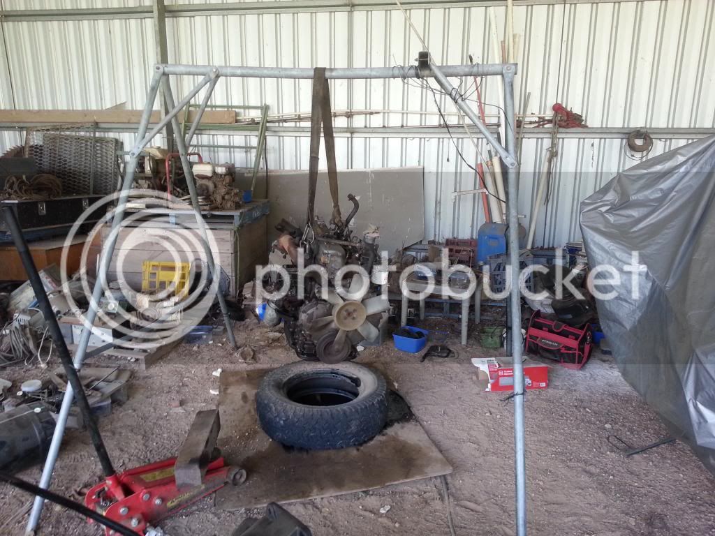

also, good to know that my engine is still safe, hanging on its "WorkSafe Approved" engine hoist....:p
Hope it stays there long enough for me to replace the leaky gaskets / seals...
