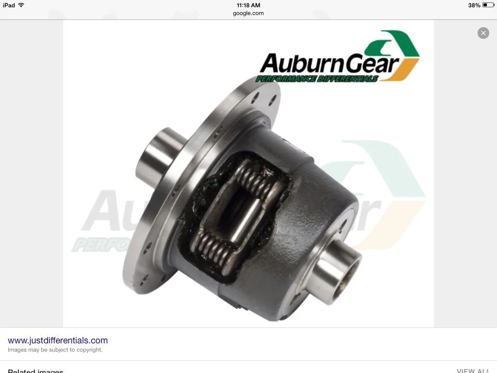

I want to know what is going on in the auburn unit second by second as I go down the road. What is the power/tuque split into and out of the turn?????? What is the stess with the tires ?????
I thought the Auburn used torque applied to the side gears to "lock" the differential? Not necessarily wheel spin...I dunno
The auburn unit is an LSD... not a locker.

Its been a while since I had the auburn units but they react the same as most any other LSD. Appears people are confusing LSD (limited slip differential with a locker)
(1) The auburn unit behaves just a LSD in a Z28, mustang...name your sport car or some trucks. If you have wheel spin the the auburn unit will attempt to "send more more to the tire that's not spinning as fast or for simplicity send equal amounts of power to both tires". Assuming you are referring the rear axle. The LSD will have no negative impact to the vehicle in motion on the pavement (has been my experience). If anything it will allow the vehicle to reduce wheel spin under hard throttle. From the driver seat no negative impact...other than better traction in a smooth and managed way.
(2) on rocks the idea is to go slow and manage the forward movement ...a LSD is not effective off road where you want to go slow and not have wheel spin, because while a LSD only works with wheel spin, if you try to induce wheel spin on hard surface off road its likely things start breaking....you also don't want wheel hops etc. The LSD will not break your axle or I've never heard of that happening.. no real impact from the LSD in this scenario....it will not be that helpful. If you get your wheels spinning and you come come down on a hard surface withe the wheels spinning under engine power....thats when parts start breaking under high traction scenarios...
(3) If you are talking about the LSD again...its a limited slip...not a locker. On a limited slip....you really know its working when you feel the vehicle move forward under tire spin and you notice both tires are pulling rather than just one side...this it happens under wheel spin because that's what is required for a LSD to operate. The wheel spin is the issue that you want to avoid in many situations offroad where rocks or hard surfaces are. Now in mud....how do you know the LSD is working....you have to hit the mud hole under power...you can't crawl through it (again remember the wheel spin issue). SO you hit the mud hole under power and stay in the throttle to keep the tires spinning and you have power at both tires (left and right tire on the same axle). Which hopefully moves you forward, depending on your tires and other variables. A LSD is seamless in its operation...you don't do anything but drive and about the only tool you have is to modulate the gas pedal in the deep mud, since in my experience that seemed to offer better results than just hammering down on the throttle.
The single biggest issue with a LSD is that its basically useless at crawl speed...where you don't want tire spin, yet you want traction from both tires. AS noted a LSD is a good traction aid for on the road use...its not a very good traction aid off road. When I had the auburn units I would have to hit obstacles too fast and it increased the opportunities to damage things, so I went the mechanical locker route.
A LSD has no bad manners that I'm aware of, but it has few positive attributes offroad expect where you can power through obstacles like mud holes or maybe sandy areas under power. Where you need slow speed without wheel spin teh locker rules......
