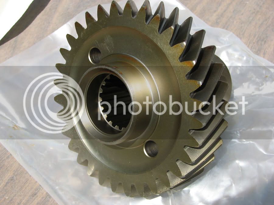

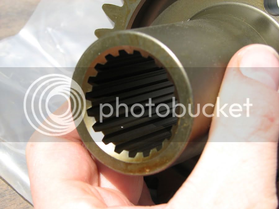

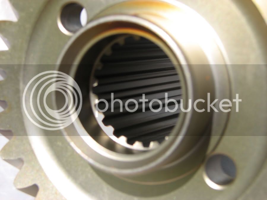

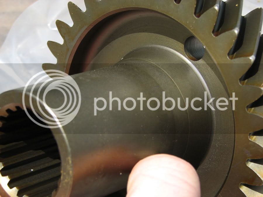

The McNamara gear showed up today. Hopefully the rebuild kit isn't far behind and I can get this done with next week. I was a bit surprised, I thought it was going to be a Toyota gear with mated to a newly machined center spline section, but as far as I can tell, it's one piece. Once I get this in, my drive train is going to talk with a heavy Aussie accent.
For the record, I am running ATF in the case right now, and can definitely tell the difference in terms of clunk.
As always, a few pics.
Awesome! I am kicking myself for not picking up one of those when I replaced the transmission... I currently have a minor 'clunk' and the forum suggested I pick up this gear when replacing the trans and rebuilding the tcase. Live and learn...
I suspect you can go a long time with clunk before it actually gives. Swapping in the extreme valvebody made my clunk more apparent, and I suspect accelerated the wear on the shaft. The shifts between drive and overdrive with the convertor locked are pretty harsh with any slop.
