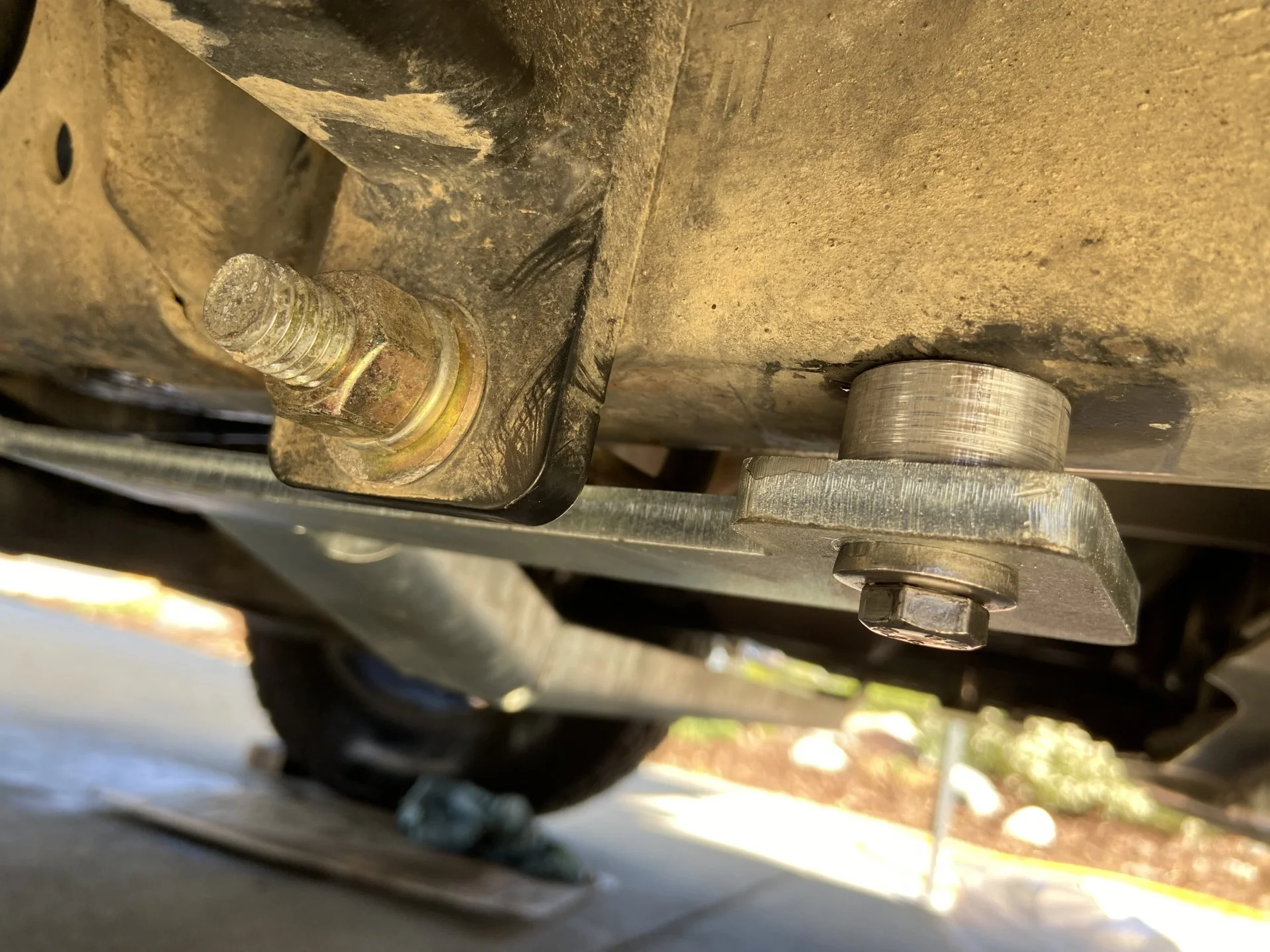

I got the front skid installed and then ran into my first problem. The mounting bracket for the transmission skid wouldn’t fit over the ubolts for my White Knuckle sliders.
I was stuck! More than a year passed before I decided to tackle the project again. I decided that 1/2” aluminum spacers would be just the thing to enable the bracket to clear the u-bolts.
The spacers seemed to be just the thing!

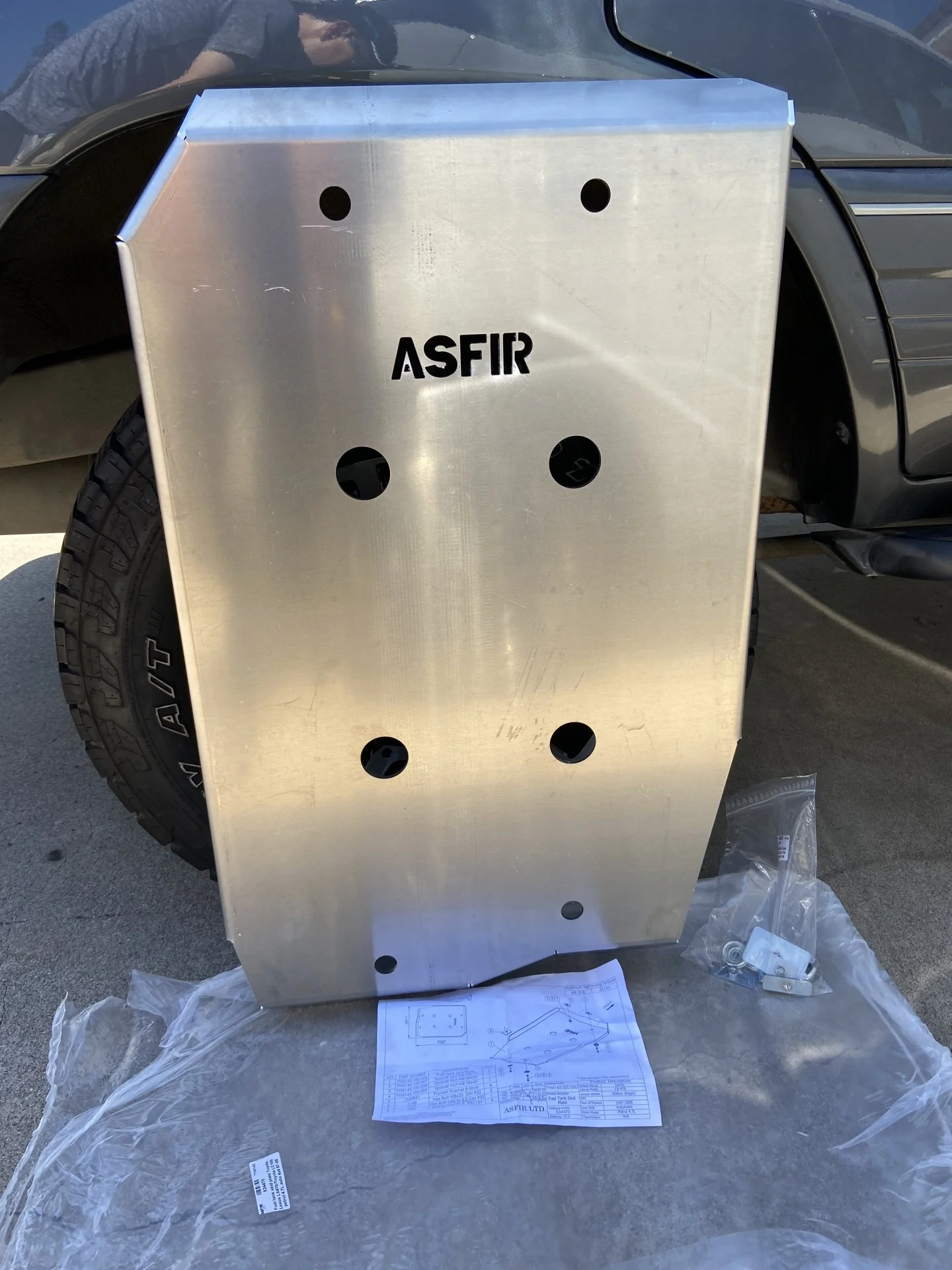

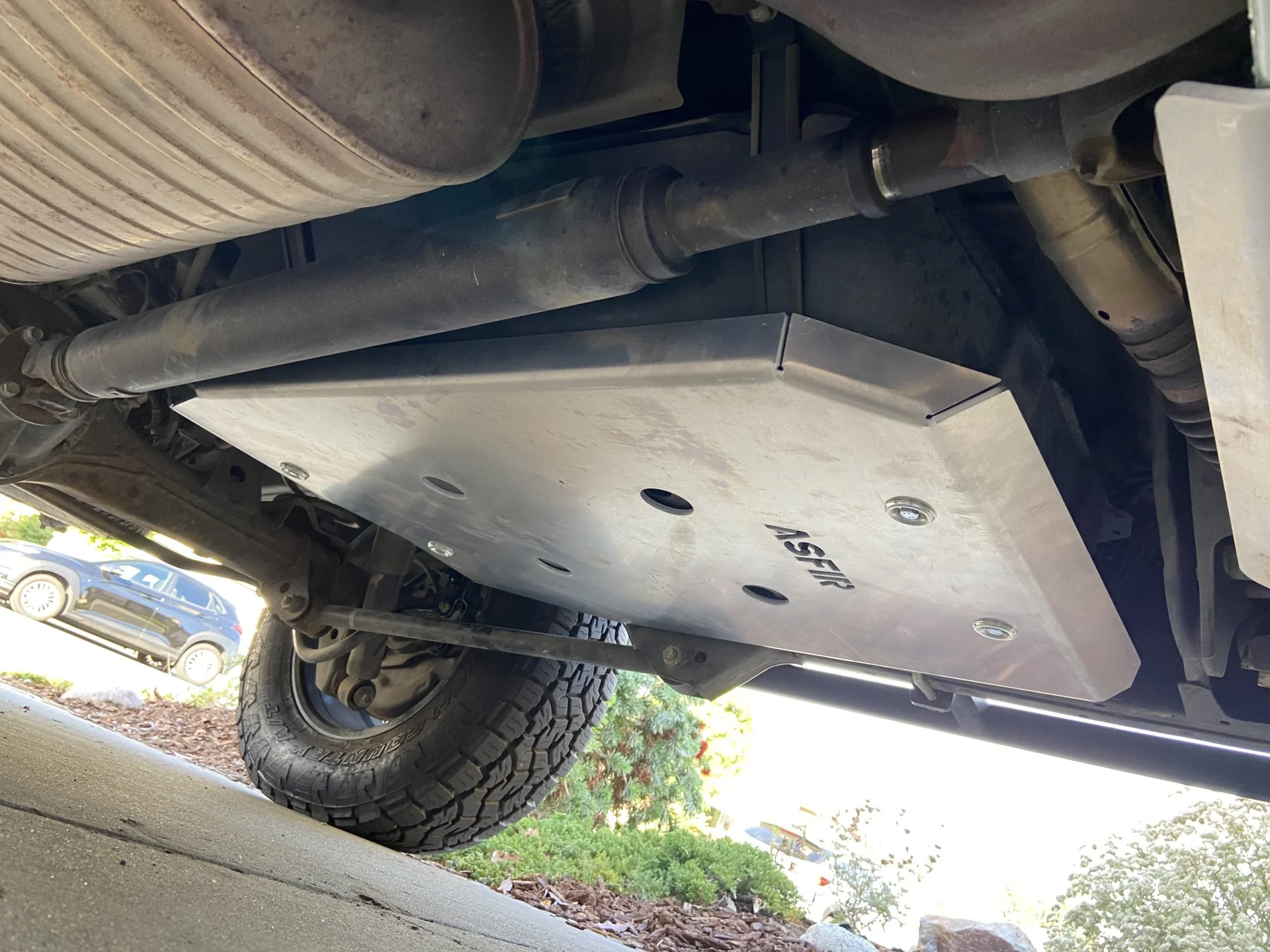

I’m the meantime, I discovered that ASFIR released a gas tank skid. From Israel to So Cal in 3 days.
So exciting. I immediately set about trying to install.

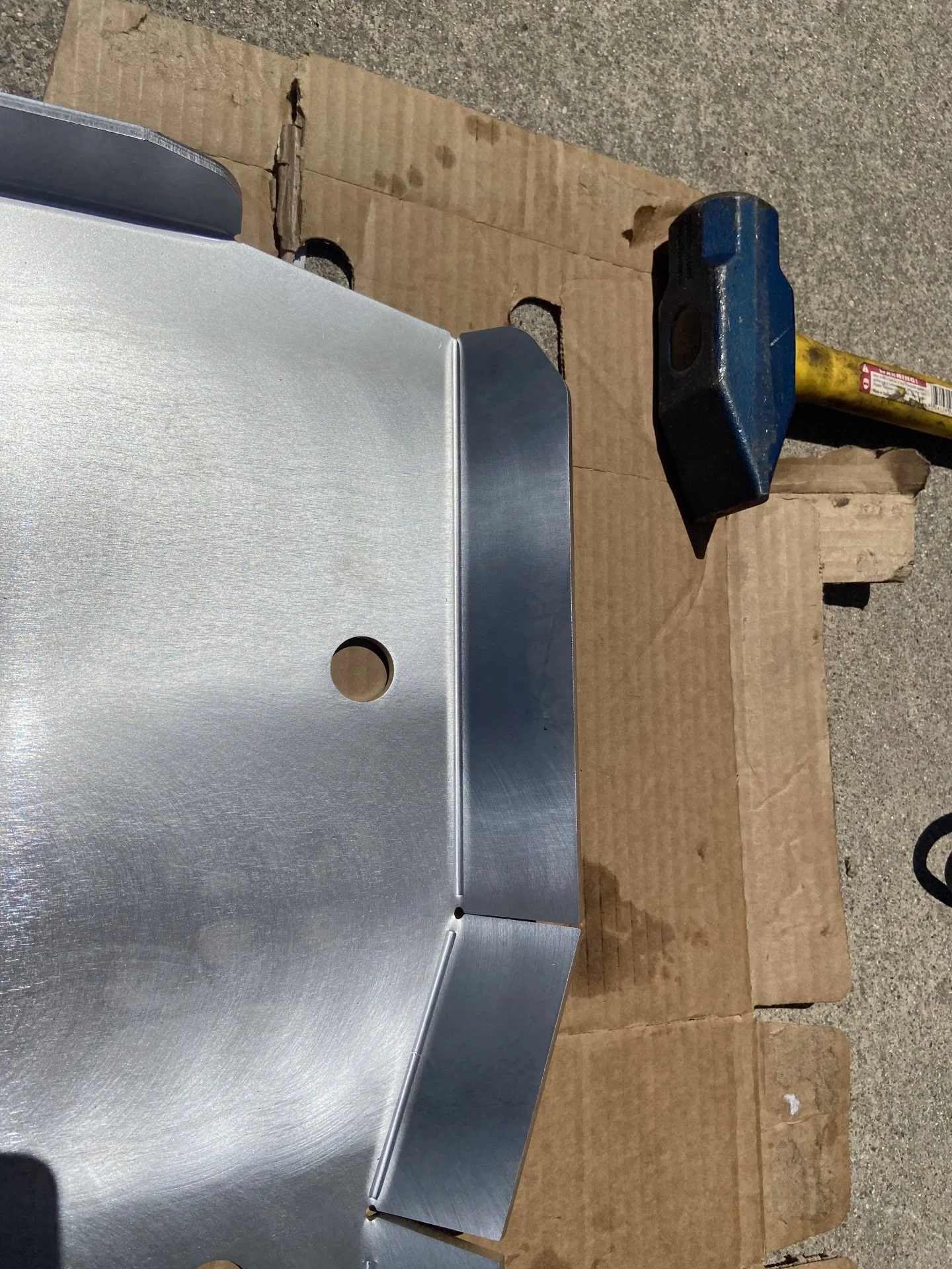

More trouble! The skid didn’t follow the curve of the tank, the folded age of the skid hit the tank, and the bolts weren’t long enough to thread into the mounting brackets.
I solved this problem with a sledge hammer and longer bolts. I pounded the edge down about 1” and used the longer bolts to reach the threads. I was a little bit concerned that they might puncture the tank, but so far so good.

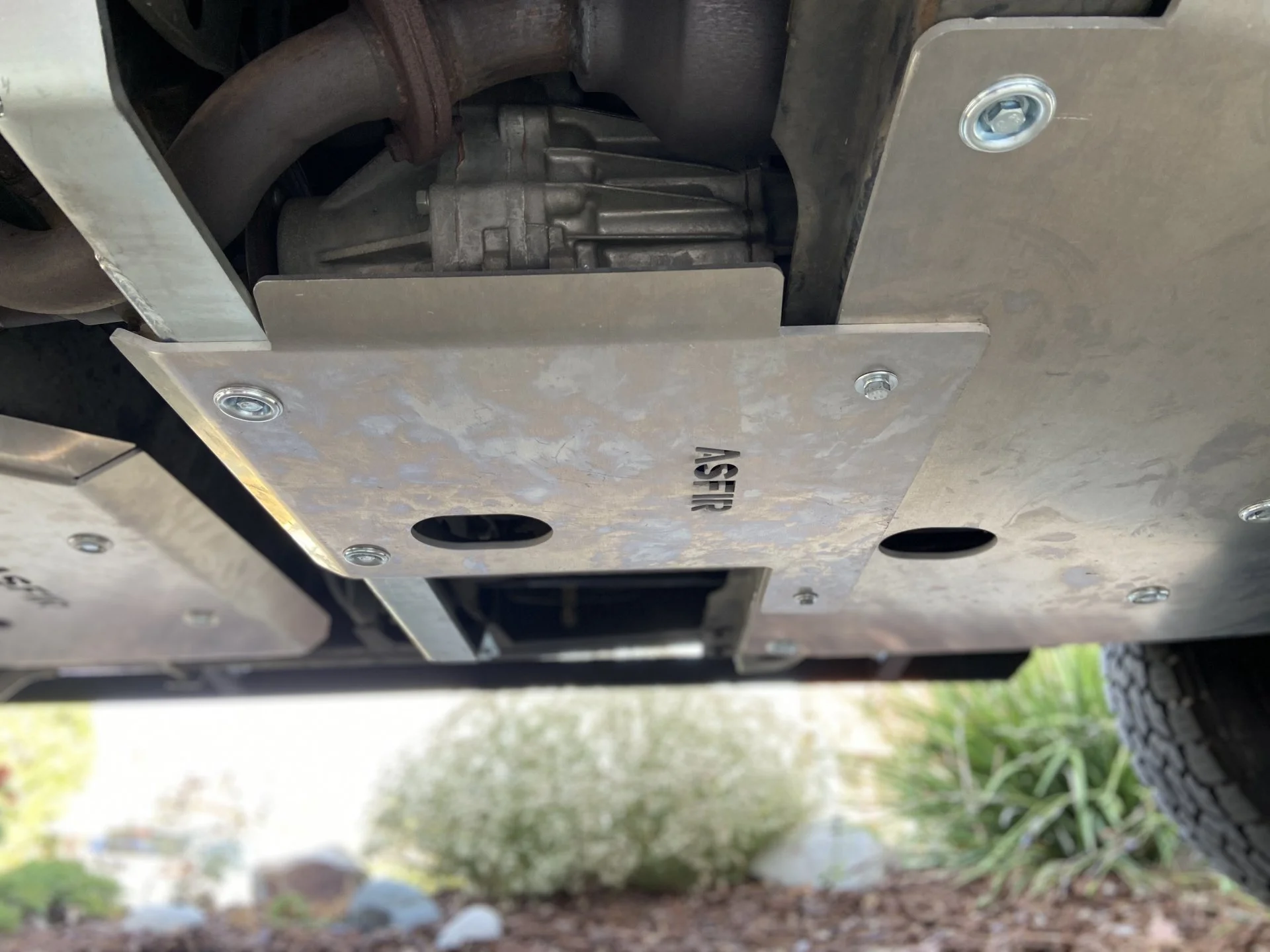

Back to the transmission skid. Adding the spacers changed the geometry just enough that the holes wouldn’t line up! I employed a rotary file and elongated the holes.
I didn’t like that the transfer case skid only seemed to fit correctly on top of the transmission skid, but in the end it seems like that’s the way it’s meant to fit.

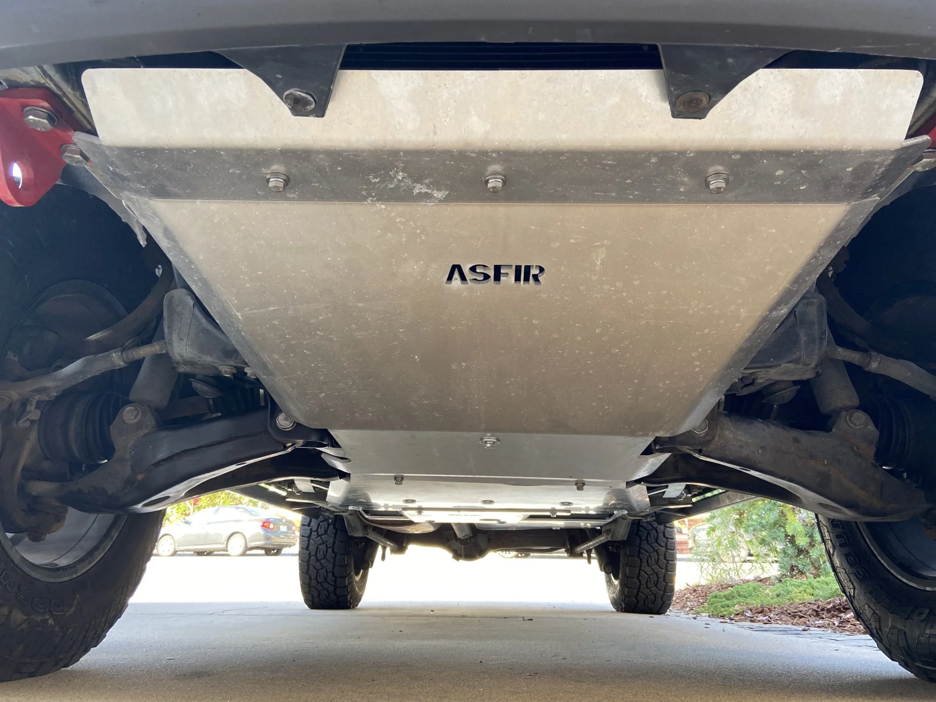

Eighteen months later, the war wagon is ready for the trail!

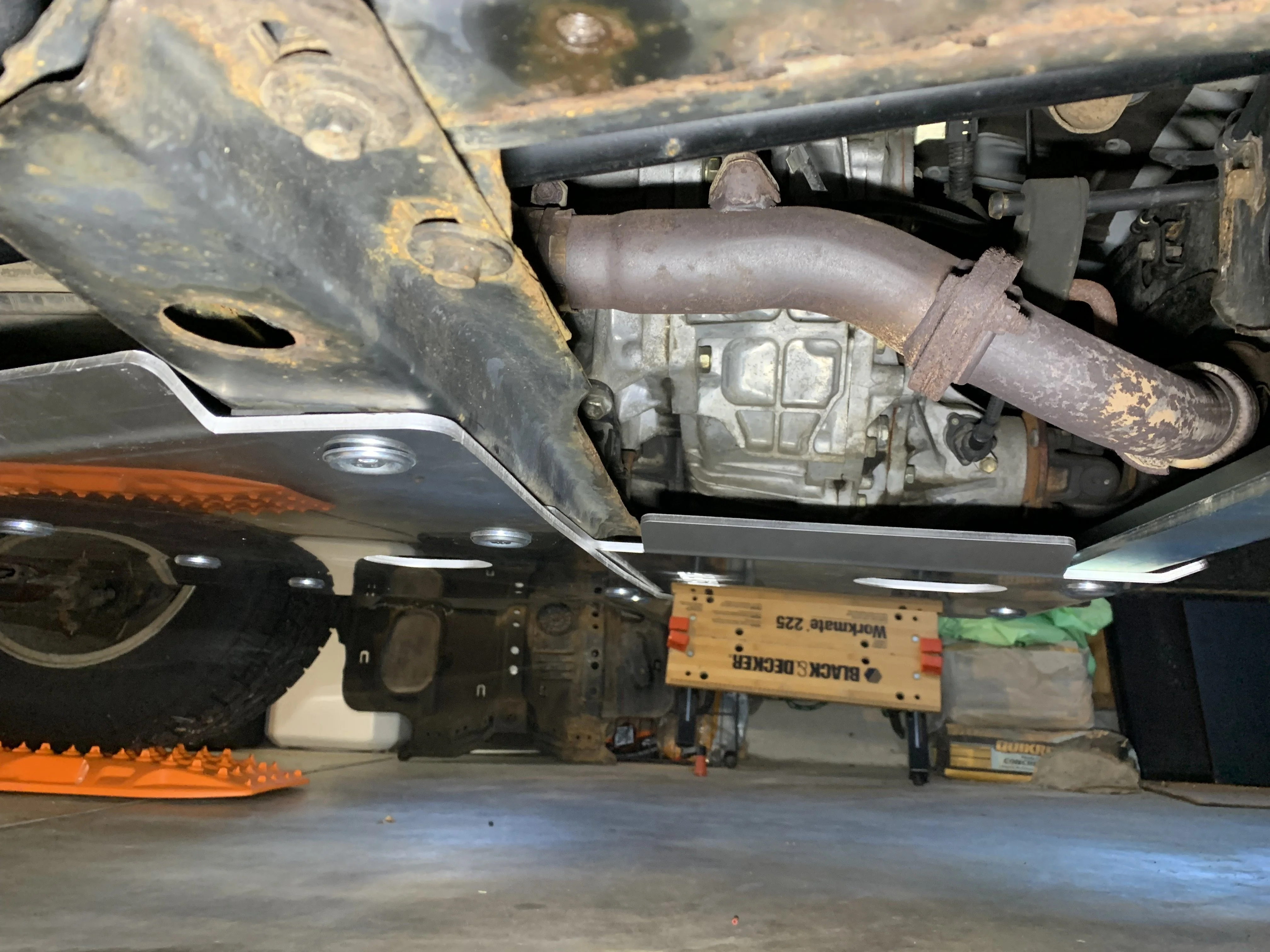

I installed the rear skid next to the frame with the middle skid on top, but it kinda wraps around the rear skid.

Thanks for posting with the detailed pics! With the spacers, did you get new bolts or used the same ones? Assuming new ones, what size did you get?
I bought 20mm longer 10.9 steel bolts for the spacers. I think they were M8 x 55mm coarse.

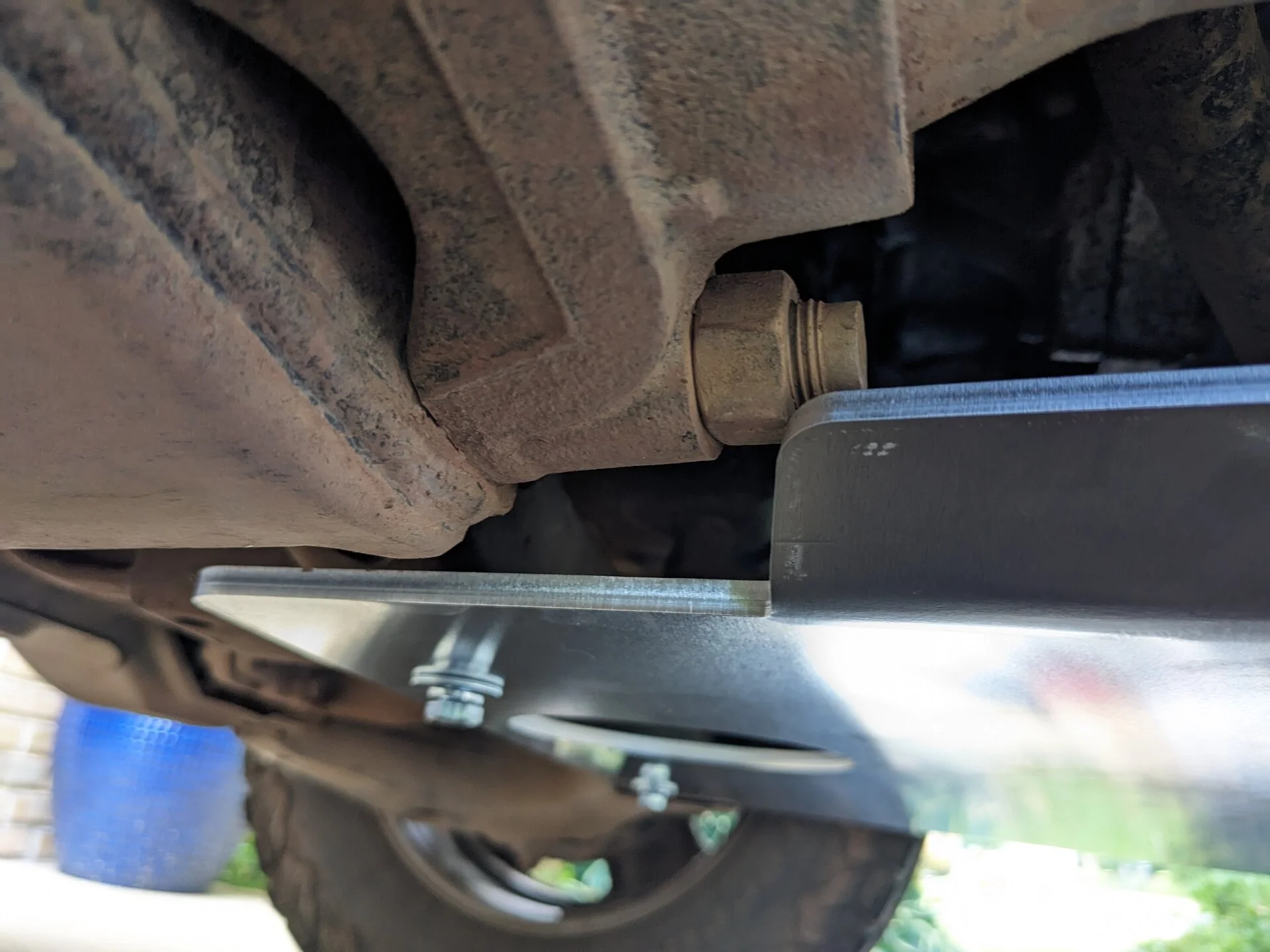

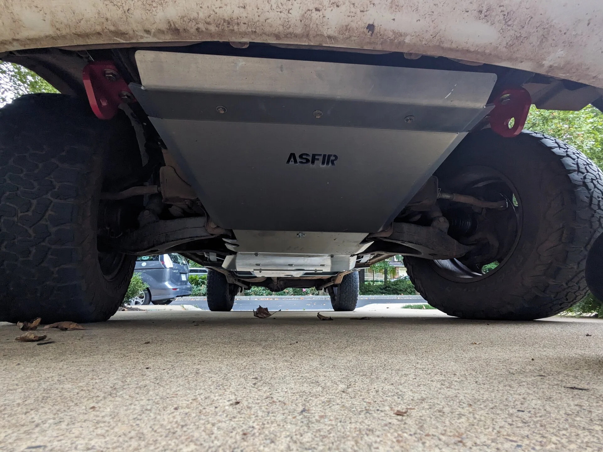

I installed mine about 2 months ago, 1999 LX 470 with AHC and otherwise stock suspension (no lifts etc). The middle plate was not a perfect fit, because the torsion bar mount bolts ran up against it.
Ended up sawing off a roughly 2x2 square from the skid plates. Other than that, everything bolted on well. Took like 4 hours total for the install the first time, but I only have hand tools and everything was done on a tarp in the driveway, so a lot of time was just spent crawling in and out.
A few notes:
1. The instructions for the middle skid plate didn't fully match the ones online. If you end up with different instructions, use the ones that came with the skid plate, even if they're worse.
2. Go back to front. Install the transfer case skid plate first, then the transmission skid plate, then the front skid plate.
