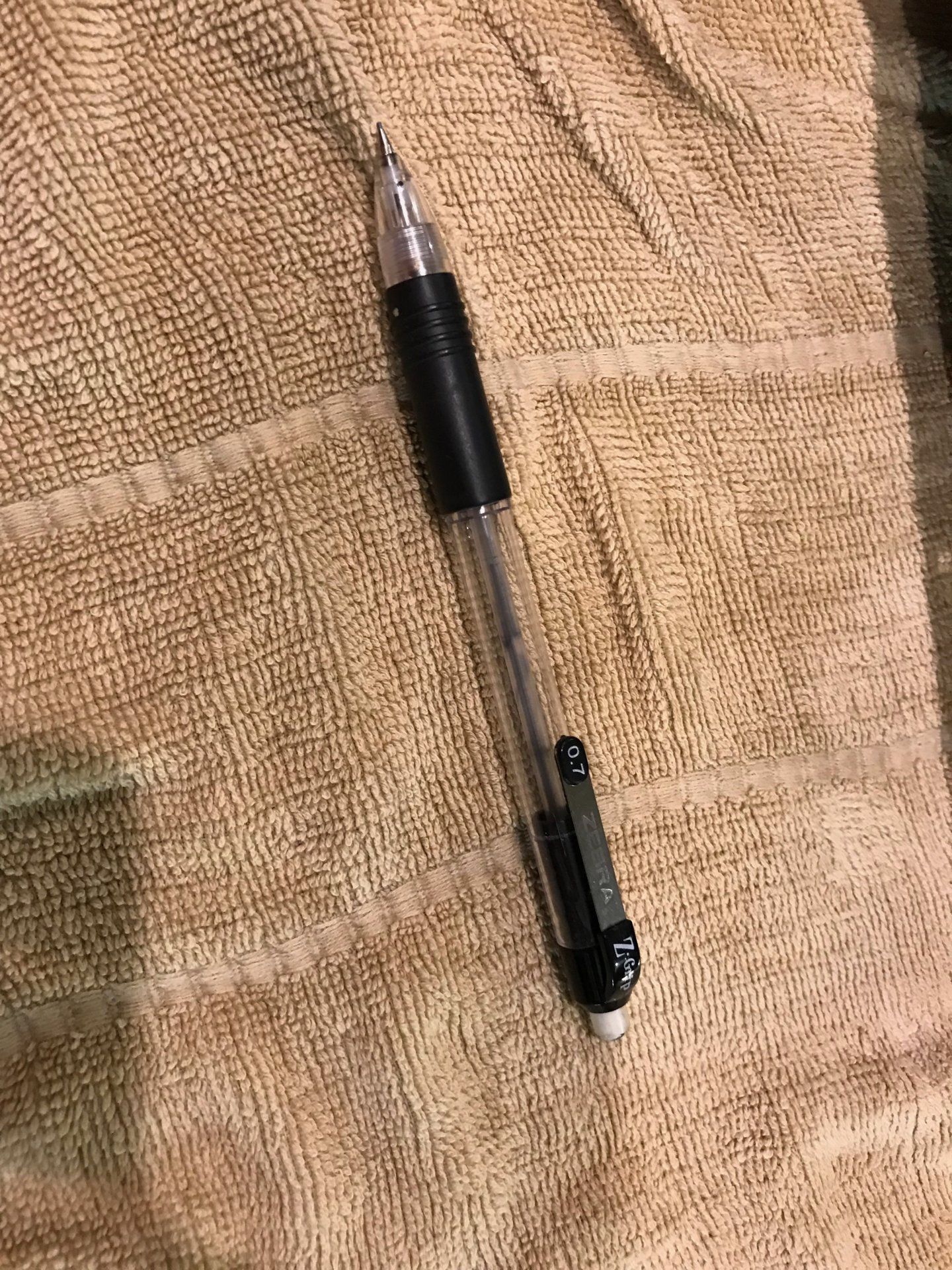

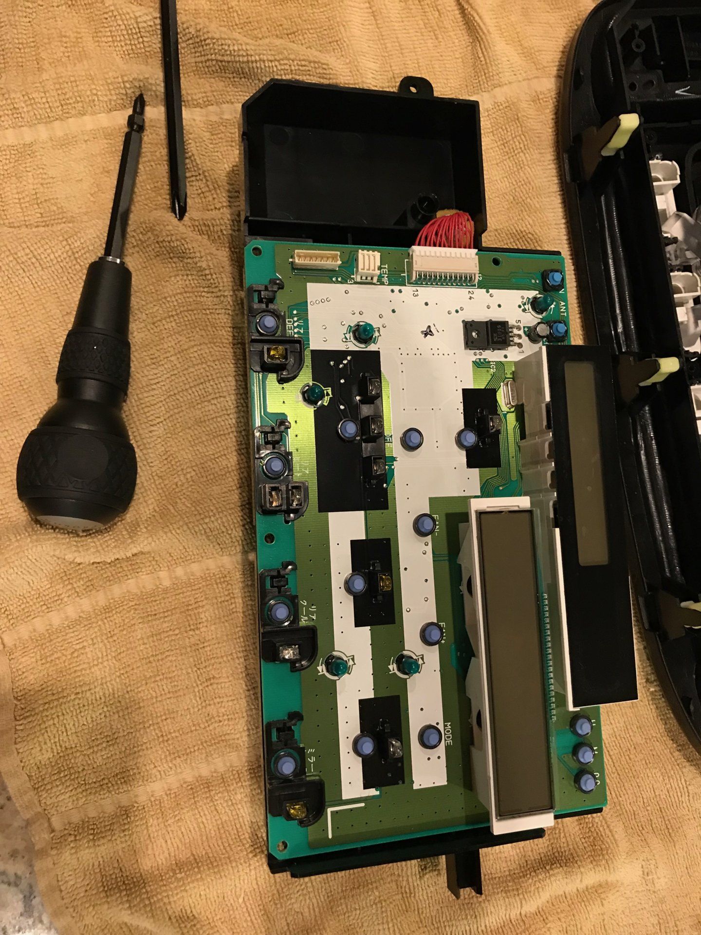

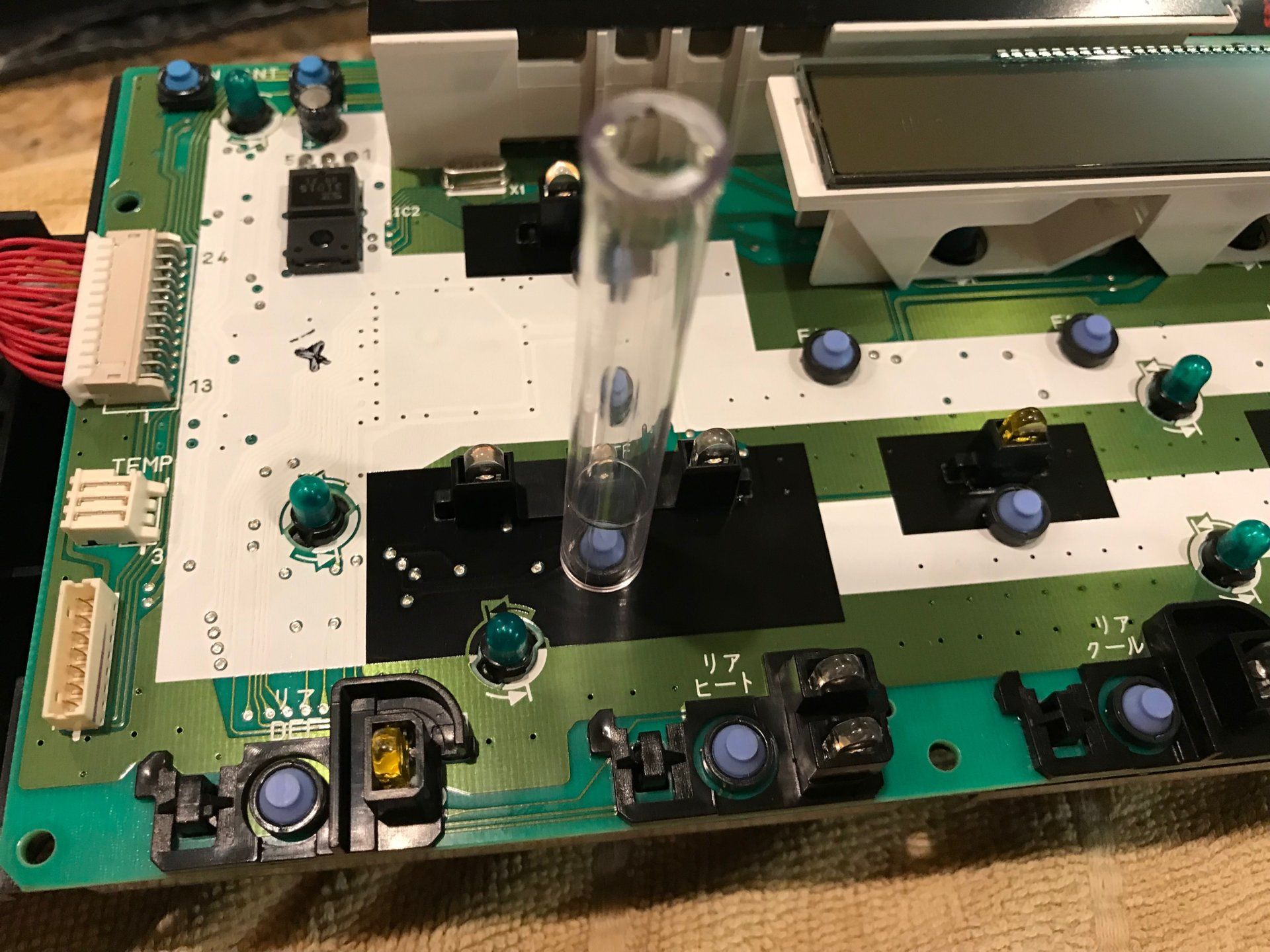

My center console buttons have been working intermittently. This is a great thread on how to replace the buttons. But before tackling the job installing new switches, I thought I'd give it one easy attempt at cleaning the switches. And after a month, I can say it has worked for me. YMMV! Pictures shown are from a '98 LX470 but the same method applies to all years.
Parts needed: D-Series Deoxit D5 (or equivalent), suitable ball point pen/mechanical pencil (preferably clear housing), latex gloves (optional), air gun/blow dryer helpful but not necessary.
Step 1) Disassemble center console/climate controls until you get to this point. Careful with the electronic connectors.

Step 2) Find a sacrificial pen/pencil that fits over the switches. Cut it down as such.

I'm surprised to see a contact in the second position from the left where our trucks have a blank panel. What would that contact control if the blank panel were replaced with a button?
I think it is an option some trucks had to toggle the rear blower high/low speed? I’ve seen pictures of that button there before.
I pulled the cover off of mine and push the white part like a button the bottom light comes on, when I push it again the top light comes on. That's all that happens though.
