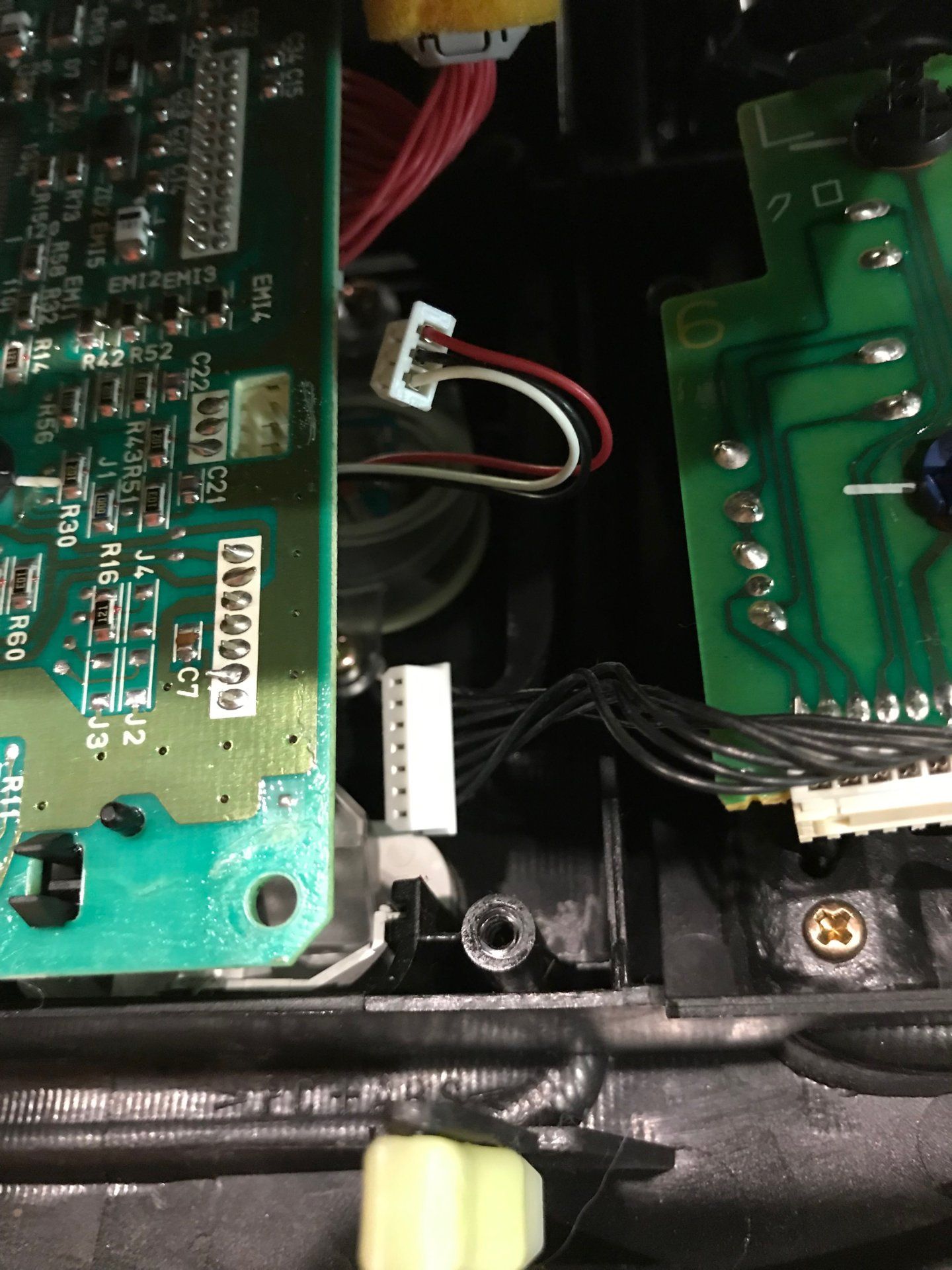

Step 1) Disassemble center console/climate controls until you get to this point. Careful with the electronic connectors.

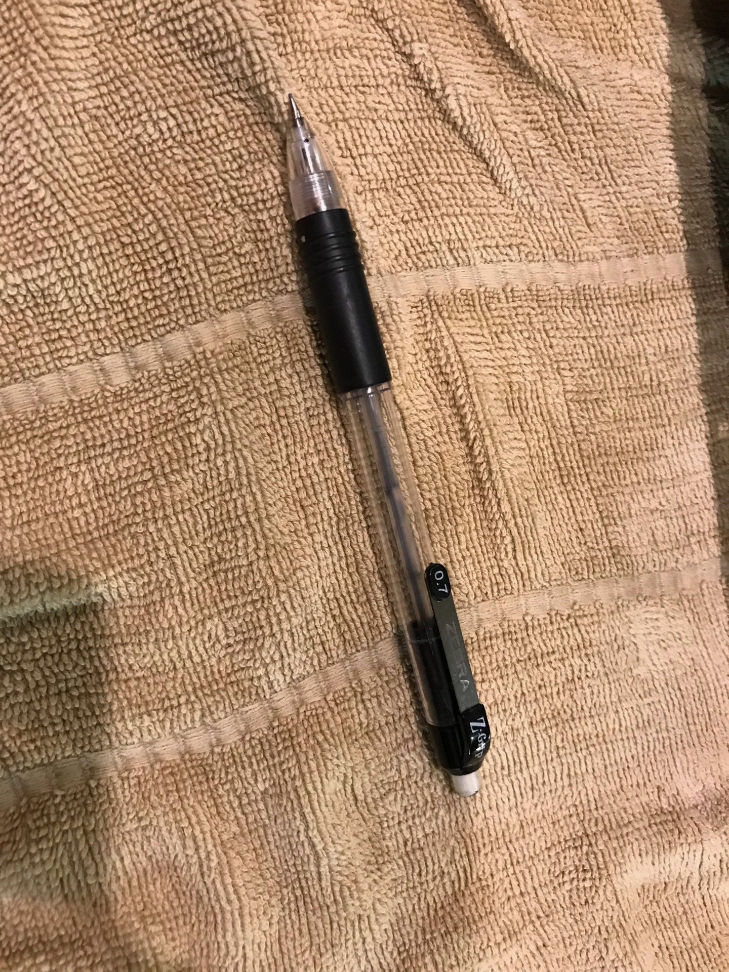

Step 2) Find a sacrificial pen/pencil that fits over the switches. Cut it down as such.

Step 3) Generously spray Deoxit into tube and then vigorously "work" the switch so the Deoxit is absorbed into the switch. The switch is water resistant but not water proof. I used the ball pen's insert/reservoir to work it. It has a blunt tip and won't tear the rubber.
