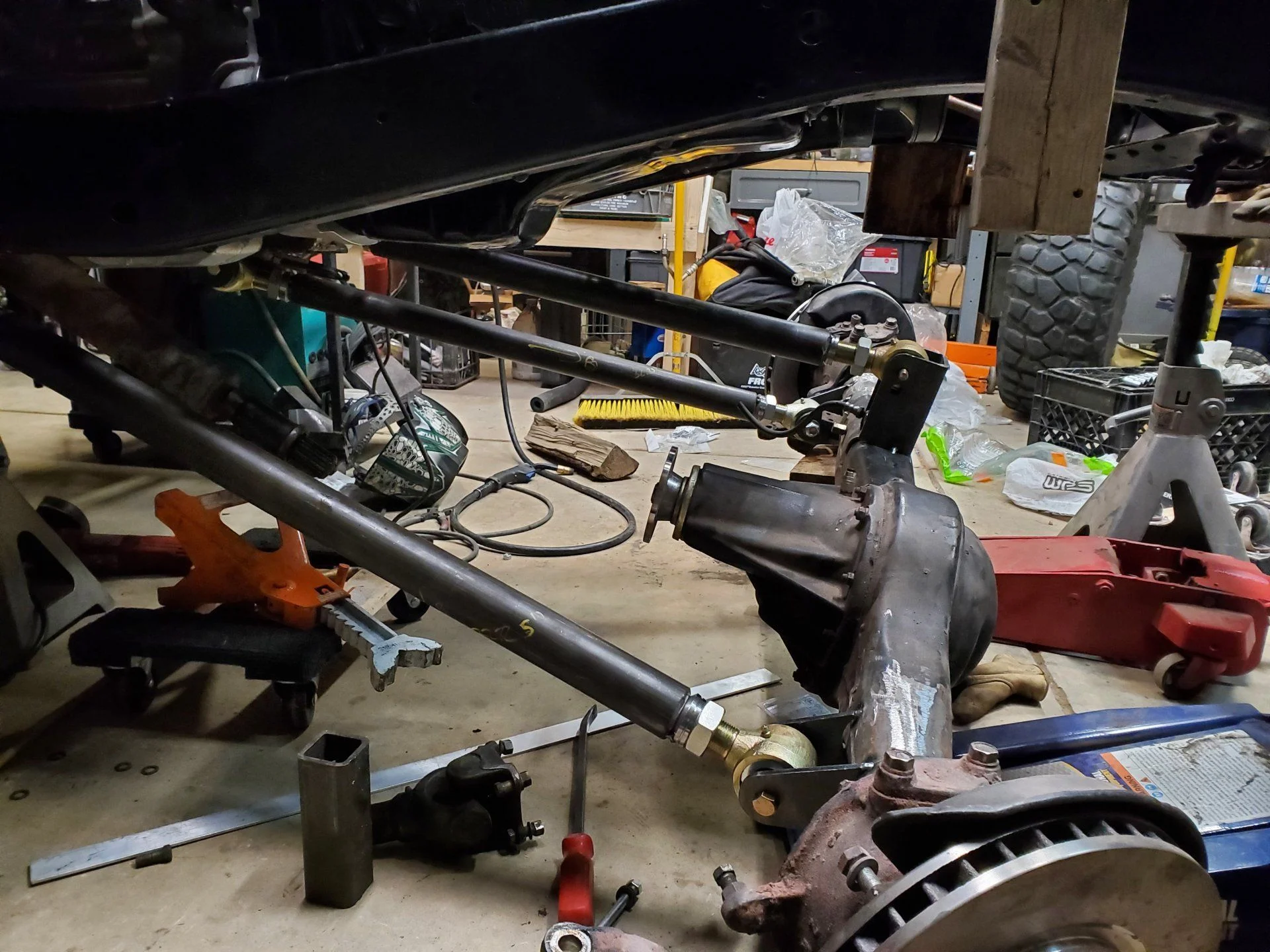

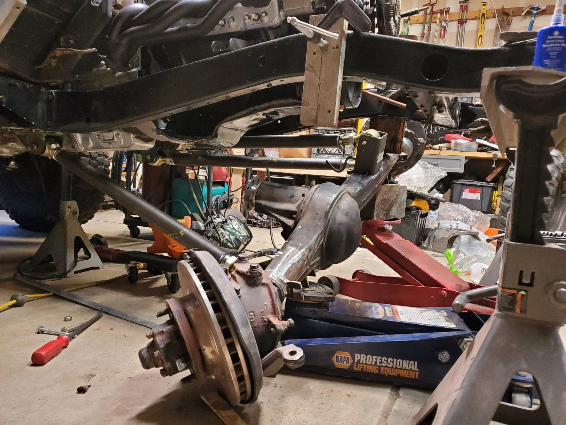

I'm not really sure if this is the right place to post this, but I'll ask anyway. I have a fully built FJ80 front axle on the 40 that I am building. I just got finished fabbing a 3-link for the front, but I'm thinking that I am going to have clearance issues with the high pinion of the 80 axle. I never thought that I would say that, but I managed to get the frame low enough, and the axle high enough, that it is a problem with the caster correctly set. Are there any 8" low pinion diffs that would fit into the 80 housing and work?
Here are a few pics. The panhard is not set yet, but I know that a slightly lower diff will help me clear the bellhousing and oil pan.

Im thinking that I am going to run a traditional, but at full droop on drivers and full stuff on passenger, i start to hit my bellhousing and oil pan. A lower diff would let that clear by increasing the driveline angle.

It would be maybe 4" of up travel at most with that HP. I could probably get more like 6" with the low pinion. I'm planning on trying to see what is possible once I get my steering and Panhard done, but I would like at least 4" of up travel in the end.
