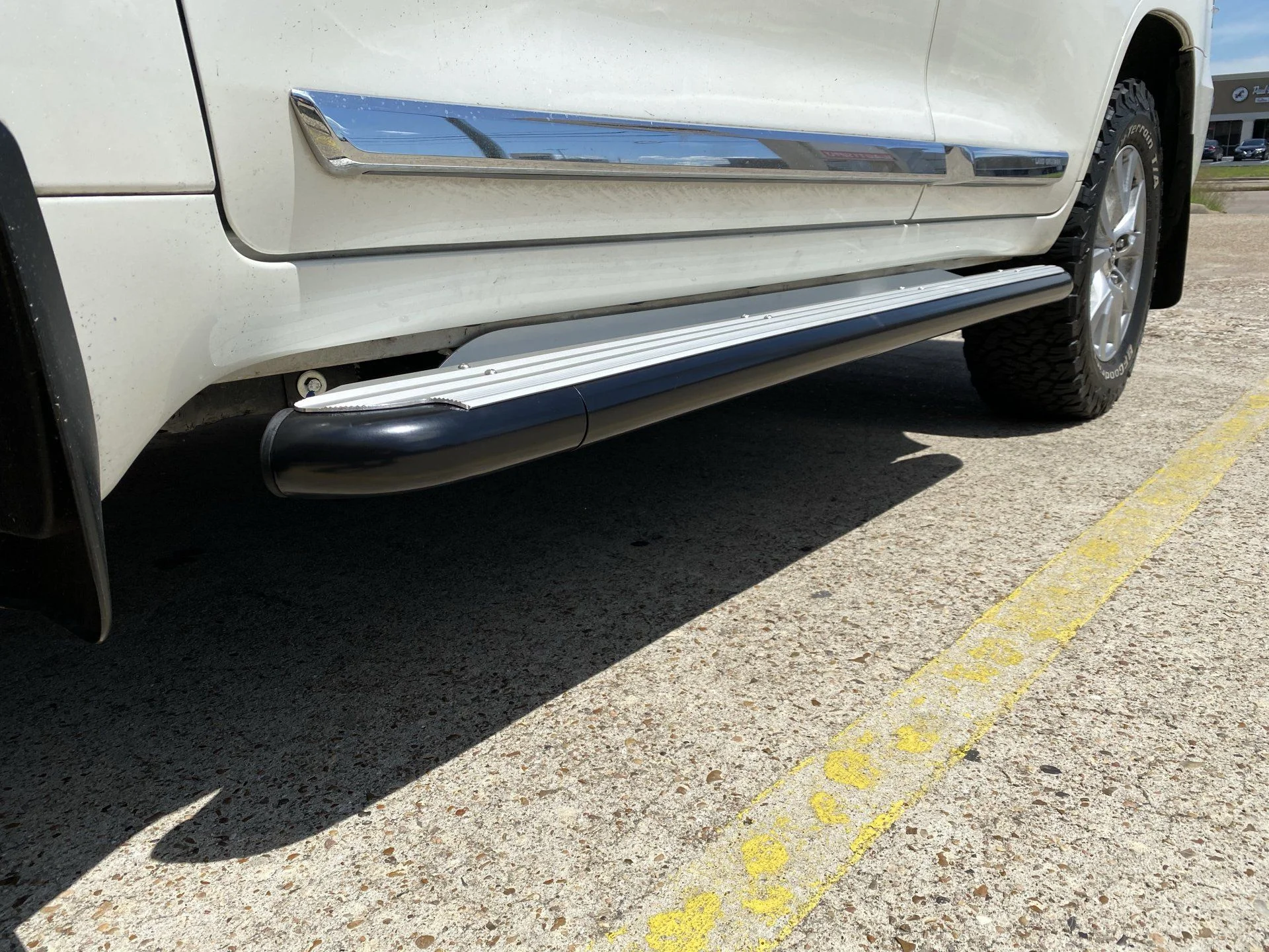

Ok, i did a search on these ARB sliders and found nothing on this forum. So, i am reserving this thread for my install of them.
As noted in thread above, i have very specific requirements for my sliders. Not too heavy. Easy install. No KDSS line manipulation. Must have step for kids and to prevent rocks from damaging side panels.
BudBuilt and Slee traditional sliders...great, strong as hell products but all their products require KDSS manipulation and overkill (and heavy) for me.
Slee newest sliders for LX...looks amazing and no KDSS manipulation, but the cost was high for me. Slider = $1185, LC kit = $49.99, revit nut = $35, drill bit = $24, and shipping cost = $283.86. Total = $1577.85.
On a recent trip to Black Gap Trail in TX, i did this: Post your wheeling damage pics
So, my sliders plan moved up in priority. (I could learn to drive better, but who has time for that?!)
Thanks to @Eric Sarjeant advice, I picked ARB Summit because it is simple to install (from what i read), made specifically for 2016+ LC, and looks good (again from pics). I went on ARBUSA website and found local distributor. Called them up and ordered. A friend of mine has a shop...so, will stop there to install once i have the sliders.
More info on sliders:
ARB Summit Series Side Rails and Side Steps Kit for 2016+ Toyota Land Cruiser 200 Series
Parts # and cost: (No shipping cost because delivered to my local retailer)
#4415100 Summit Step Section 200 = $821.99
#4415120 Summit Return 200 = $238.99
Total after tax = $1148.51.
Edit: weight of both sliders = 85 lbs!!

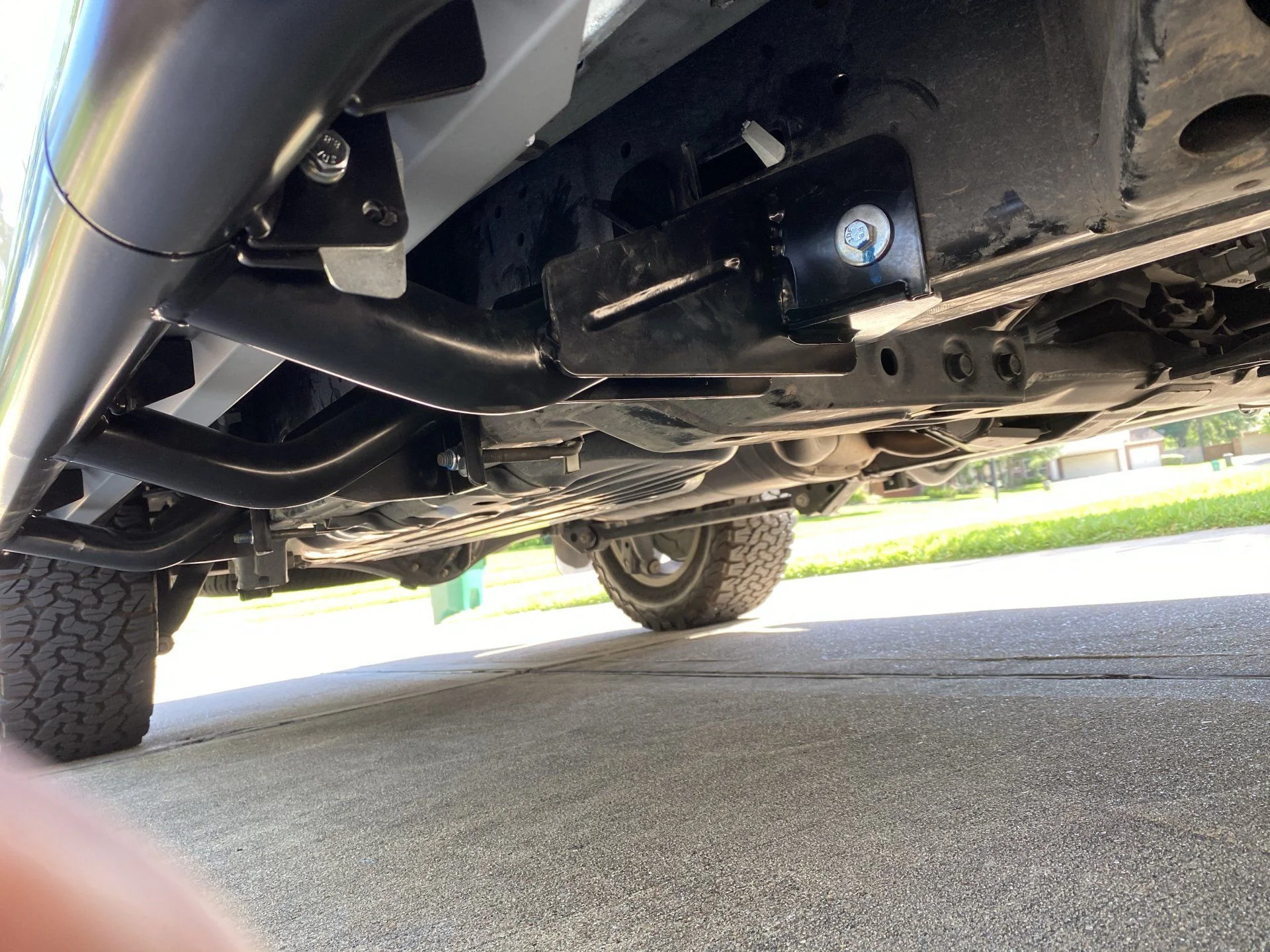

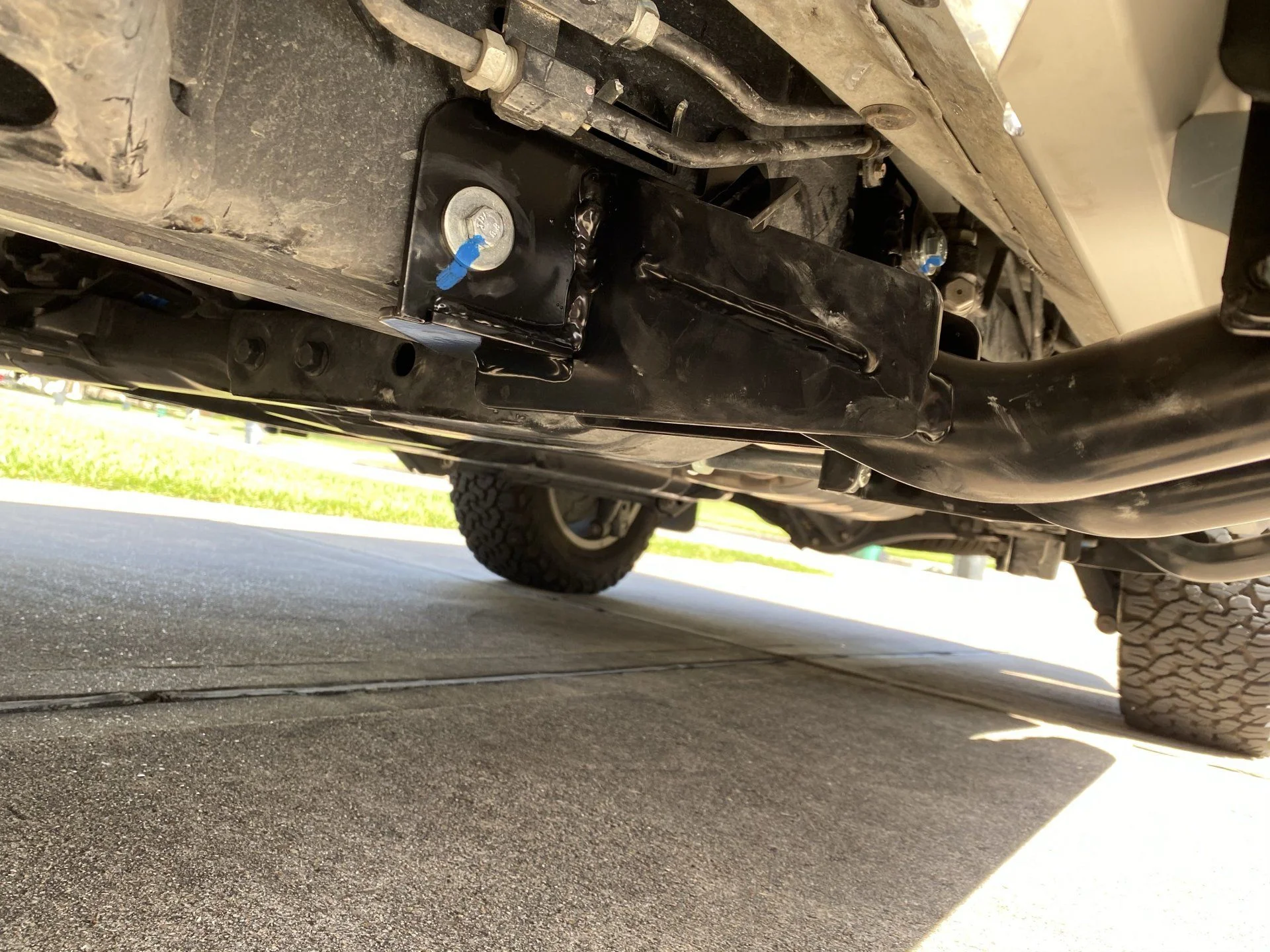

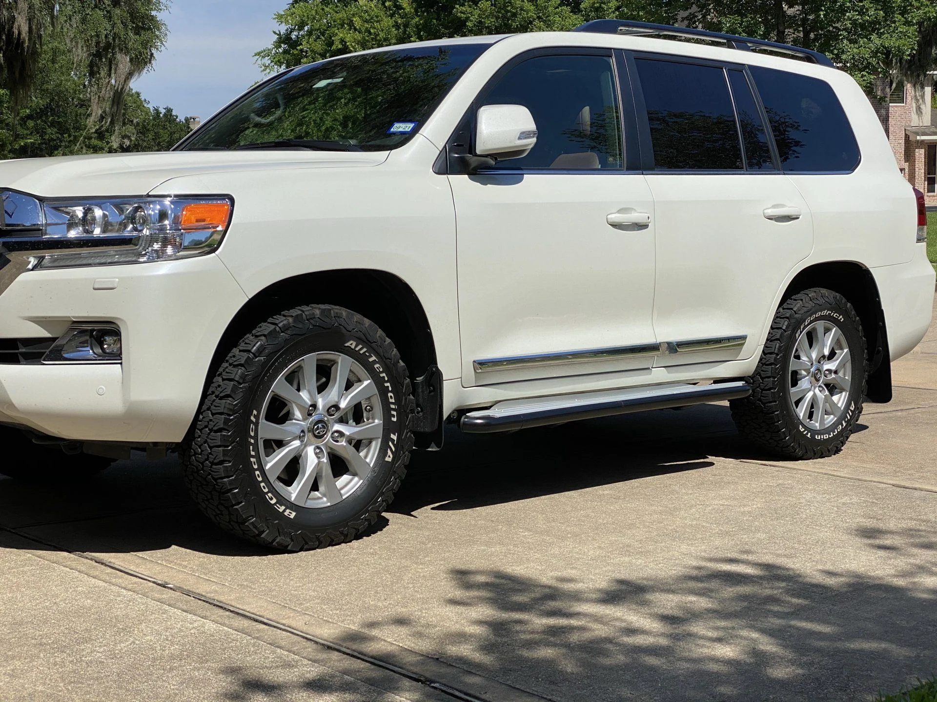

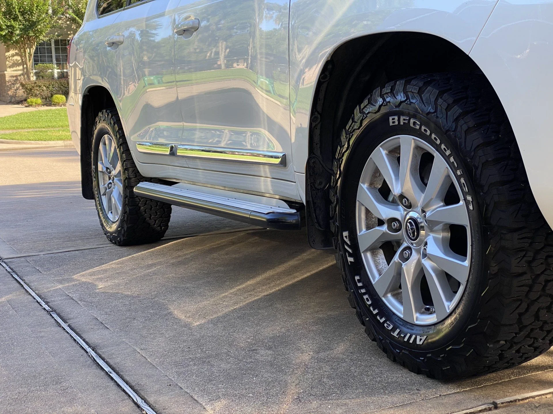

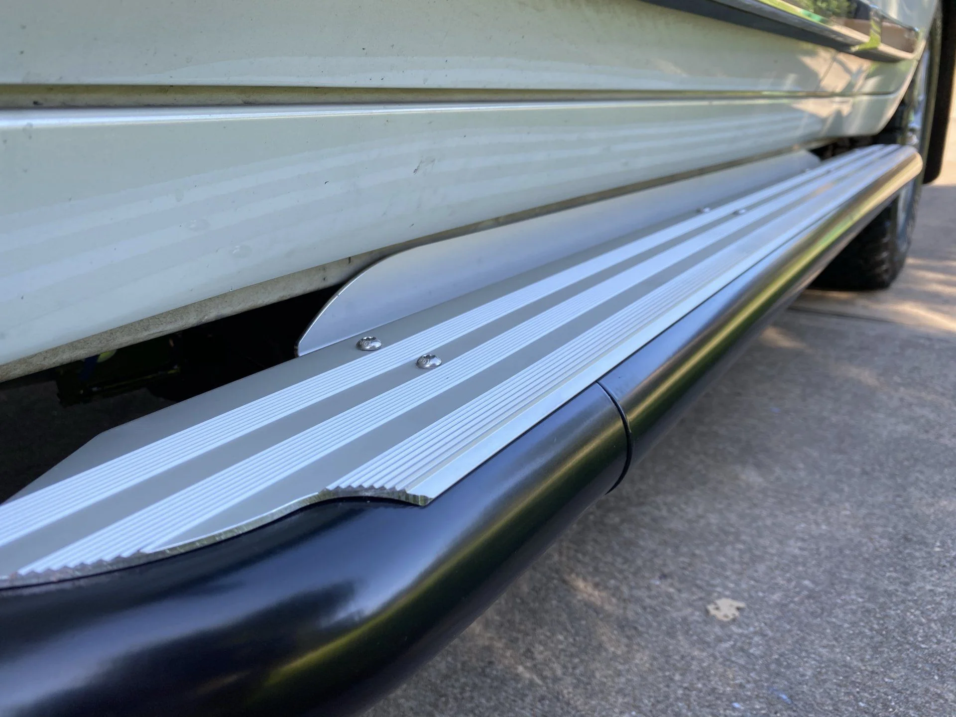

Pics... finally got it installed today 5/14/20.

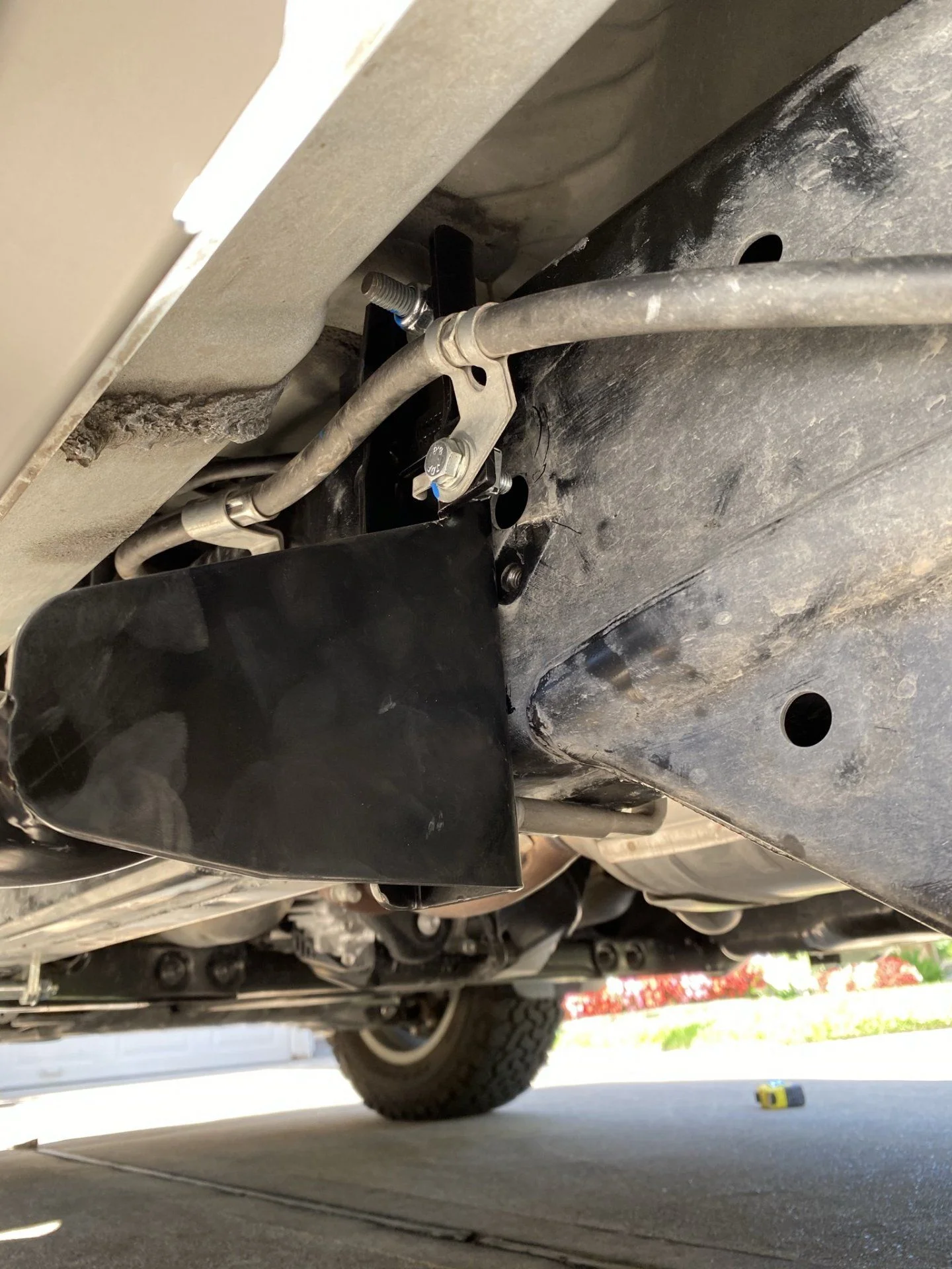

Not sure where you got your information, but I haven’t heard of any slider that requires messing with the KDSS. That’s for lifts, not sliders. I know for a fact there’s no messing with KDSS on Slee sliders. I would think BudBuilt are the same.
Wrong info. Sliders do not conflict w/ KDSS.
Hydraulic line moving around to slide in plate.
Does it put extra stress on the hardlines? That's my concern with both Slee and Budbuilt.
All it is is loosening a line bracket bolt and sliding the plate up between said bracket and the frame, then reinstalling bolt. The line moves maybe 3/16-1/4”, for my MetalTech sliders anyway.
This all happens far from any rigid mounting or line end, so if there is added stress it must be negligible.
Plus many users on this board have been running sliders on their KDSS equipped cruisers for many, many miles and not had issues.
I’m pretty OCD about the down-stream consequences of my vehicle mods and this was a total non-issue for me.
But, more info on the ARB sliders isn’t a bad thing.
It's a couple of bolts. Not a big deal.
Yeah, I was confused. It’s one bolt holding a bracket with the lines.
No, as @bloc mentioned, you remove one bolt to allow the slider to mount between frame and lines. You use same bolt and same hole to screw bracket back down. Not a big deal. When I hear KDSS manipulation, I think loosening allen bolts when working on suspension. Below is a before and after picture from Slee install.

I had the Summit Side Steps on my Tacoma and loved them. Considering them for my LC as well when budget allows. I’ll be very interested in seeing the “gap” between the step and the pinch seam/lower body area. With the factory step, there’s zero gap and it looks very finished.
Definitely a gap. That is one small criticism and thus I held off for a while on ordering it. But all sliders have that I think. Will definitely take pic when I install it.
Any slider that mounts to the frame will need more gap than factory running boards to account for movement between body and frame... of which there can be a surprising amount. Stock steps mount to the body so this isn’t an issue.
Still, good sliders can tuck up pretty tight. Mine don’t hang down past the lower edge of the plastic covering the pinch weld so there is no air gap in the middle, even though the body curves upward there.
