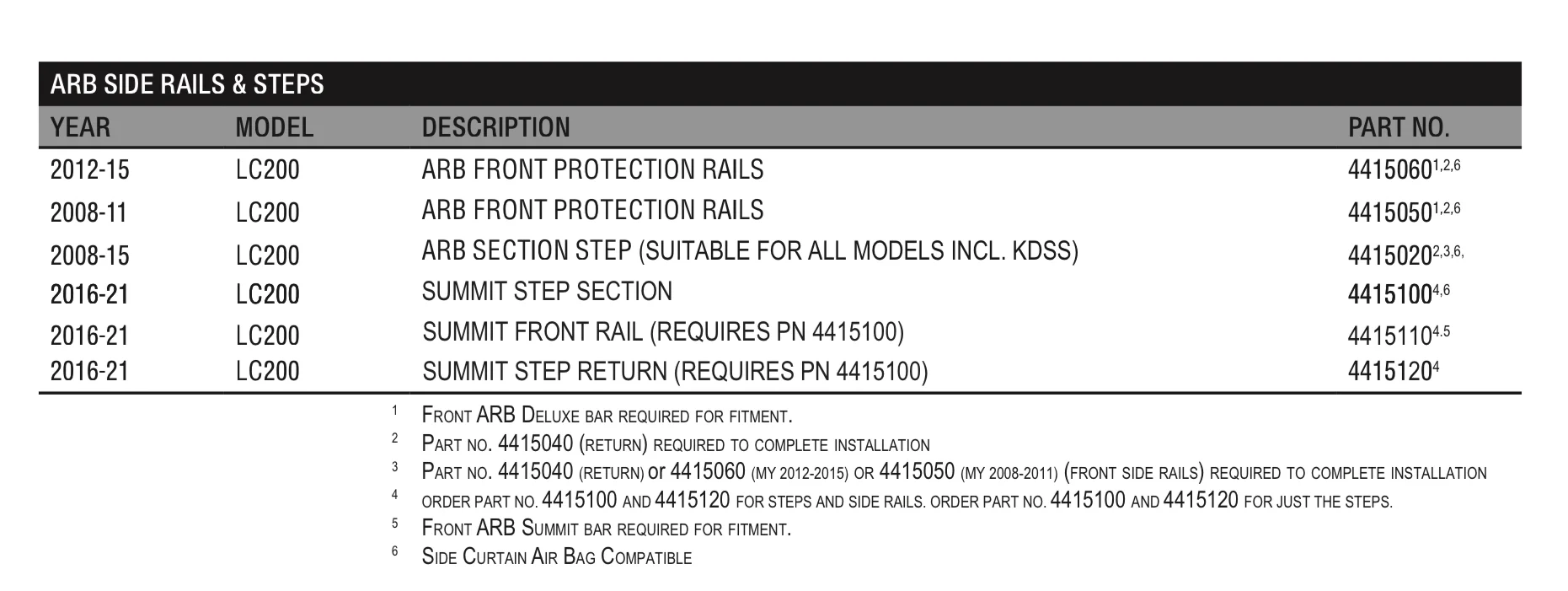

I just looked into availability. Part 4415100 (summit step section) is available from the same place @Madtiger bought his from, but part 4415120 (summit step return) isn't available and they don't have a date for when they'll be in stock. Part 4415110 (summit front rail) is also in stock.
Am I correct in assuming that the step section is the main slider itself (including the frame mounts), the step return is the silver diamond plate piece, and that the front rail is what you would buy if you wanted to connect the steps to an ARB bumper? If so, could I order just the step section for now and then easily add on the step return (without having to disassemble anything) when they are eventually back in stock?

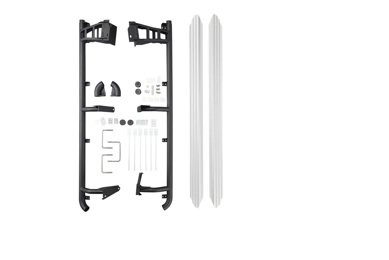

The return is what curves each end of the step back toward the vehicle. This is used when not adding the side rails which attach to the ARB bumpers. The diamond plate comes with the step.
I don’t think the returns can be easily added after the fact, but I don’t know for sure. I had these steps installed on my Tacoma and they were great.
Thanks guys. Looks like I’ll need to wait for both parts to be available then.

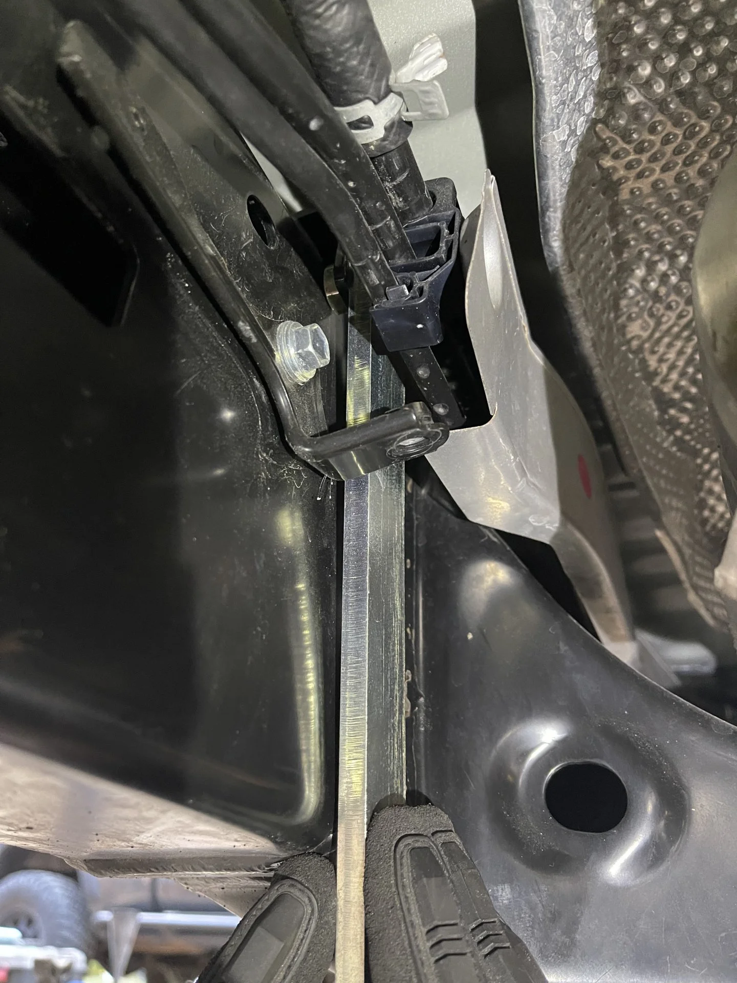

I’ve been under every brand of slider available on a 200. Some are kinda crappy, some are pretty good, then there are ARB slider step things for the 200.
I’ve never seen such a bigger piece of crap in my life. The design feature that really blows my mind is how you have to shove a bar between the frame rail and fuel lines, which breaks the retaining clips for the fuel lines. What?
The front edge is simply bolted on and not sleeves, I can literally deflect these sliders 1/2” with my hand. Garbage.
These are an absolutely waste of money if you are considering them.
These were installed by a 4wheel parts, who also damaged the parking sensor harness and didn’t even bolt down the BP-51 reservoirs to the frame. Which is pretty normal for them.

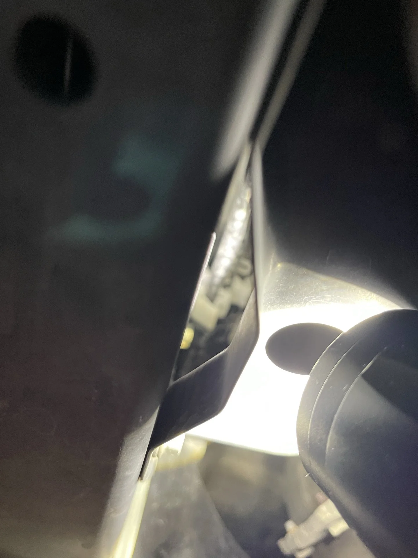

The bar is not close to the fuel lines. See my pic. Sorry bad pic…it was just a quick peek. But I still have retaining clips I think. My fuel lines are not touching the bar at all.
Maybe either this is an old ARB slider model or bad install???
I can get a better pic this weekend if you want.
Ok guys I know this is an old thread but hoping someone might have the answers here. I bought the ARB step and return for my 2020 HE, but after thinking about it I decided to keep that vehicle stock. I am thinking about putting them on the 2011, but. I can’t confirm they will actually fit. I completly understand the idea that the rails would likely not work as the 16’s are the newer body style, but I can’t find and answer on just the steps fitting. I have looked at the instructions and they are basically identical, with a couple expections and they don’t look material. Just curious if anyone has installed the newer version of the step on an a pre ‘16 vehicle? Thanks
I can't see how it could make any difference, since the factory steps fit all models. But i would just call ARB, they are very helpful on the phone.
I don't believe the ARB steps use the factory mounting holes, so it's quite possible what they do use is different on < 2016 and >= 2016 model years.
I tried ARB and they were clueless on the topic. All they could do was confirm that the part numbers for the steps were different. That makes sense as the rail connection is likely different. The ARB steps mount to the frame and since all models have KDSS and there are no frame changes I am aware of I have to believe they will work.
The slee sliders say they fit all years 08+ and they mount to the frame as well.
Guess I might just have to try and see if they work. I can’t see any reason they wouldn’t. I never intend to add the rails so it shouldn’t really matter.
@cruiseroutfit @Taco2Cruiser any idea?
Thanks Christo! Any idea what the difference is?
