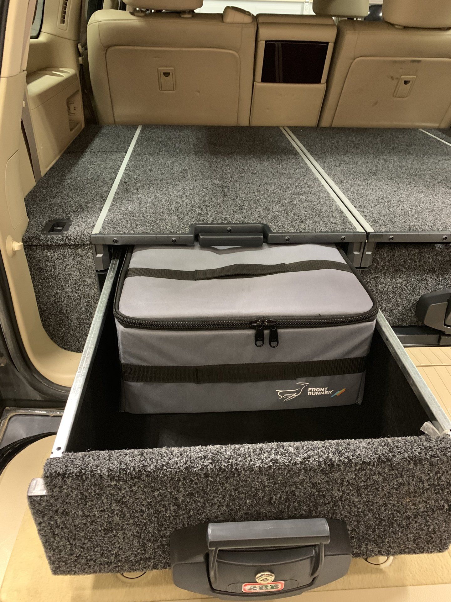

Just installed a set of RFRDs in my LX. All is exactly like the Landcruiser. I am a bit concerned that my RH drawer somehow is binding as it is quite a bit more difficult to open and close both the drawer and floor.
Anyone experience this at first and it work itself out? I haven’t gone for a drive yet to let things settle.
Also, anyone have specific organizing boxes they use to utilize most of the available drawer space? I have Front Runner Cubpacks and the larger Wolf packs but they are too tall for the RFRD.
Maybe the RFRDs reduced the depth an inch because the Front Runner stuff was so close to fitting it was almost like they were made for these drawers.
The Cubpack, which is the rigid box in the attached photo, needed 1/4” more clearance with the lid off. I could hack them up, and 3 should fit perfectly in each drawer, but a lot of what you pay for is lost then with the locking lids and stacking ability.
The soft bag shown needed close to an inch more depth which the Drawer Only model may provide. Had it fit the RFRD, it would have been a great solution.

The metal cross beams under the floor definitely mean you cannot stack to the plywood.

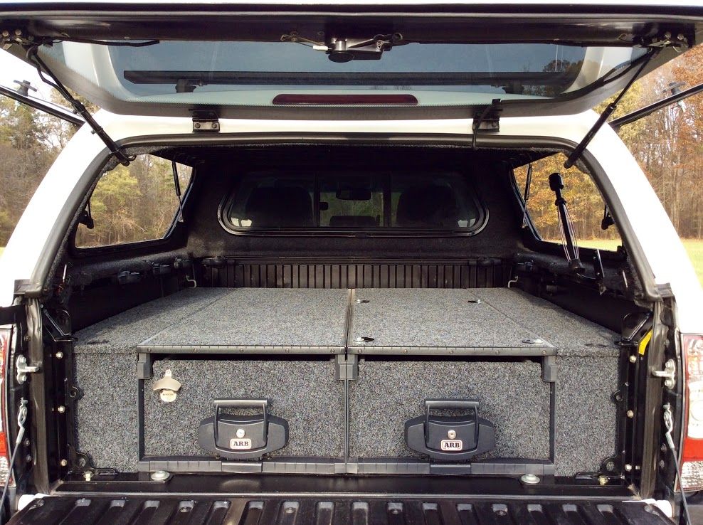

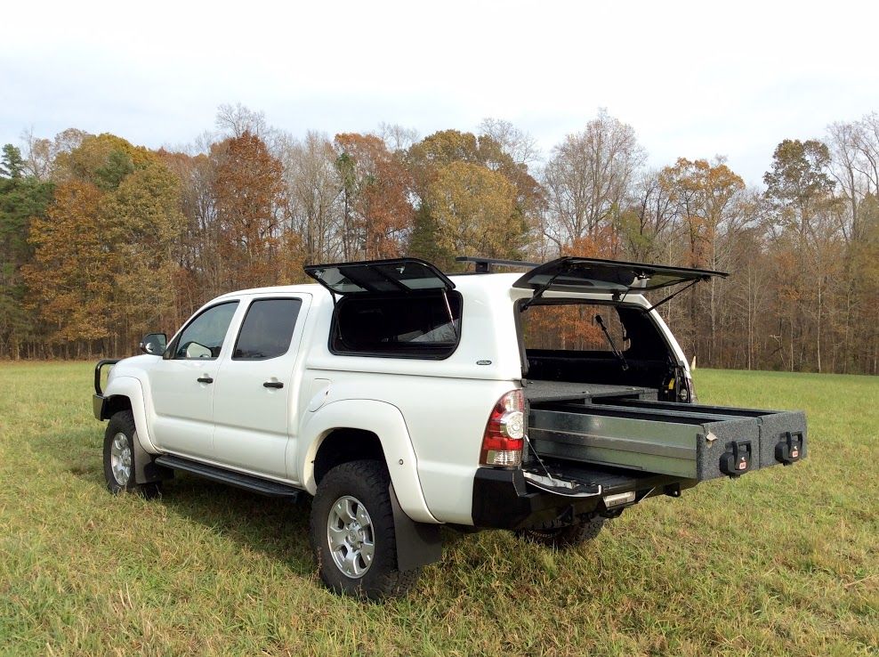

I can confirm the regular 12” high ARB drawer (non-roller floor variant) houses the Front Runner Flatpacks perfectly. I had a set of ARB’s largest drawers in my Tacoma and the FR packs fit the drawers very snug in both width and height.
View attachment 1889250 View attachment 1889251
Hmmm... Never seen 12” tall ARB drawers.
Sleeping in the back would suck and panels would be blocked...but the capacity would be killer.
IIRC, the height of the whole system was around 12” and the interior drawer height was ~8”. I sold the truck over a year ago, so some of the details escape me.
Ah. OK… We have the same drawers. Was curious though because I have often wished for a bit more height.

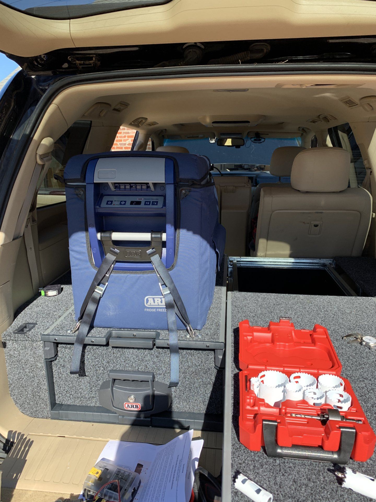

I can’t complain, for the first time ever I have my ARB Fridge tied down and easily accessible with the roller floor. I was surprised how easy it was for me to see what was in it as I’m 5’8” but I think i had the height on the LX on low. It makes it much easier to work under the hood.

Coming up in a day or two! As fast as I’m moving on this thing, I probably should have started a build thread of my own a few weeks back. I installed a Redarc DC-DC charger and the Switch Pros 9100 after getting the fridge bolted down yesterday. Just finished programming the Switch Pros. Thanks to Ben at Slee, awesome product! Lots of crimping, soldering and heat shrink.
