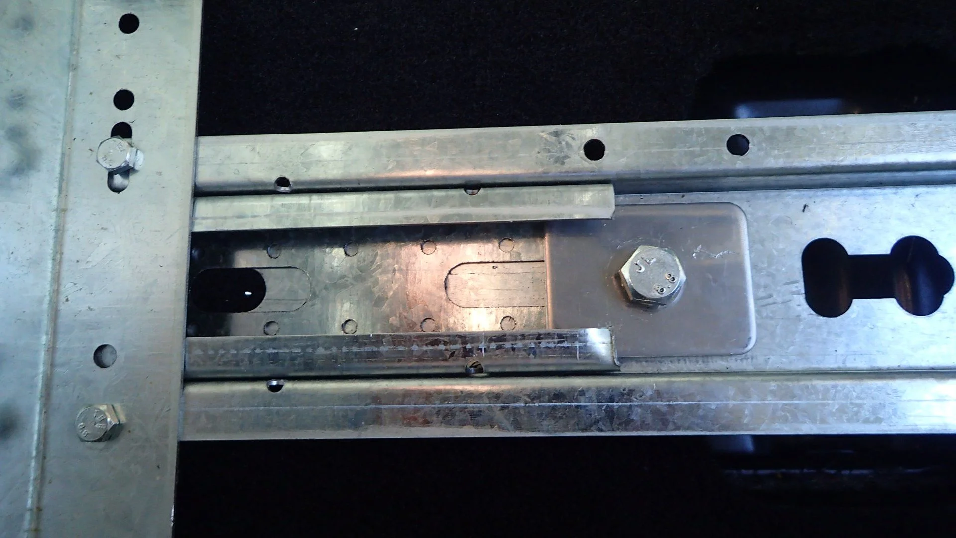

Just FYI ... where you have that bolt with just a flat washer .. ARB provided large rectangular washers with some black foam on one side. The flat rectangular washer/backing plate sits on that cross brace, then the bolt goes through the rectangular washer and the cross brace and into the hole in the floor.
The instructions reference an “oblong washer.”
If I find motivation I’ll switch them out when I do the side trim lol. Thanks for the info
Found motivation to swap out washers closer to the 2nd row. Took 5 min lol. Front ones will have to wait until I do the side trims. Thanks for pointing it out.

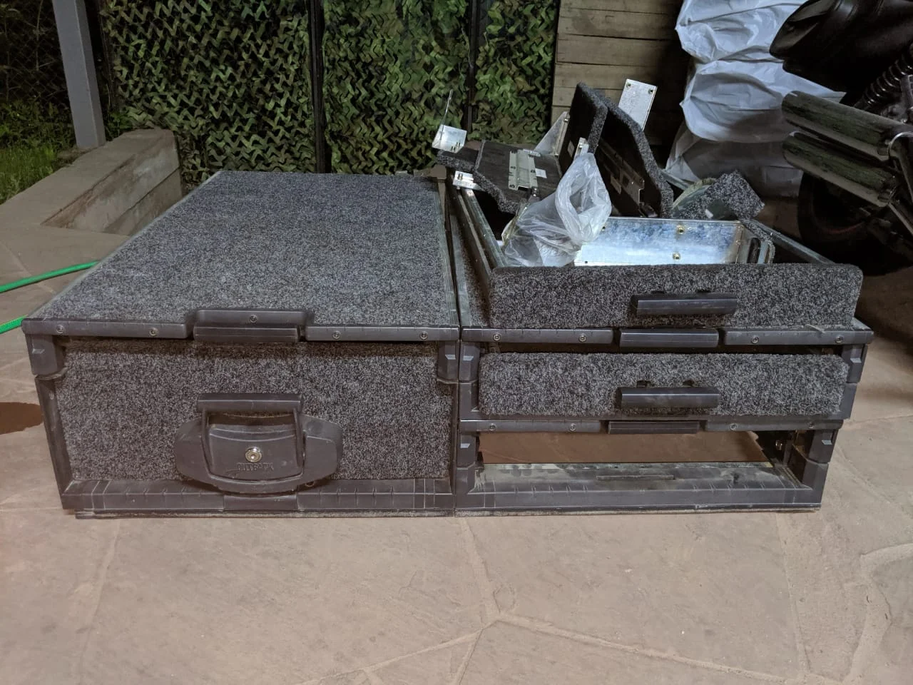

Hi, guys. Just bought used drawers in very strange configuration. Price is very nice and it came with trims. What do you think about to use 2 x rolling floor instead of normal drawer ? This add separation, but also add some weight and steal some space. (sliding part of lower drawer couldn't be used)
