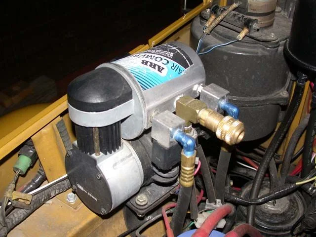

One thing the shop I bought it from said to do was "point the piston up or point the piston down. Do not point the piston any other direction" or you will have all the problems you listing in your first post.

Please post up pictures of where you have this air compressor mounted.....

Please start a thread and post up some pictures of this.

ill have to get some when i get back from vaca....im leaving later tonight and will be gone for 2 weeks. Its a really simple setup, a peice of sealed plywood (for vibration dampening) that is mounted to the track system with a modified stock cleat and then the tank and compressor are mounted to that. That way its easily removable, and zero vibrations in the bed from the compressor running. (i used a powerwinch cable and socket from a boat winch for a power supply so i can unplug it)

Mounted to the firewall - hence the piston is horizontal (not up and down). Interesting observation...
