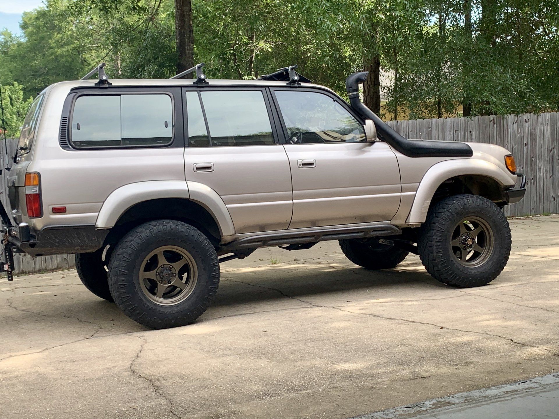

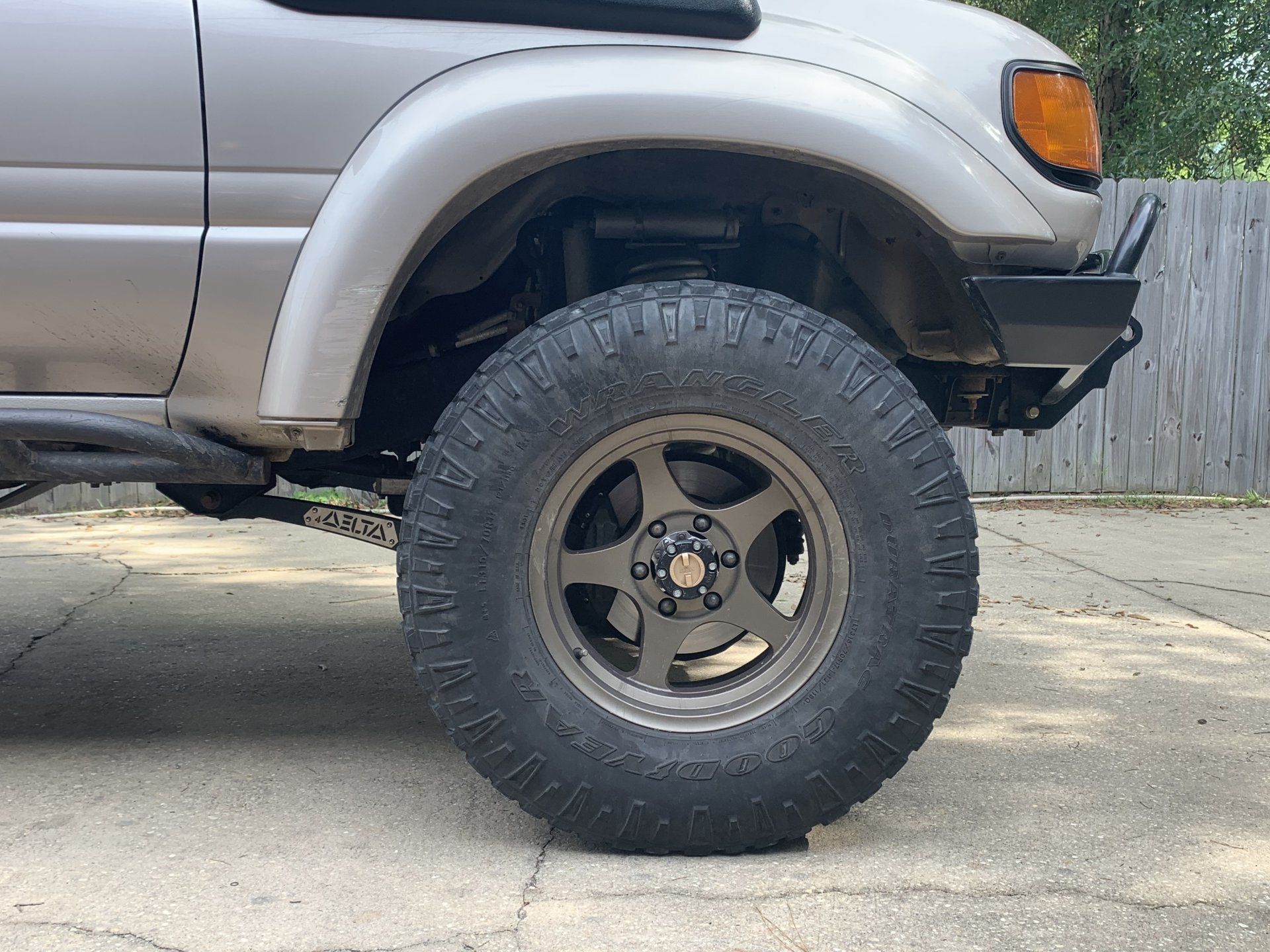

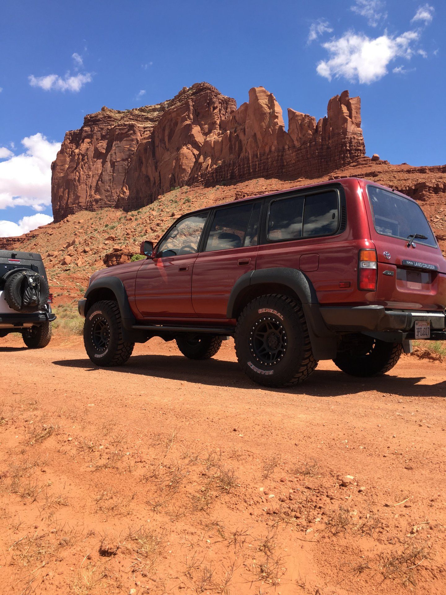

Fuel Vector D600 17x9 w/ 315/70/17 (0.2" smaller than 35's in BFG AT at least--34.4" OD vs 34.6")
I got them secondhand off of a guy on ExpeditionPortal, although they were new in box. They needed machining of the lip ($125 at a pro tire shop IIRC) to clear the hub size.

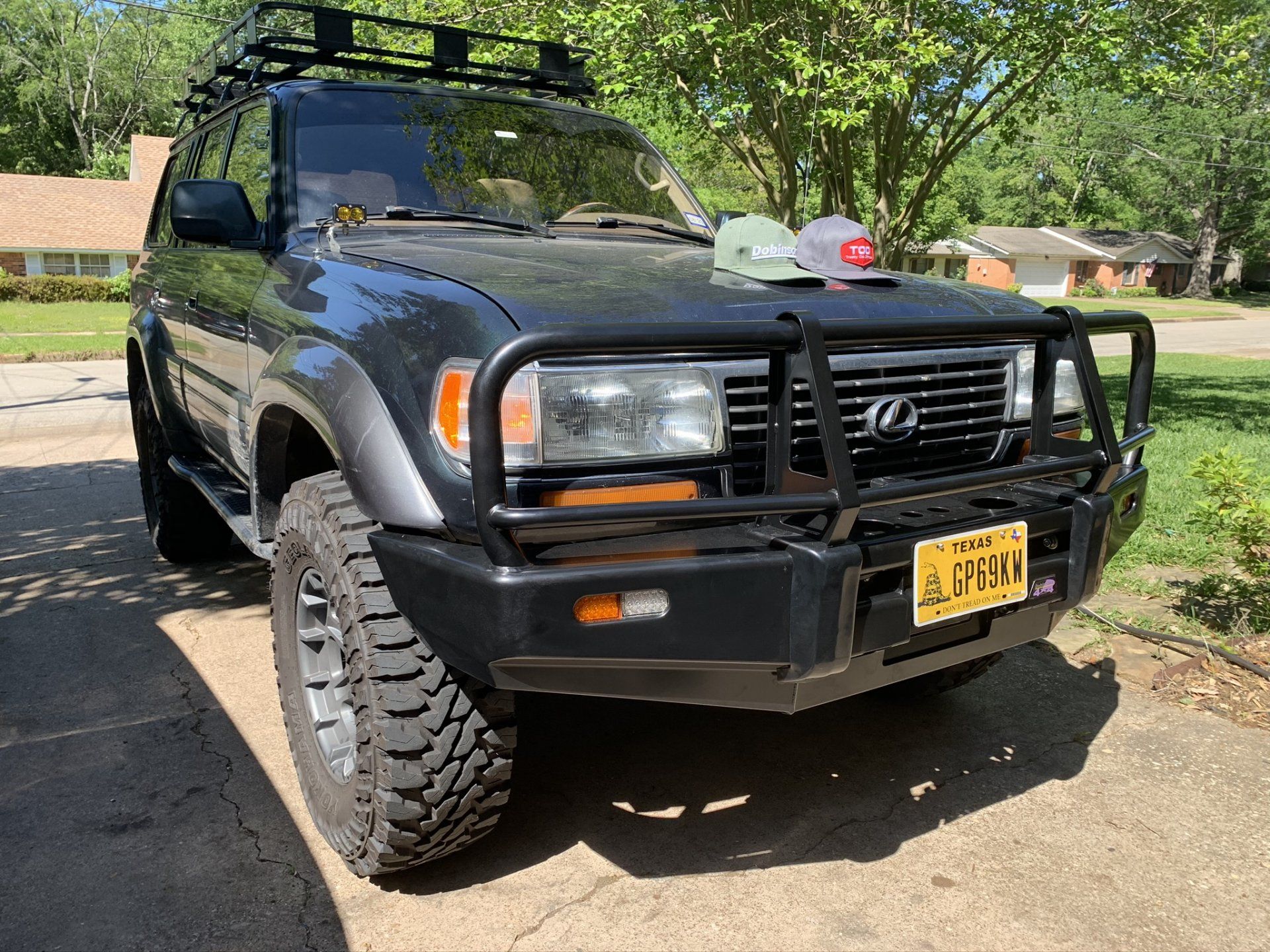

Icon makes Offroad wheels that fit the 80 series backspacing needs. I’m looking at the Icon Rebound, but haven’t ordered yet. Seems like a lot of wheels require spacers, which I’m trying to avoid.
Checkout @Box Rocket here or on instagram, though he is on 37’s. Nice wheels !!

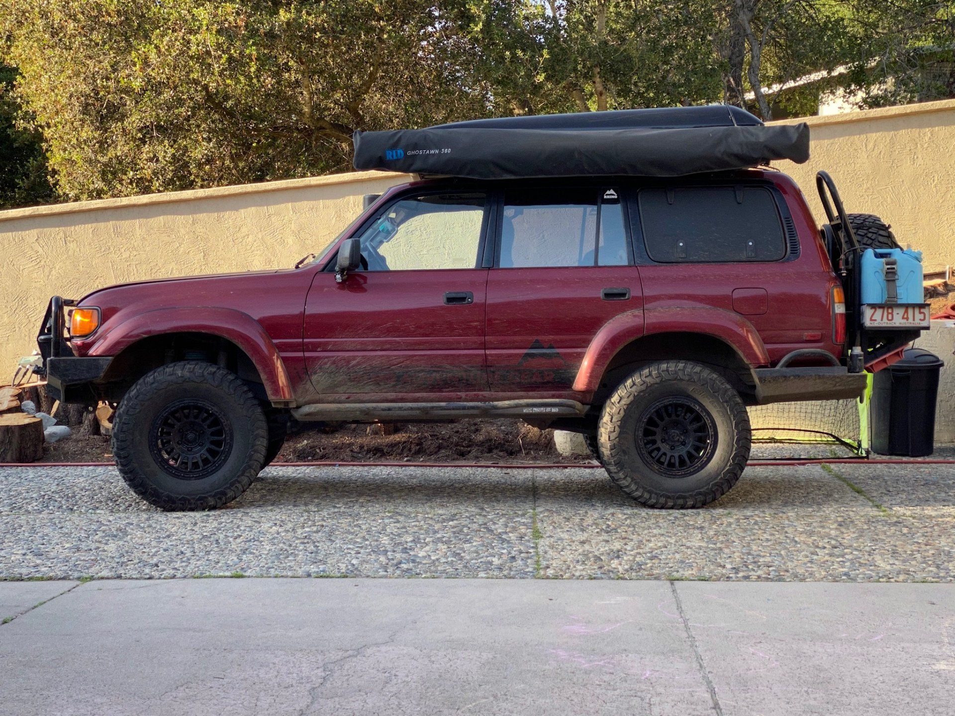

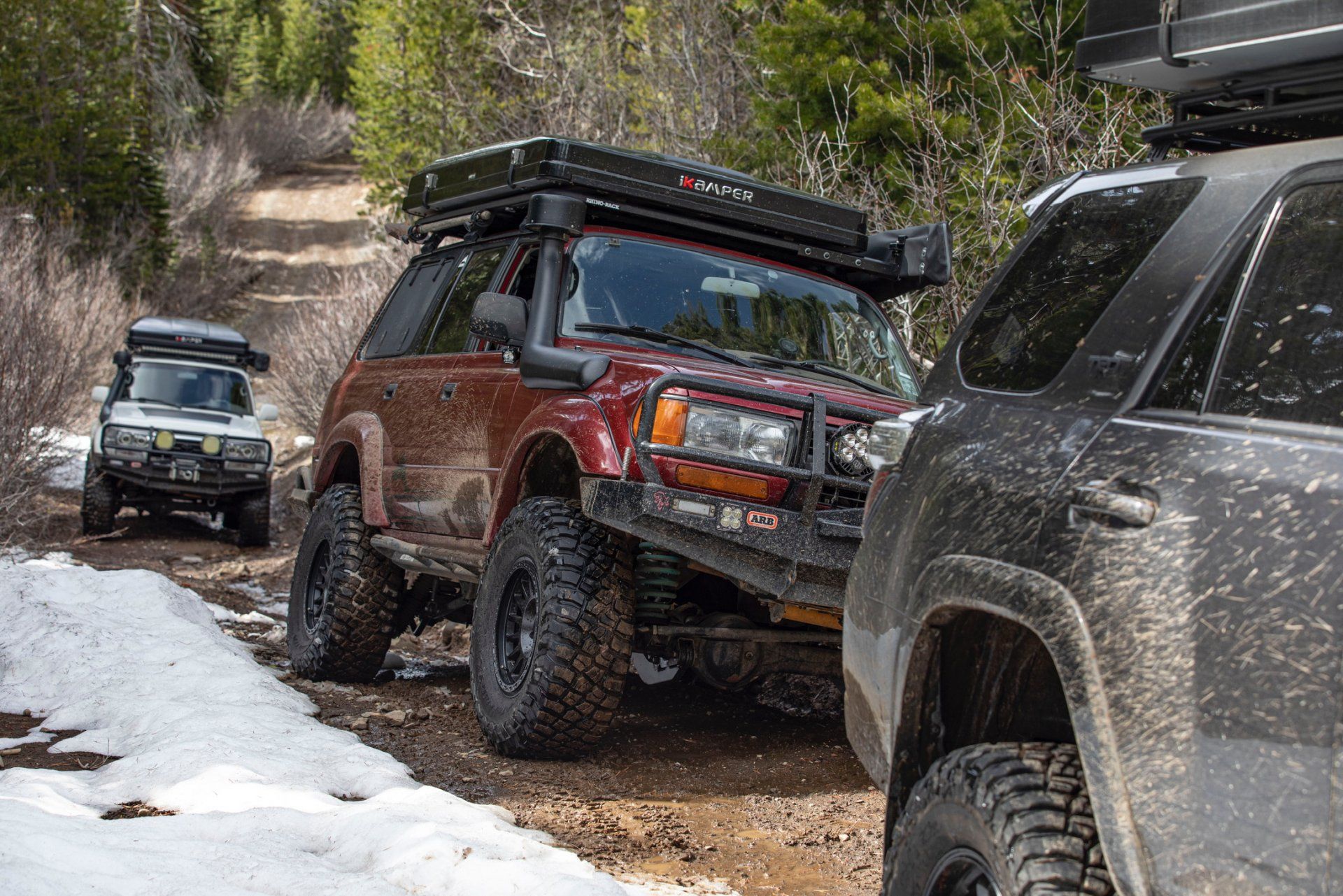

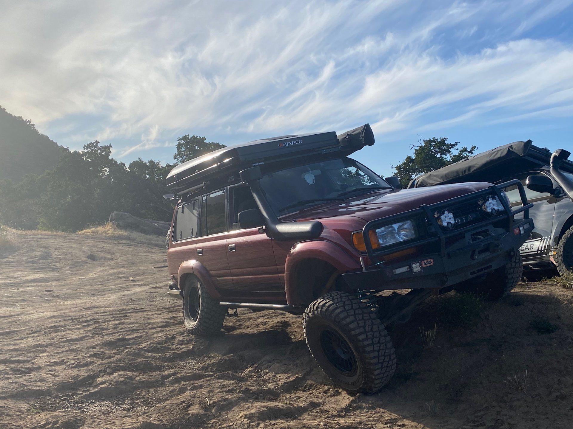

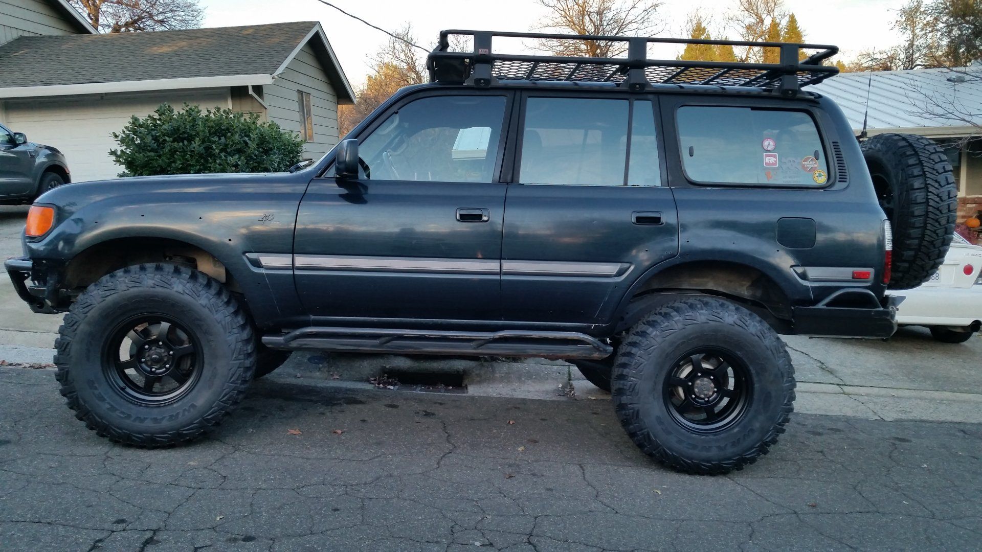

I hate spacers. Looked around a bunch and finally found some 17x8's with -10 offset (FN/Konig Countersteer Type X), which I hope will minimize rubbing. Wanted the narrow width to keep the beads tight when aired-down to single-digit psi with 37x12.5 MTRs.
I had the hub hole bored-out by the supplier's go-to machine shop to eliminate the center cap lip.
The tires and wheels are sitting in my garage waiting for some suspension tweaks and a regear (*$igh*), but I did manage a trial-fit and got a few pics when first received. Anxious to get them on the trail.

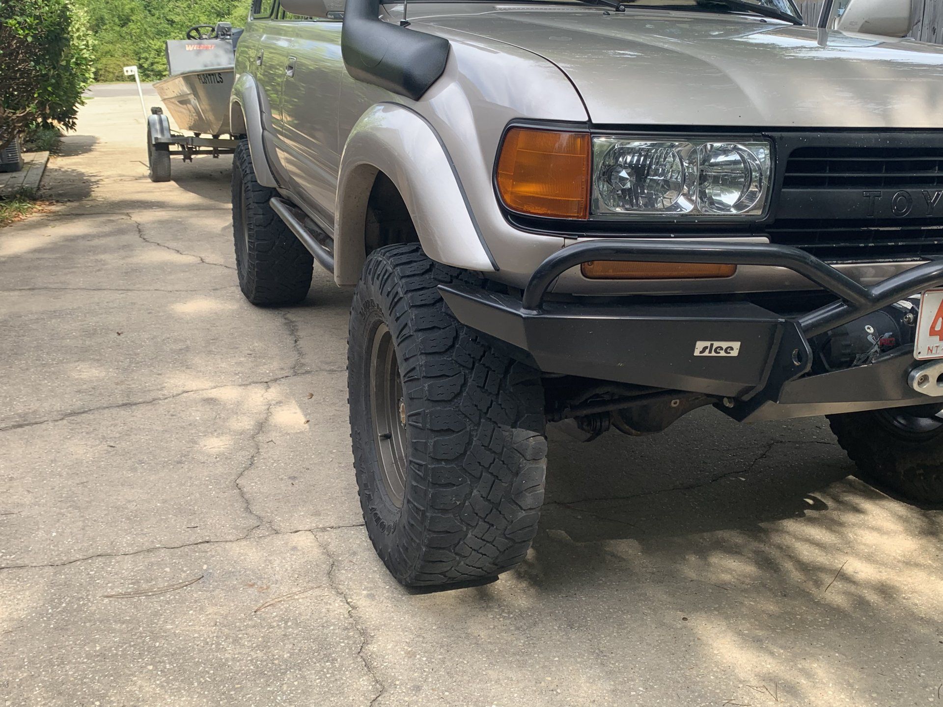

315 Yokohama G003 MT

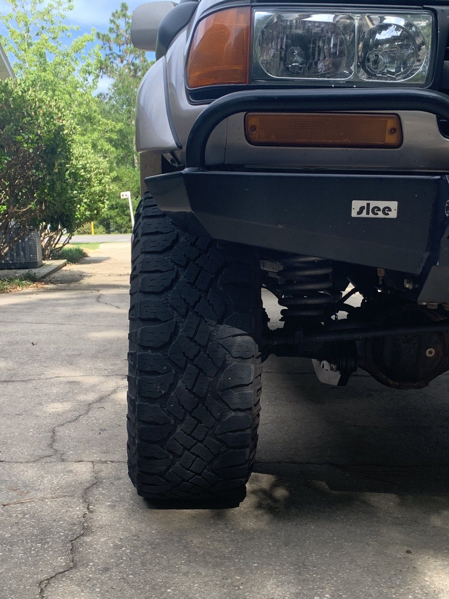

Sorry, can't believe I didn't take any straight-on pics front or rear...this quartering shot is the closest I have. Slightly more poke-out, but not much.
I was shooting for a small bit of additional width to help with rubbing at full stuff with 37x12.5's, as my current set of 35's (315/75R16's) scrub the frame (rear) with the 0 offset factory wheels. The rubbing is harmless with the 35's, but I didn't want to try 0 offset with the taller and slightly wider 37x12.5's.
Given the stock 8" width, -10 offset, and when compared to factory rims, any tire on these FN's will poke-out an additional 0.4", so not much change in track width. Pretty sure they'd still be flush or sit inboard if you are running factory flares and 315's or 12.5's.

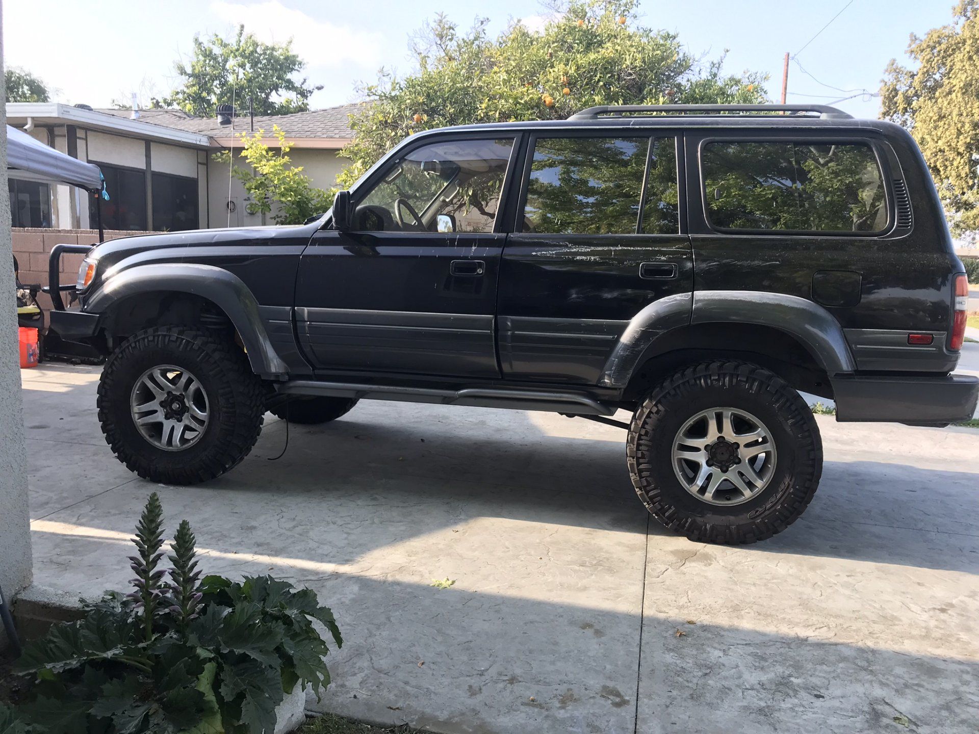

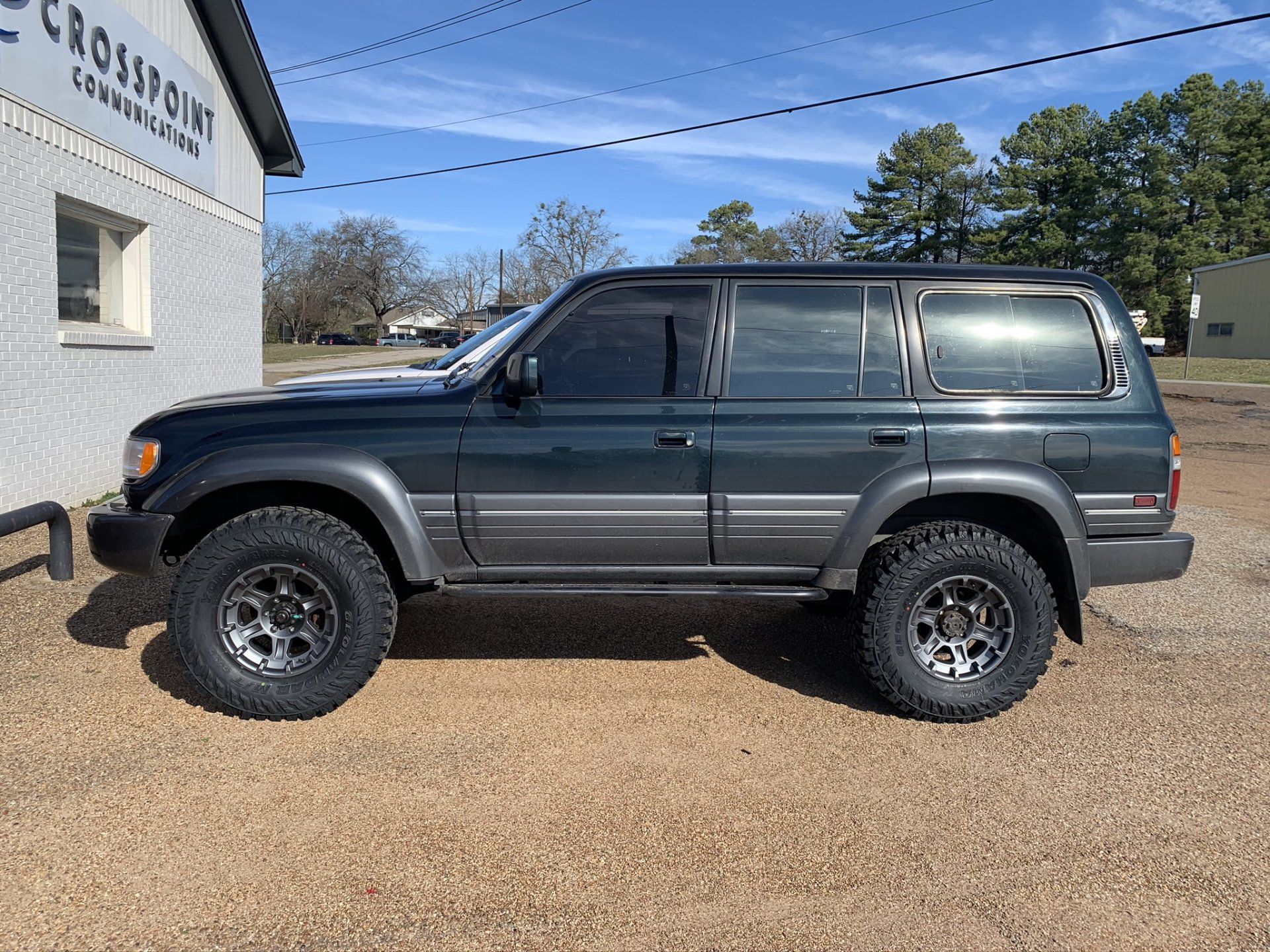

Running 35s on 17s I think -25 offset works great! No rubbing in the fenders and am not running bump stop spacers. I wanted to ditch my wheel spacers with my OEM 16s and 315s, so now running a negative offset 17 and really like it. These Relations Race Wheels are beadlock hybrids and weigh a little more than OEM, but my truck weighs 8000# and really wanted a heavy duty rim with higher weight spec. they come in the proper 106.4mm hub bore but needed small clearancing at the outside of the bore where the center cap fits. I used a router and flush bit to do it.

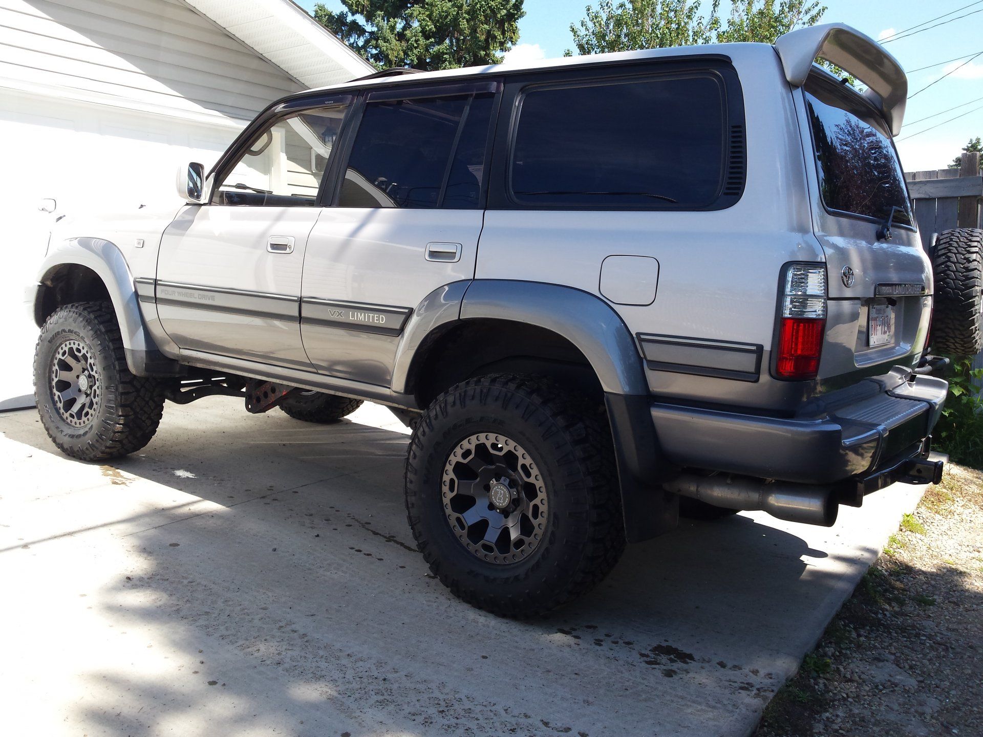

Here are my 17x8” -10mm FN Five Stars. Begging for 37s
(The center-bore will need center cap lip removed.)
