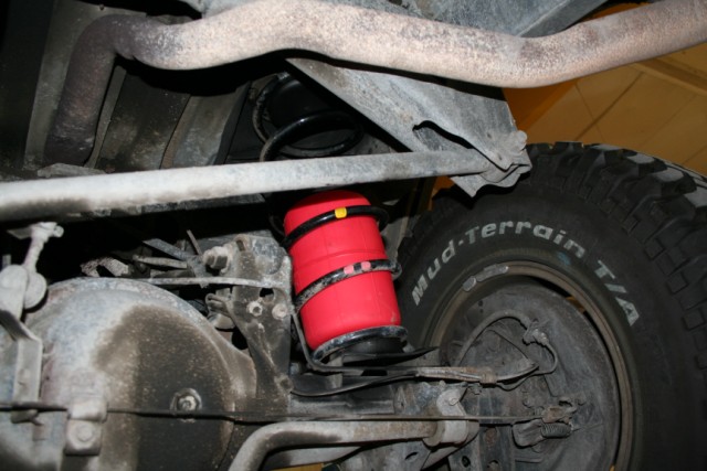

Now that I see the pics, I think I used your thread to complete the ones on my truck back in 2015.
I chose to join my air bags together on a single fill line so they always run equal pressure. I prefer the feel during operation for that. I have not experienced the lean as much as it would bug me having one side a few PSI off from the other, as it make the rear "wiggle" when driving.

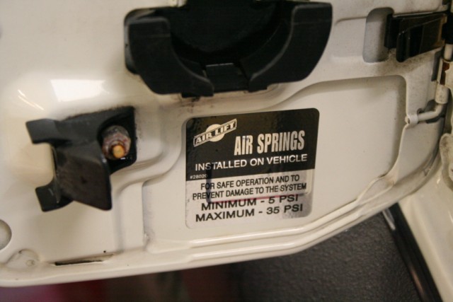

I didn't get a sticker with mine about the pressure. Disappointing.
I was told by their support that 25 PSI was max........after I blew a bag at 30 PSI and it squeezed out between the coils.

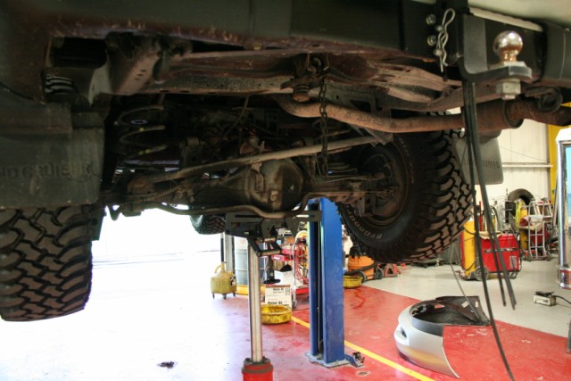

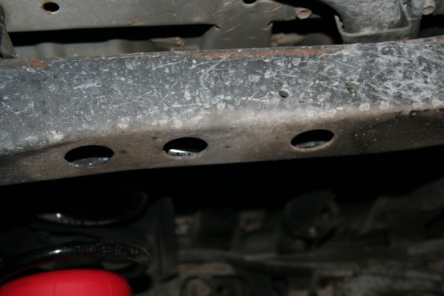

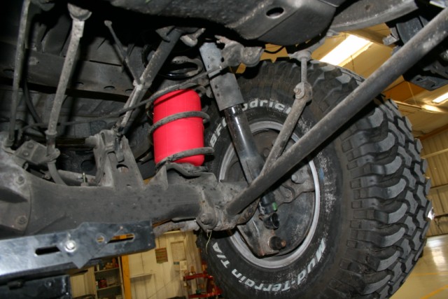

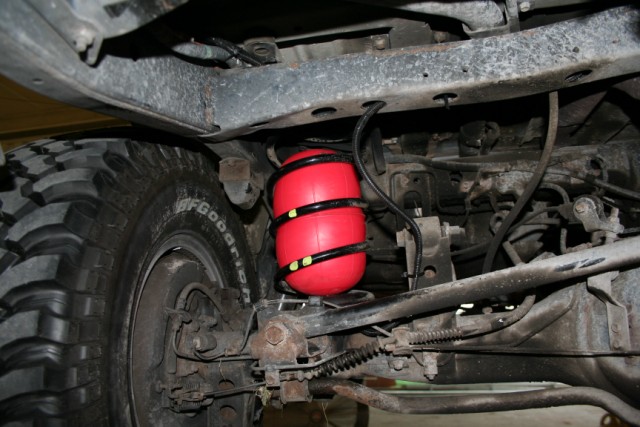

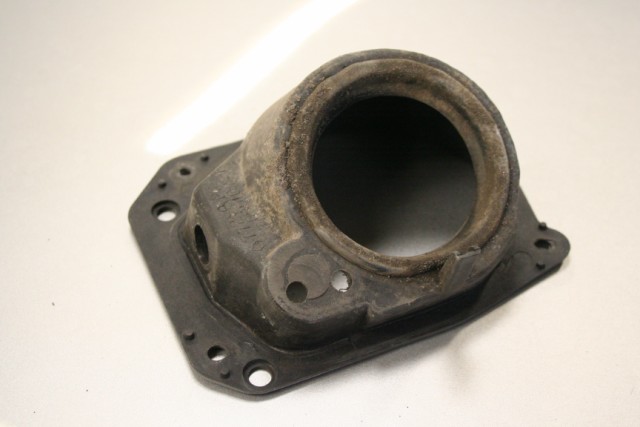

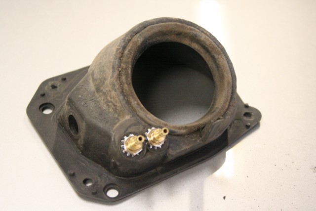

Thank you @98 SNAKE EATER ! I can see that I'll use your pics as a reference when my airbags arrive for installation. Thanks for your efforts! I've been considering running the fill lines out the top spring perches to keep them out of harm's way and simplify the routing. Your pics sure help to evaluate that ahead of time! Too bad they don't provide a 90 degree fittings. I wonder if maybe I could find 90* fittings that would work at say, an Ace Hdwe store?
Just run them out the bottom per AirLift's instructions. They know how they're supposed to be and you already have a bracket with a hole in the bottom that is MUCH easier to deal with then trying to take them out the top.
The kit comes with all the parts you need.
The existing hole in the bottom spring perch has to be drilled out to avoid chafing anyway, plus routing the line(s) will need to be considered, so either way has it's own challenges. A hole drilled out in either spring perch is basically the main modification needed to the 80 suspension. Thanks for your opinion, though. I still contend that a 90* fitting would be useful - either way. How flexible is the line they send?
Very flexible line.

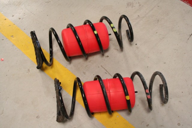

Gravity will eventually settle the bag in the bottom of the spring, leaving the line exposed on the top so when it does get compressed, it will pinch the line.
I've had mine in for 5 years with regular use and have had no issues other than a blown bag which was my fault.
I have this same setup on my '97, following the variations @BILT4ME describes and with the parts provided in the kit. I also plumbed the bags to a single air input/fill fitting and also ran the hose from the bags out of the bottom and in my case I didn't need to drill at all and haven't had any issue in a few years of use.

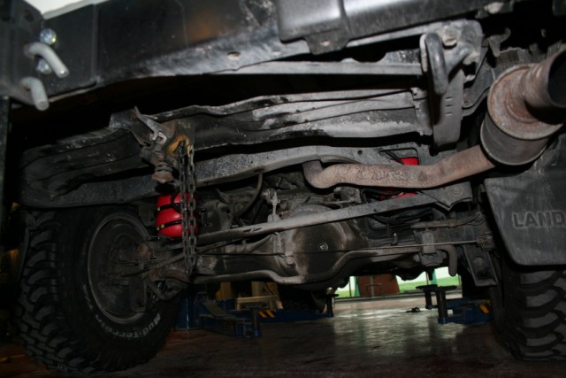

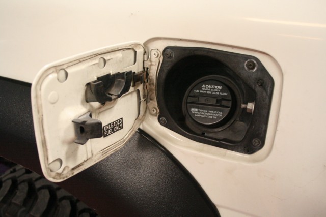

I routed my lines on the rear upper control arms, then over to a tee and up to the fuel fill area. I made sure to leave a full loop of about 2" diameter at each corner to allow for flex and stretch during articulation. I loosely zip-tied the sections together to allow them to move over time and not fatigue.

Did you ever hear back from Airlift about routing them out the top? There is a Coil Rite video on Youtube where they route them right out the top, but the bags seem to fill up the entire spring length, so no settling. I'd much rather put them out the top if possible.
Figured I'd add, I recently installed the firestone bags from SD truck. and proceeded to tow an MG from MA--CO. the air bags helped tremendously and kept the 80 nice and level definitely worth the $100. I ran the lines out the bottom and did not open up the hole. The hose went through without issue and I dont see how a larger hole is going to change anything as the hose will rest on the edges regardless.

No, I've not heard anything. Yeah, I agree - top seems more protected. This thread mentions Airbag Man air bags out of Australia. CR5052HP is what you want for 2.5" lift with the protective sleeves. They're run out the top, made by Firestone and with the protective sleeves look to be more robust. Definitely more expensive, too.
