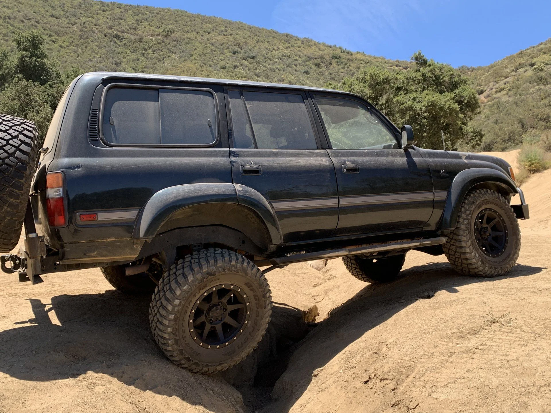

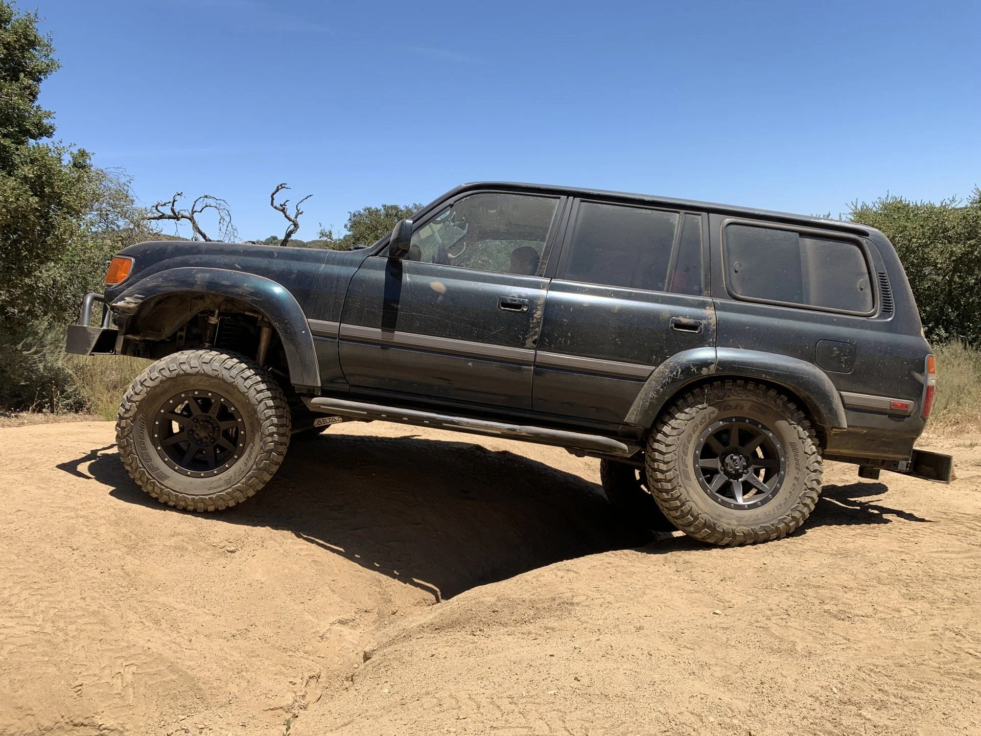

No disrespect intended, but your poser shots don't help much......You never posted the results of your playing in the rocks. How'd it go?
Still haven’t done anything crazy but articulation does not seem terrible. I went to Hollister hills a month ago and I experienced no real issues.

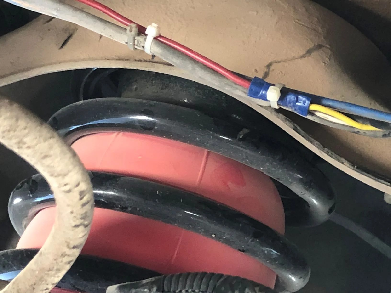

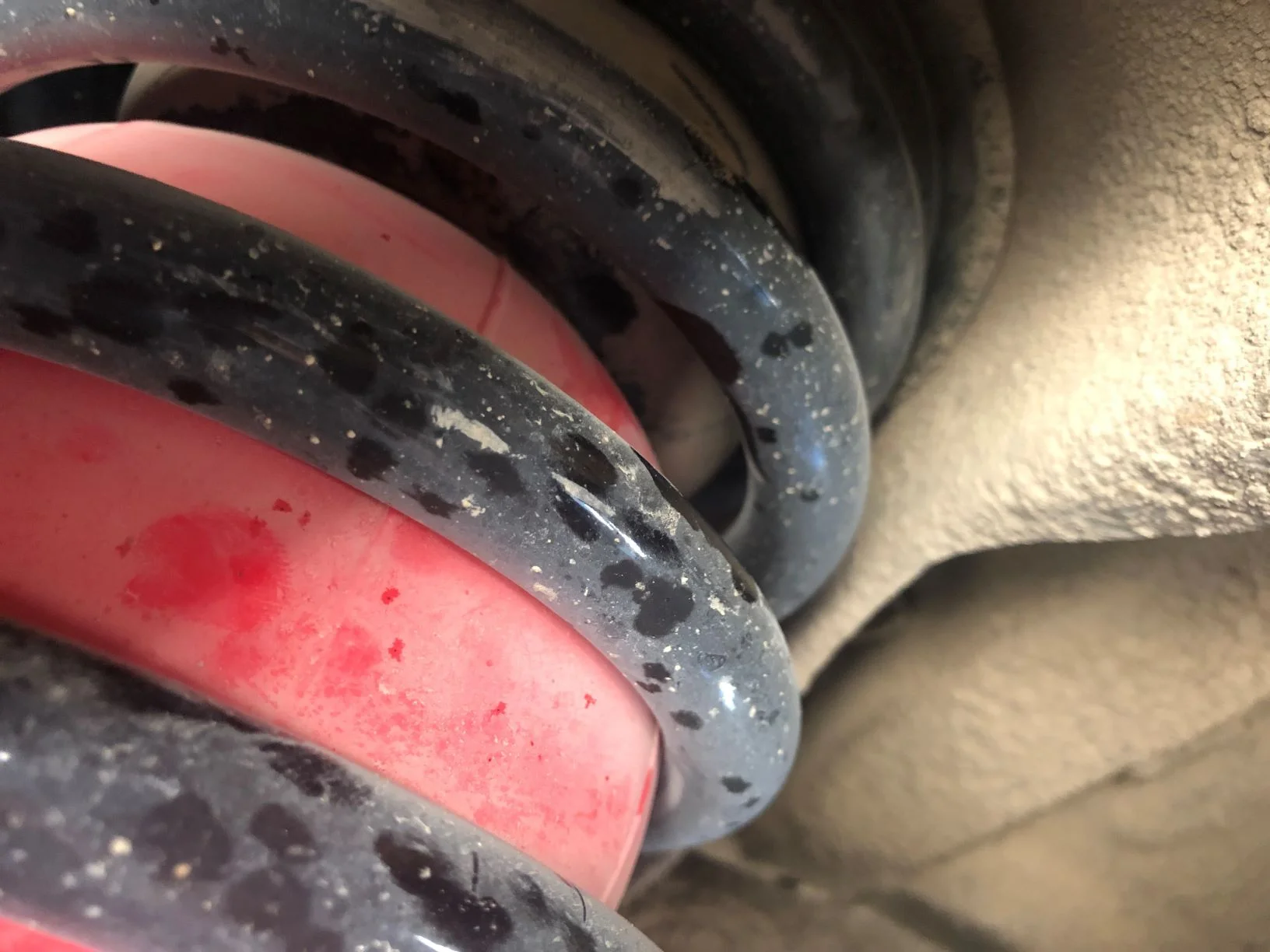

So I crawled under and looked at the top of the bags. These 2 pics are with a full 24 gallon aux fuel tank with no trailer tongue weight or additional camping gear and 10 lbs psi.....
Passenger's side:
Driver's side:
The tops of the bags are touching the top spring perch - I can't get my fingers in between bag and perch. The shape of the bags prevents contact with the last available coil, at least at 10# psi. I can't see that a longer bag is needed for my 2.5" lift. Maybe with a taller lift like a 4" or 6", but for the shorter lifts IMHO, I think the stock bags should be sufficient. Just wanted to share this and put it out there for debate.
Edit: I should also note that bottom of bags are resting on bottom spring perch, so the bags contact both top & bottom perches as well as the coils.
