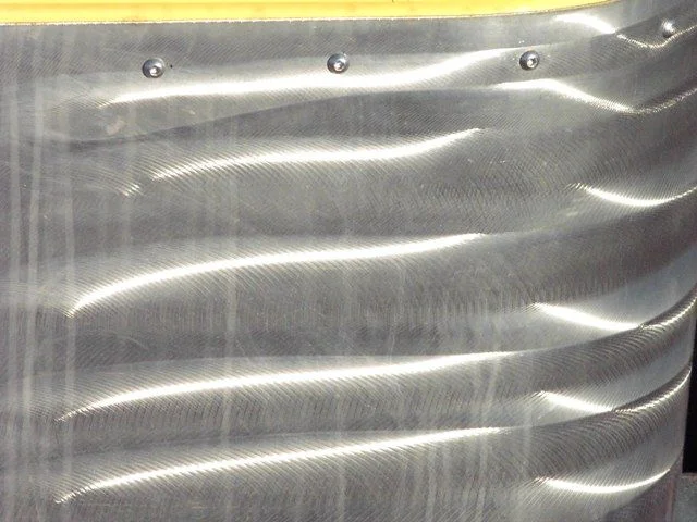

He had them in stock last time I spoke to him, 2 weeks ago. The corners aren't radius but it is hard to tell they are not. They 3/16" thick. If it is a trail truck it doesn't matter. If you want it to be a radius put diamond plate over it.
Contact Bud about shipping, they are heavy, and price. I haven't bought a pair but am considering them.

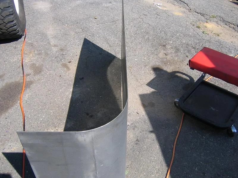

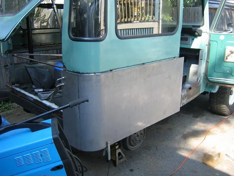

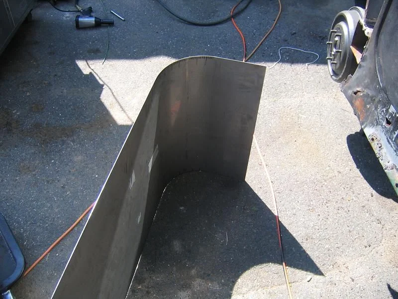

I'd second any local sheet metal shop. I did these myself. I used about 16 guage or so (I don't remember) stainless. I just used heavy paper and cut a pattern that I wanted. Then I transfered to the sheet of stainless and cut it just a little big with a plasma and cleaned up the edges. I used small hex head machine screws with nuts/washers inside to hold em in place. I bent the radius myself without a jig simply by eyeballing it. Stainless is pretty stiff, so I think they will provide pretty good protection and you could get similar protection from a thinner sheet. And they'll never rust! I wanted something unique so I gave em a brushed look with a sanding disk. I think you could do something similar for your corner and side panels. I did these cheap 'cause I got a big sheet of stainless a guy at the steel yard dropped on it's corner for $100. I only used a small portion for these corners, but I think one sheet would be more than double what you need.

Pete, THANKS! that is what I was looking for! ...ummm what do you mean they are not radious, they look pre-bent to me:confused:
They appear to be step bent. You can see it if you look at the picture.
JC he means that its not exact toyota spec. the radius of the bend is either more or less.

Its a 6" radius. Any metal shop with a brake and competent operators can make them. If you're looking for an arc to follow for the outside edges of the quarter panel that wrap towards the front, you can copy the arc from the bottom of the hard top nearest the hatch.
