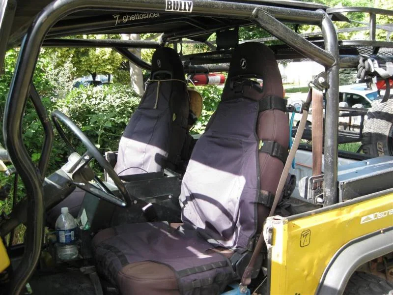

i have those in mine and i used their sliders that was simple. i had to drill the holes in the sliders to mount the seats. the cage i have has bars to hold the sliders. heres a picture. if you need more just ask. if you look at the roll cage look at where the seats go you will see the craddle. you asked if the pass seat needs a slider, well neither one needs a slider if you dont need adjustment. the sliders they offer are basic and easy to make work. but you can use any slider you want. you just might have to make work

Perfect! I like how you suspended the seat cradle from the bar behind the seat. That's one solution I was in need of...

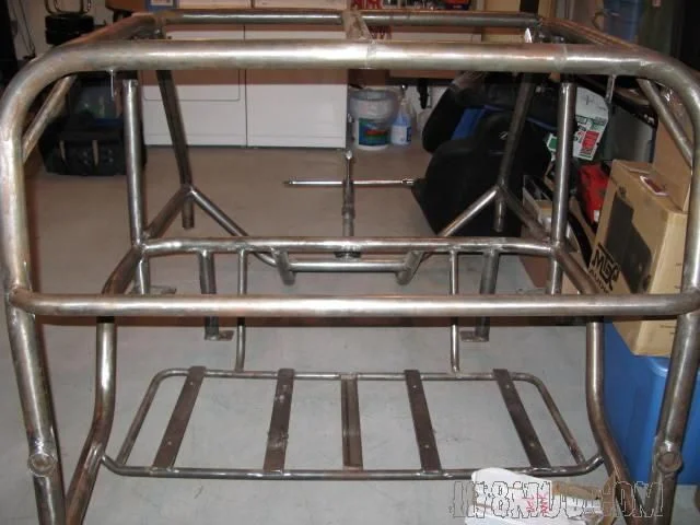

have the moabs with corbeau sliders on both and corbeau mounting brackets love them and i would for sure put the sliders in you get alot more room. hope the pics help. need more let me know ill try to get better ones

Thanks to all - both the link and the pics helped immensely. Better understand what the products look like and how they mount.
