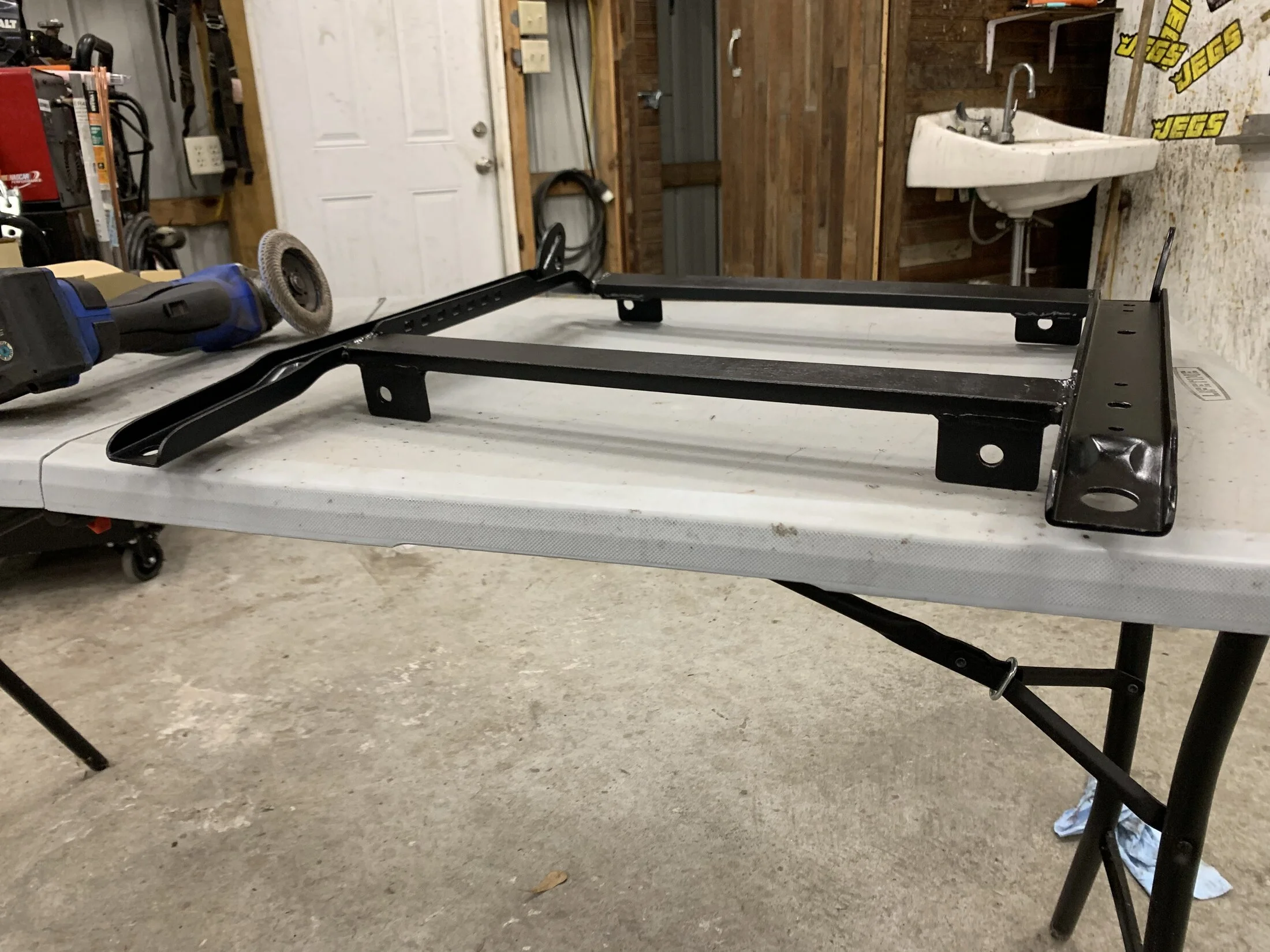

I have a pair of these seats with the Corbeau mounting brackets. Its been a while, but as I recall, I had to mess around a bit to get the passenger seat mounted. Also, the passenger seat sits about 1.5" higher than the driver seat. I think they offer a spacer to get the driver seat to the same height. I can try to get some measurements tonight. I did not get the heated seats, but I did get the option for the lumbar support. After the first off-road trip, the bladder for the lumbar support is now diagonal and I have not tried to get it repositioned. I wouldn't order that option again.
Got pics of the seats sitting on the bracket?
How about a measurement from the bottom of the bracket to the seat top?
👍I'll be in the shop today. Will post up pics a bit later.

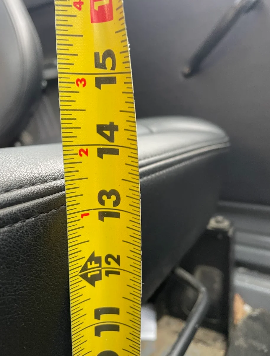

Tape is measuring from the interior floor of the truck.,,

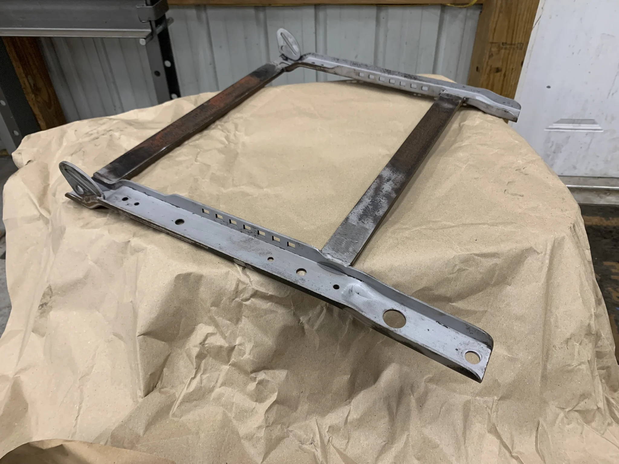

Just as a data point as I know they are not in the running. The Procar 90s on their sliders and my homemade mounts:
^The front could be dropped a bit, but I like the thigh support.
Damn, I thought they sat a little closer to stock height than your measurement. Interesting.
That essentially eliminates those from the list.

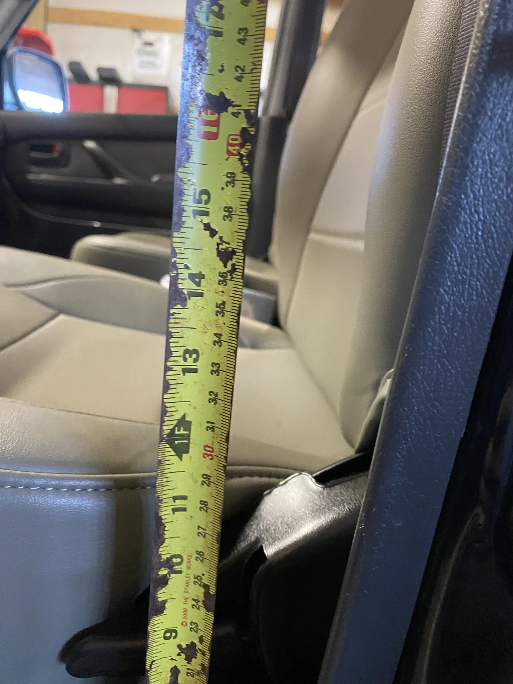

@GA Architect any chance you can pull a tape on those seats of yours?

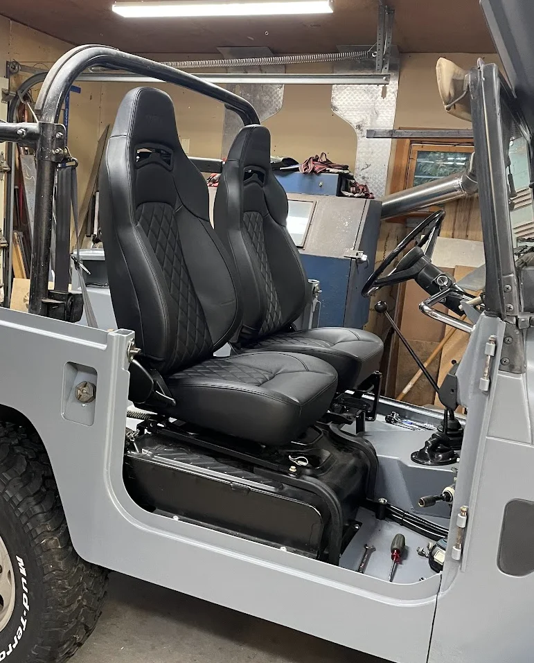

FWIW, I think getting seats that position your butt as low as the stock Toyota seats do is more difficult than one would think. I went down a somewhat similar path about 18 months ago. I asked the ‘Mud brain trust about FJ40 seats. Interestingly, you were one of the folks to chime in. Here’s a link to that thread:
As I posted, I ended up purchasing a set of Scheel Mann seats, as recommended by forum member jomelo. He kindly provided some pics, as well as his thoughts. Based upon the build thread of his FJ40 (as written by wngrog) my impression is jomelo does things one way; the right way.
Due to other project constraints, as well as the complexities of life, the seats have yet to be installed. I will caution you Scheel Mann seats are in the OMG expensive category. As I posted, I can suggest Metal Tech in Oregon as a great source to buy from. Outstanding customer service, and they offer a military discount. Living in Montana it doesn’t help you, but no sales tax in Oregon.
Well crap, that's pretty on par with the OEM height.

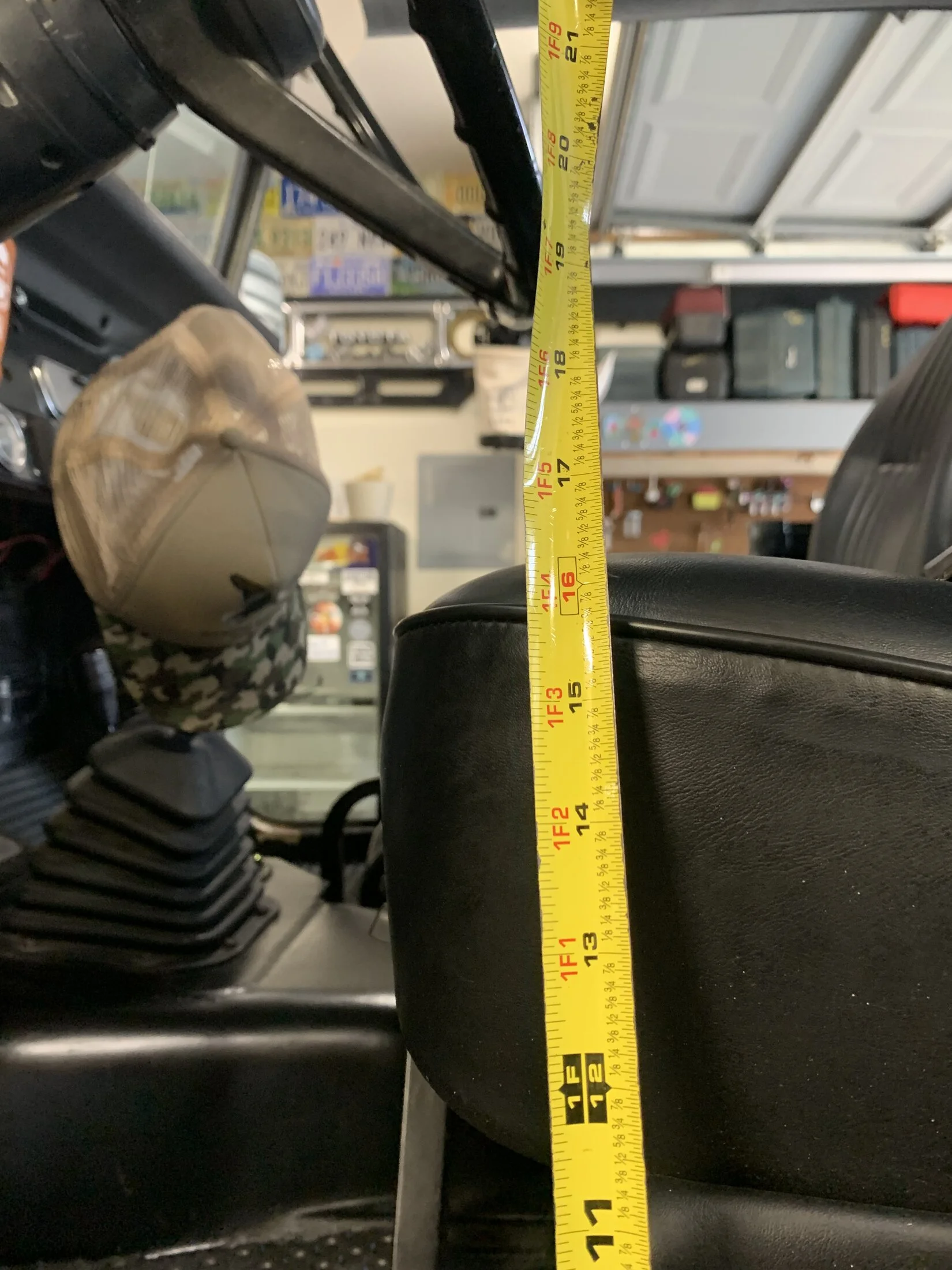

@GA Architect what's the passenger seat tape out at?
