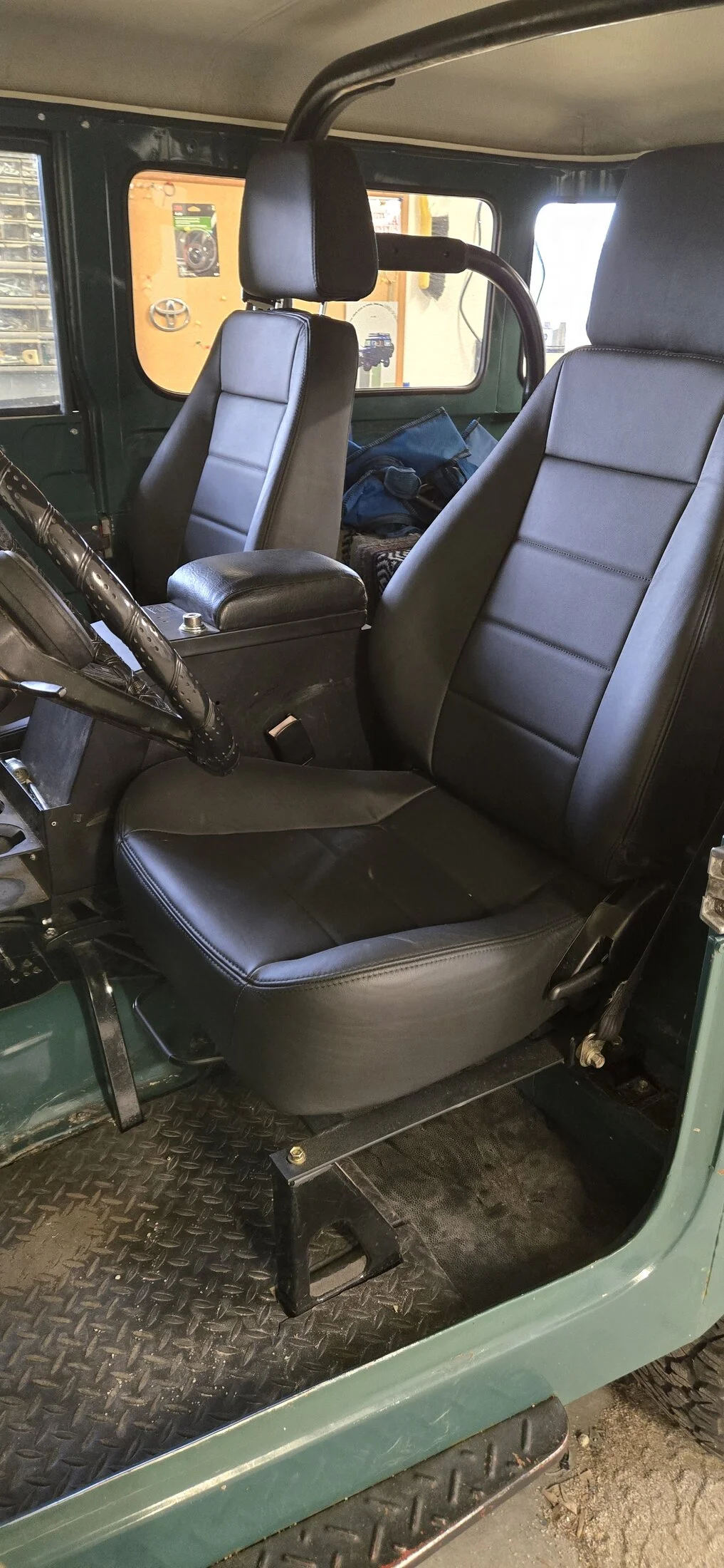

I removed the sliders from mine on the passenger side, I took the time to find the sweet spot before I bolted them down.
It did save an inch of height.
I'll follow up with more info later, measurements and thoughts.

Nothing that's made me change my ways, I can say I've noticed the clearance is a little closer than OEM, but nothing that is a deal breaker.
Steering wheel clearance. Approximately 7".
Floor to ass. Approximately 14.5" at the front section of the seat.
Floor to bottom of seat, above slider height. Approximately 9.5"
bald eagle measurements.
Passenger seat without the sliders bracket sits pretty close to 8¾" to the base of the seat. Actually sits lower than the drivers seat.
14ish to the top of the leading edge of the passenger seat, again, this is with the slider bracket removed, using the Corbeau seats frame adapter.
That might be as close to OEM measurements as we're going to find with a commercially available aftermarket seat.

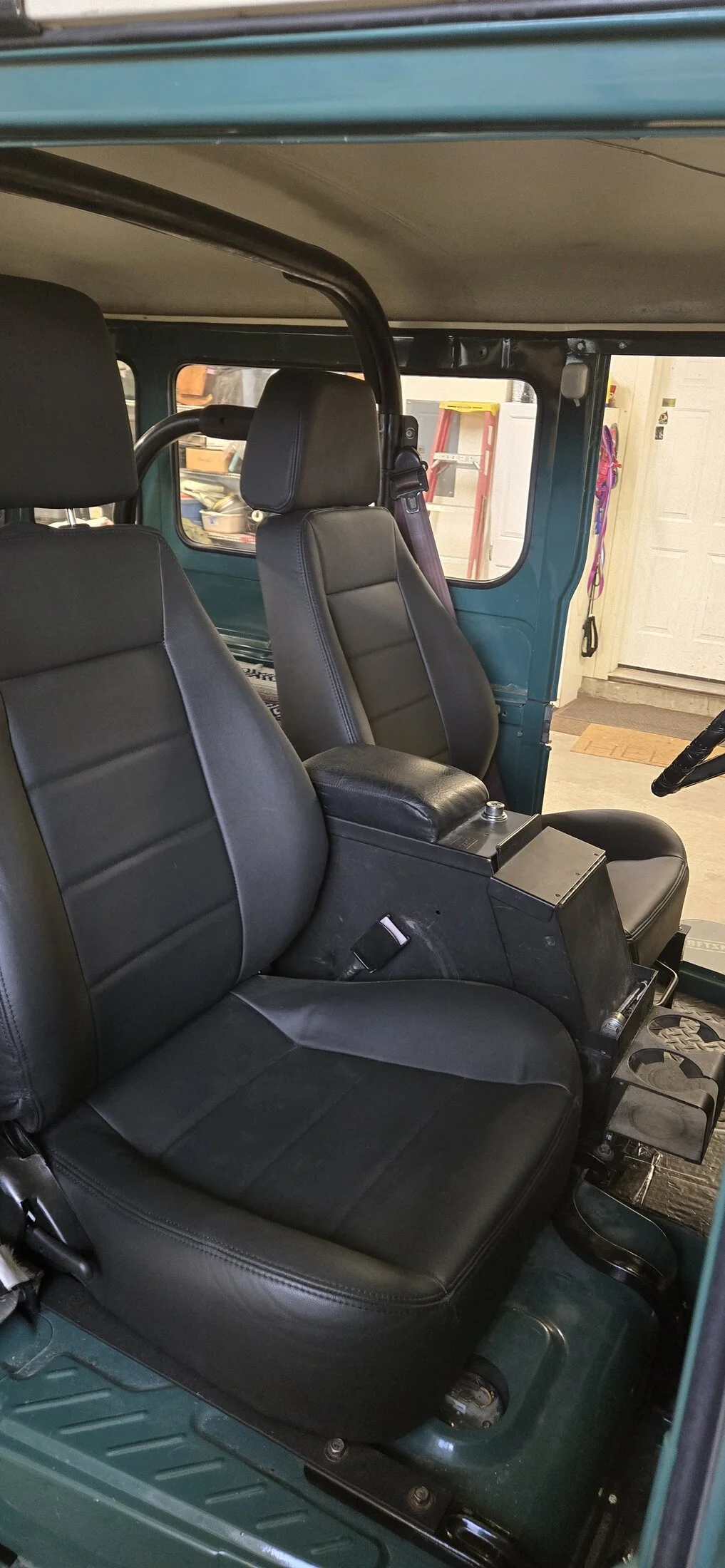

View attachment 3933608View attachment 3933609

Still in the getting it back on the road phase but it hasn't bugged me sitting in the passenger seat in the garage. Seems like plenty of leg room and I also converted from bench seats so passenger didn't have the sliding seat option to start with.
I will say I like the look of the Procar 90 seats more but I think the Corbeau's with the high bolsters will keep you in place better.
Thanks! I think I’m going to end up copying your bracket design for the passenger side. Another question for you… Did you end up installing a center console between the seats? Trying to find a way to mount a Tuffy to a ‘71 body since they don’t make standard brackets for it. TIA
Looks great man! Thanks for the measurements. I’m running a 71 body on a 78 so I think I may have to get creative here. I just ordered my Corbeau Sport seats off of Summit since they were in stock (gets here in 2 days!) and brackets from Corbeau directly. Did you end up going with full black vinyl here? How did you end up mounting your Tuffy?
Black leather.
There was no change in the mounting of the Tuffy console, it uses the front bracket from the seats.
