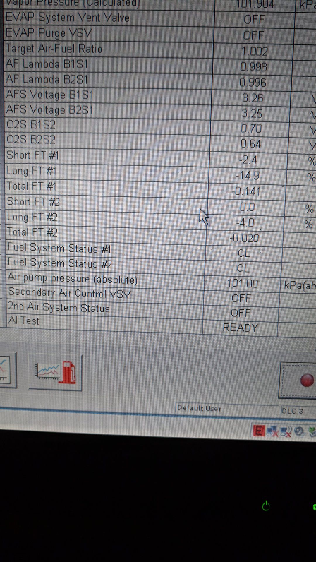

I put 12 hole denso ebays in and ran for three days. After three days I took them out and put new to me redone denso stock 4 hole in. I didn't notice much. They sounded different on first install, but no different than putting the fresh stock 4 hole in on the forth day. I did one bank at a time, made short drives and checked techstream. The thing I didn't like was seeing the negative short and long trim around 15-18% combined. Not enough to trigger anything, but still. MAybe I got a bad set from ebay.
Who knows. I was going to replace my old stock ones anyway, I had time to kill. I returned the 12s to the seller, sent the originals to FIS and installed redone stock denso from rock @ $25 each. The Rock ones tested fine and were very even across the board at 70° The standard motor product cheapie close out injectors from rock are stock denso with the f020 # which is also the same as the 0800 stock # for 2005+ LC.
I wanted to leave the 12 holes in, I tried. But being so far off a close to zero idle trim made me take them out. They leaked down faster also. Meaning the time it took to get a zero gauge reading was faster and the 5 minute test time for leakdown was faster, just barely out of spec, at 19 PSIG. Anyone else see drastic trim #s?
Did the injectors you bought say they were cleaned and balanced? Would be interesting to have FIS measure my 12-holes and see what they look like. Also I would expect a negative fuel trim when intalling 12-holes because the fuel is atomizing better = burning more completely which means you don't need to spray as much to get the desired energy from it.
sorry man, ebay balancing injectors out of a batch of 12 for 8, naw. And, NAW again on volume and flow rates.
No one should accept ecu trimming in the high teens on installed injectors. That's just me though. Maybe no one else is looking. (at idle)

I understand the anger at UPS. They are the worst.
However, you didn't really answer my question. What were the injectors advertised as? Were they advertised as "cleaned and balanced" or not? Were they used or new? What is your fuel trim with the stock injectors? Condition of O2 sensors so you know the trim is legitimate? Spark plugs and coils ok? Spark plugs haven't come loose on one bank?
14.9 LT plus 2.4 is 17.3 which is 4.7 away from toyota's code trigger. Unless it's 25%, I could be mistaken @22% maybe the ecu transfers the total into a % and goes from there. IDK. 22-25 is the trigger point regardless.
no one is selling dirty and unbalanced. They are selling clean and unbalanced. TO balance they need a bigger batch. Lets not go there. It doesn't matter. IF you want balanced injectors you need to go to the aftermarket cleaners, you need to call them. People should just realize what they're doing. That's the only point I'd try to make.
show me the clean and balanced 4.7 injector add for cheap money.

Without me going back and reviewing the thread. Did you post picture of your trims and what they look like before & after?
Your not testing the old factory injectors gave me pause, as you know. Don't get me wrong I applaud your works and appreciating your reporting with this thread.

What is your fuel trim with the stock injectors? I showed on one bank stock in the pic already.
Condition of O2 sensors so you know the trim is legitimate? equal wide band data isn't good enough? even the narrows are equal.
Spark plugs and coils? I get dumbing it down, but no, not here.
Spark plugs haven't come loose on one bank? absolutely not.

AFR data from a single wide band doesn't work, and shouldn't. The same questions you asked me would be asked of you, plugs coils, wide bands etc. You can't argue injectors online.
But you used fuel trims which is based on a bank of cylinders and not individual cylinders?
If you have wideband data from both banks post it. In this vehicle the ecm is going to adjust lambda no matter what to the fullest extent. You know this. No matter what you do on the front end, what comes out the back is going to be relatively equal across all 100s series.
You are 100% correct which is why I asked about your spark plugs and coils. On the 100 series it is a commonly known fact that the spark plugs come loose over time. I checked my truck 2 weeks ago and 3 plugs were loose where I could remove them with my fingers. 2 loose plugs on the passenger side and 1 loose plug on the driver's side would cause an unbalance unrelated to fuel injectors, do you agree? If so then when was the last time you checked your plugs?
Also my wideband experience is purely to see how the engine runs at WOT, in open-loop, and was in response to a completely different poster with a completely different concern.
