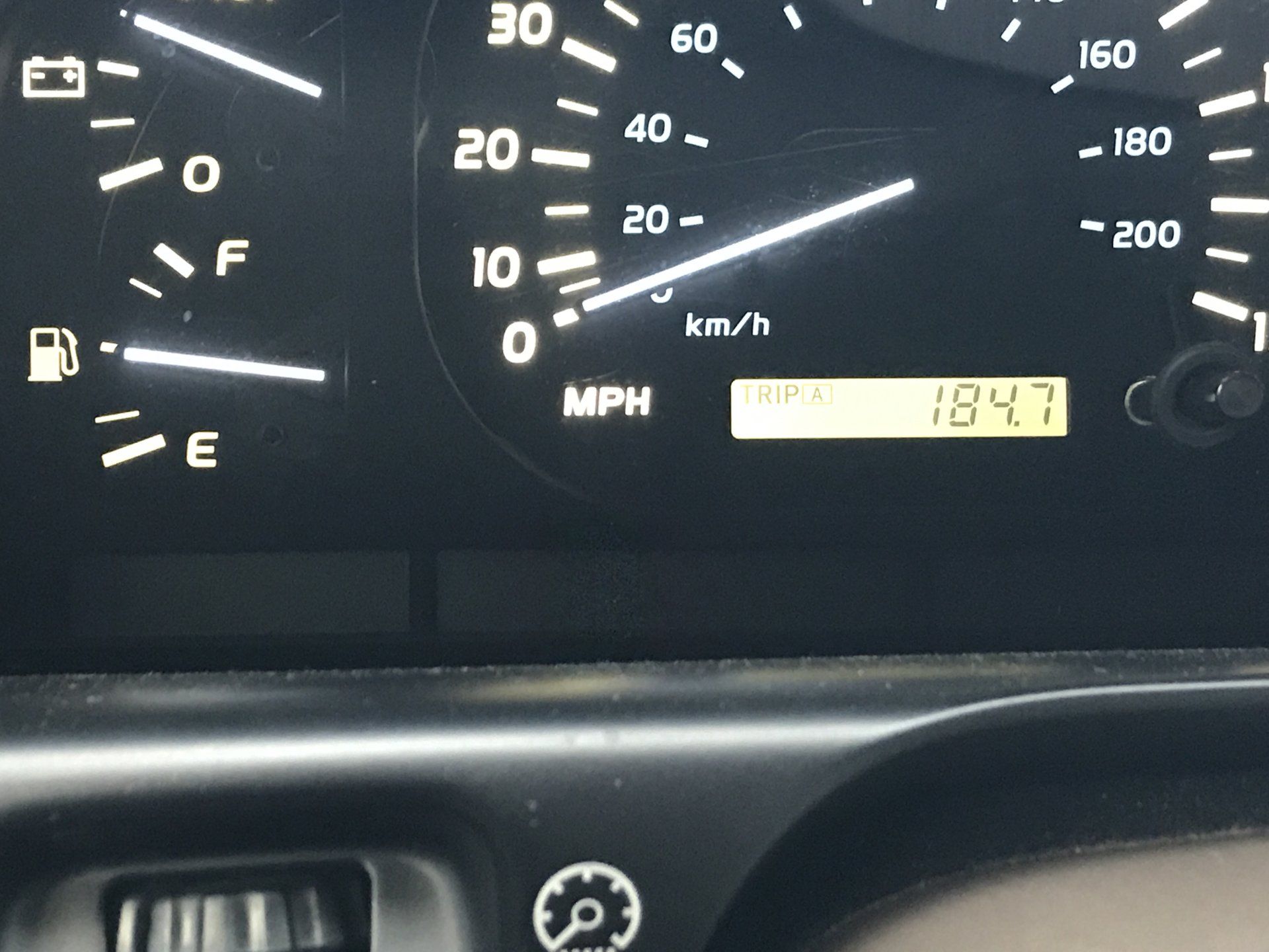

So after the first half tank with the new injectors here’s my first update...do it! I’ve done my best to keep my driving habits the same but this is the most I have ever gotten on half a tank of fuel. Overall it seems to idle better and run smoother. I’m noticing it’s not downshifting on hills where as before it would having to find a gear to get into. I’ll update after the weekend with the final miles on this tank.
What mileage were you getting pre 12 hole injectors?
Mine was a freak built at the perfect time apparently. I was getting 320-330 miles on a tank
