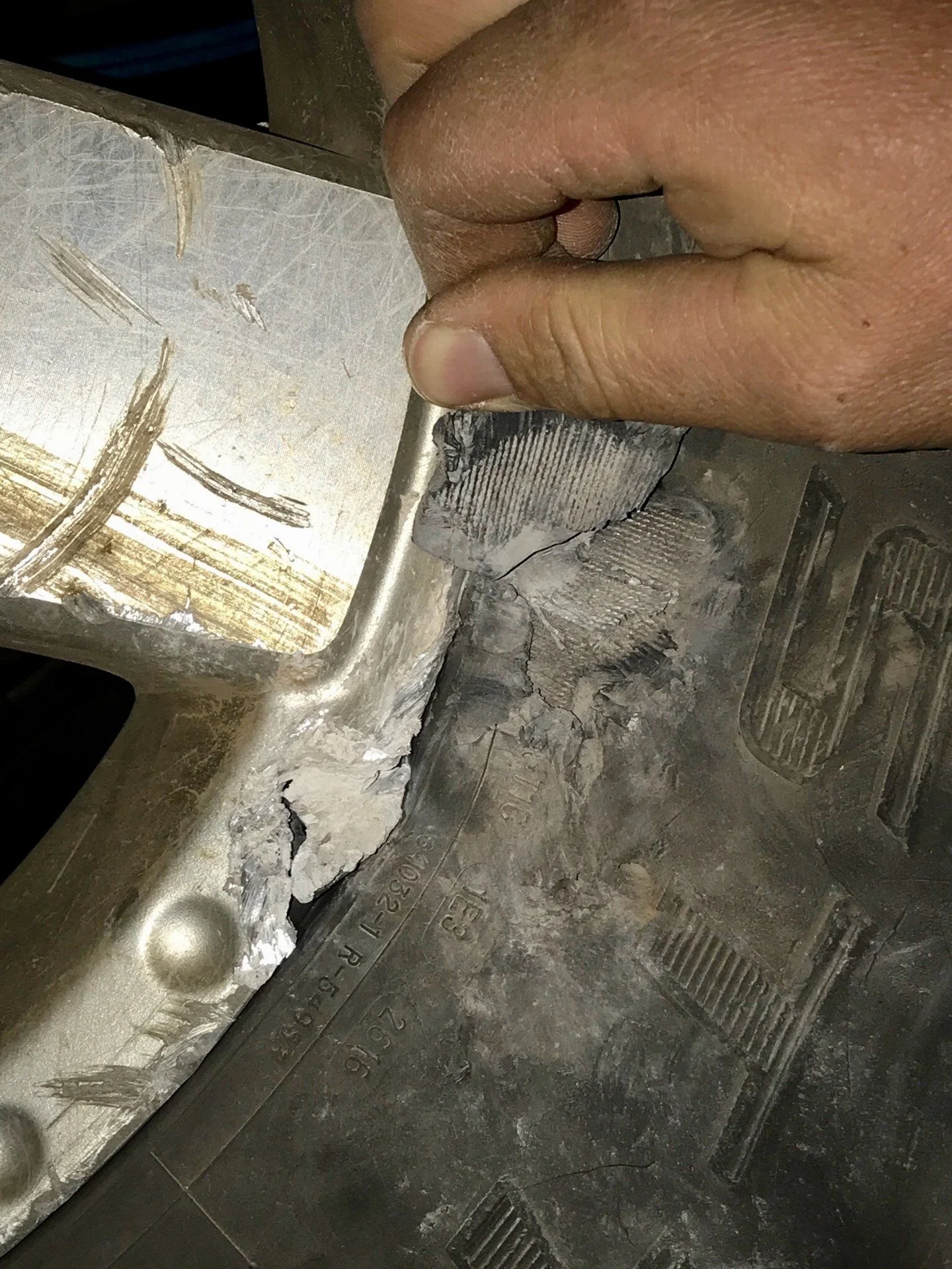

I chipped one doing some *very* light wheeling on a dry lakebed.
Wasn't paying quite enough attention and "BAM!" hit a bowling ball size rock just so on the inside of the steering knuckle. Got out to look for suspension damage; didn't find any but did find a chip on the rim.

Back on topic: I have knocked my stock wheels around quite a bit (including a sidewall bash that looks pretty similar to that FJC picture) and they are beat up, but nothing that appears to be structural. AFAIK, they've been on the truck 320k+ and the original owner was an off-roader too.
