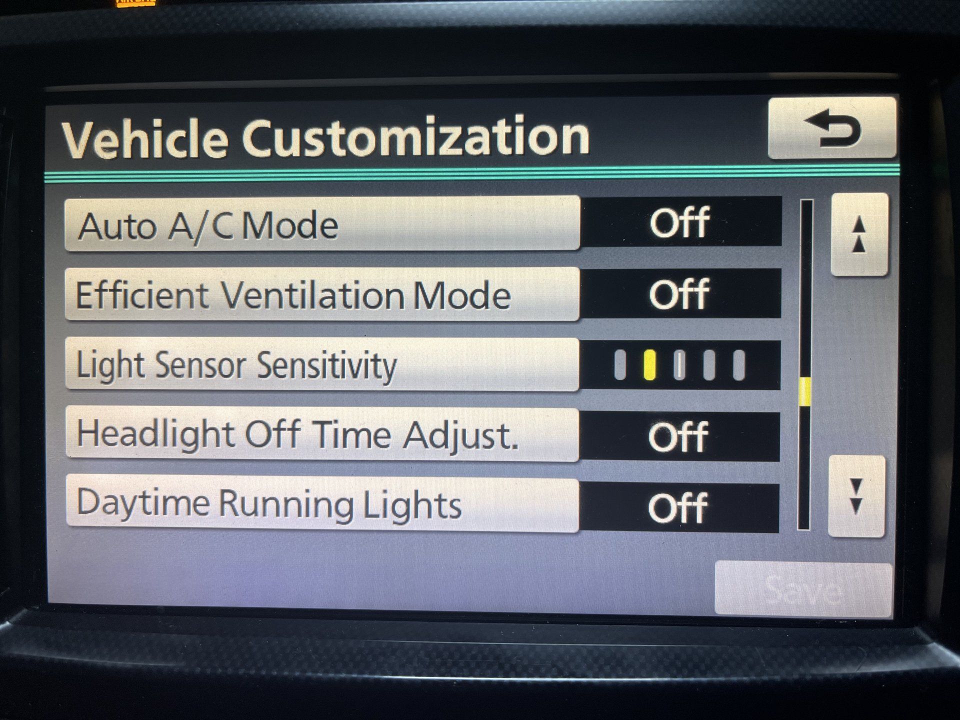

On my 2011. Under Setup~Vehicle~Vehicle Customization~Climate Settings.
Then find “Efficient Ventilation Mode” and turn it off. Then whatever you left your setting on, it stays there. Even when you hit Auto again, it’s not changing a thing with your recirculating function.
Side note, if you also don’t like when you hit “auto,” and your A/C turns on. You can keep that to the last setting you had by turning off “Auto A/C Mode” in the same selection. No need for tech stream.
Found it on day one of ownership and never looked back.

So, my '14 LX does not have an 'efficient ventilation mode' option.
I did turn off 'auto a/c mode'. Will see what that results in.
Anyone know what the heck 'smog sensor sensitivity' option does?
