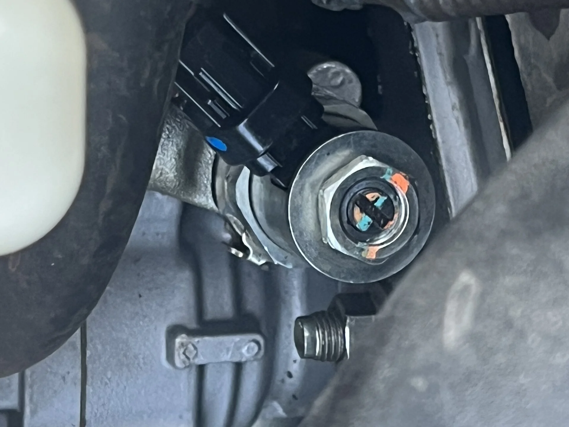

So my 2021 is so awful to steer as well, took it back to warranty twice and they said tyres are larger, gvm kit blah blah
I got so annoyed I just Swapped the steering pump over and still the same
So there’s a solenoid on the pump for variable pressure for high low speeds, on top of the coil there’s an adjustment, j wound it right out and over 1000rpm I can steer it with my pinkie, under these rpm it’s almost 2 hands to steer, so annoying on long drives I get so tired driving it
I’ve removed the coil and it tests ok on 12v, I’m now yet to wire up 12v constantly on the coil to see if it gives full pressure at lower rpm
I’m guessing it’s a proportional coil that varies current and voltage from the computer via speed

Yup, its just what Toyota/Lexus did on the newer 200 racks. I have not found a way to fix it on any of the 200's we've had.
So
Update, new pump made no difference
Adjusting the variable power steering solenoid on top of the pump made a difference up high over 1000rpm but went stiff like it was before under these rpm
After pulling relief valves apart and mucking around with varying the voltage on the coil it didn’t make a change
I found one tiny shim in the top electronic variable relief, removed that and so far feels like a different car, full power steering right through the rpm range, not awful heavy as before ( heavy was still drivesble) you can hardly steer the thing with no power steering
Going for an 800km drive over the weekend to see how it feels
Wow, really interesting results. Any photos of the shim you removed?
