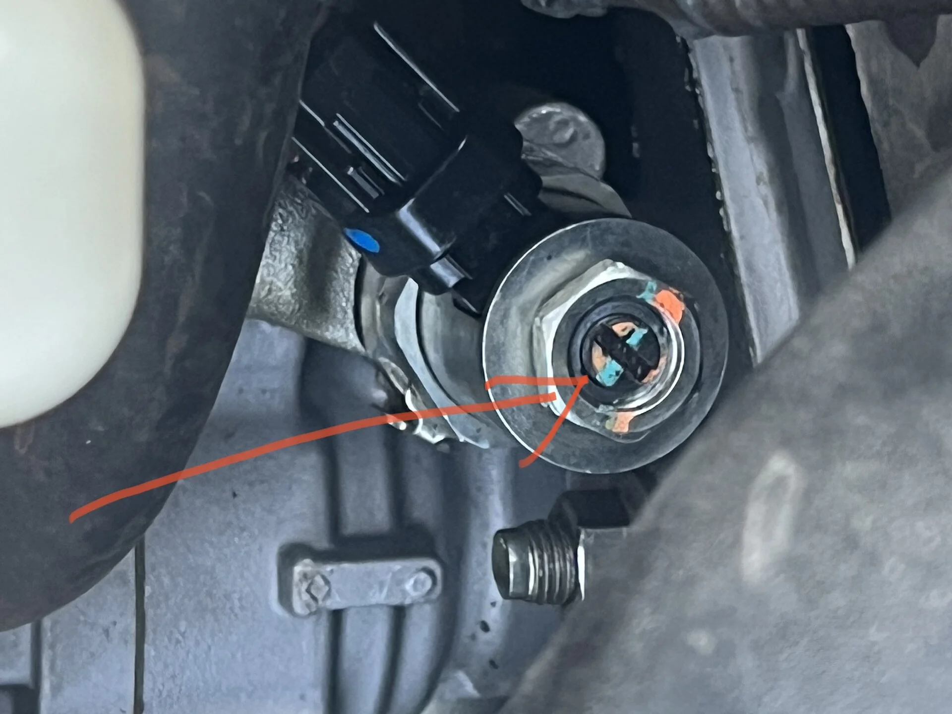

Backing the adjustment screw, unscrewing it only made steering better over 1000rpm
It’s easy to try, wind it out around 2 turns and go for a drive
You will feel what power steering feels like again

Thanks!
Sorry to sound daft, but where is the adjustment screw? I’m wondering if we have a difference between cruisers as I don’t see it on the pump assembly. Is yours a diesel or gas cruiser?
Thanks!
Mines diesel
Mines diesel
Well that throws a monkey wrench in the equation. I don’t think the 5.7L gas cruisers have the same power steering pump when compared to the 4.5L diesel cruisers.
On the gas, the pump solenoid has the connection in the area where the adjustment screw would be. (Dang)
