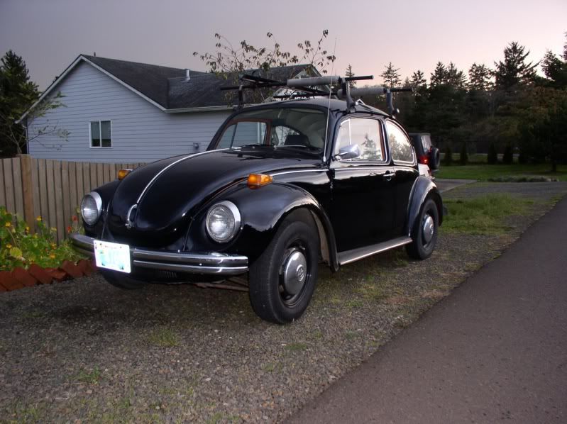

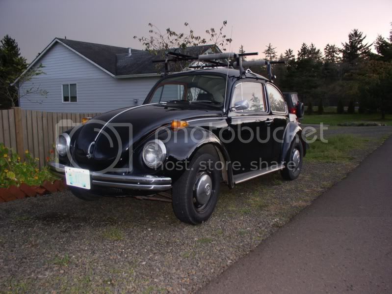

As an aside, a paint job paid for my FJ40. A few years ago a friend gave me a Beetle because he hated it so much. I painted it with a gallon of Napa fleet paint (see pic). Sold it for enough to buy my current FJ40. You talk about an upgrade! :cheers:

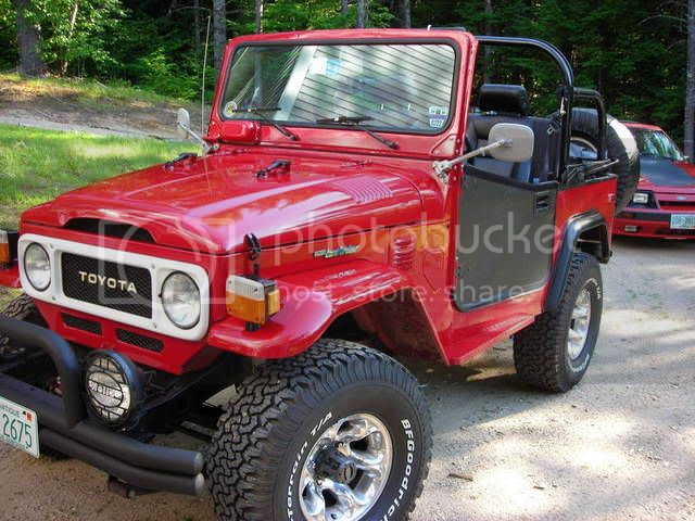

What I used was Napa Crossfire acrylic urethane in a fleet color. I think they call it regal red or something. The color was less than $100 a gallon, but I did get it 8 years ago. My truck is garaged and it honestly doesn't get driven much or wheeled too hard but the paint still looks great. The bodywork under it well.... I'll get to redoing that someday.
