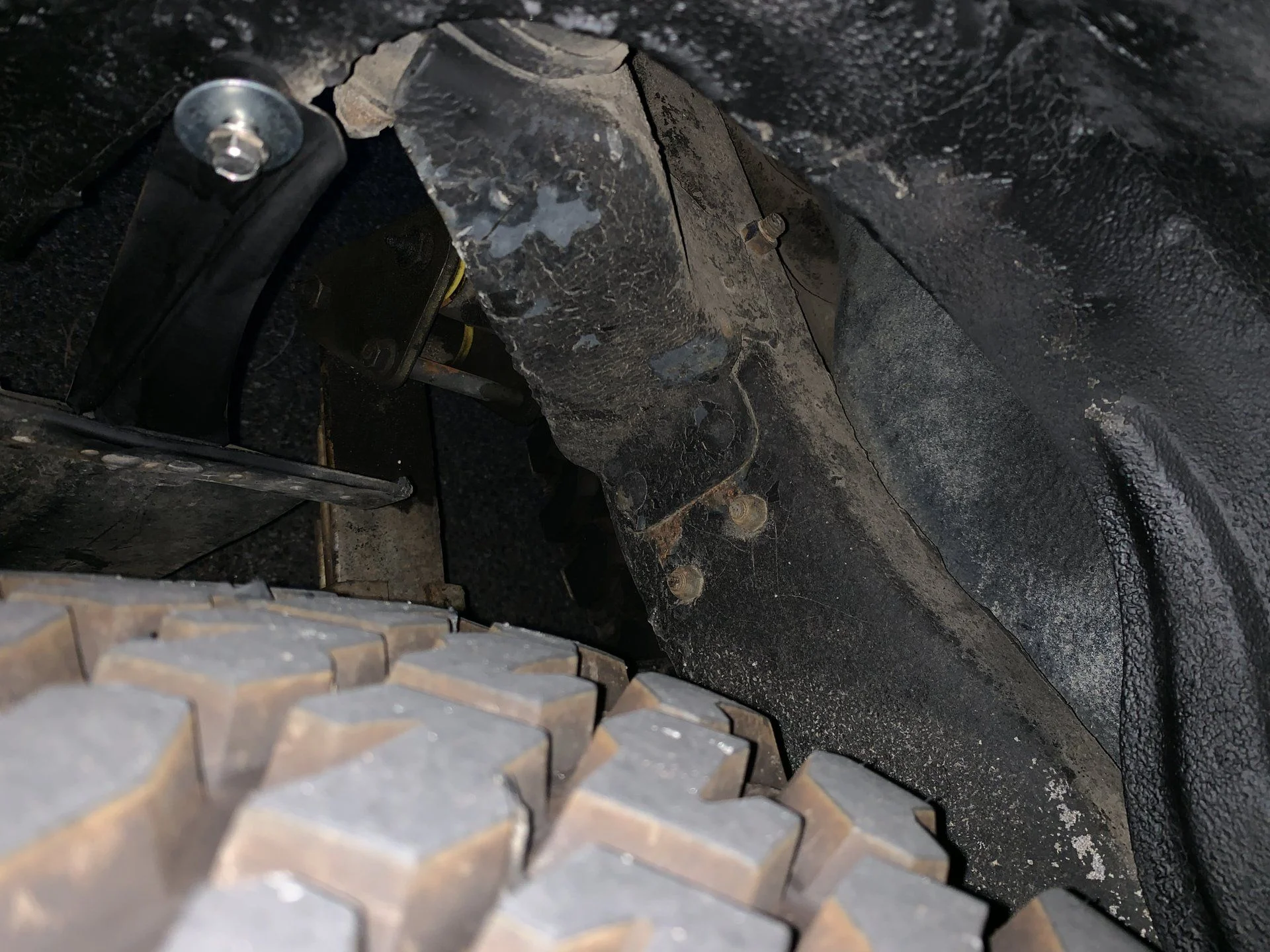

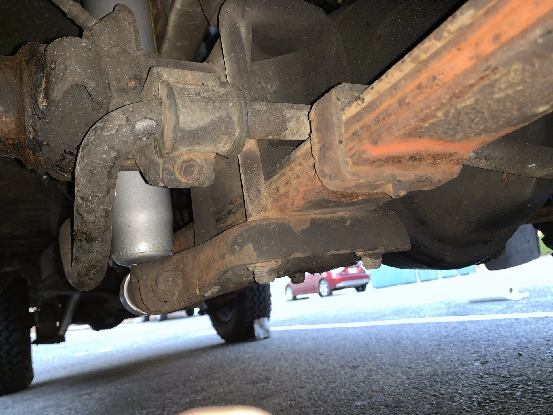

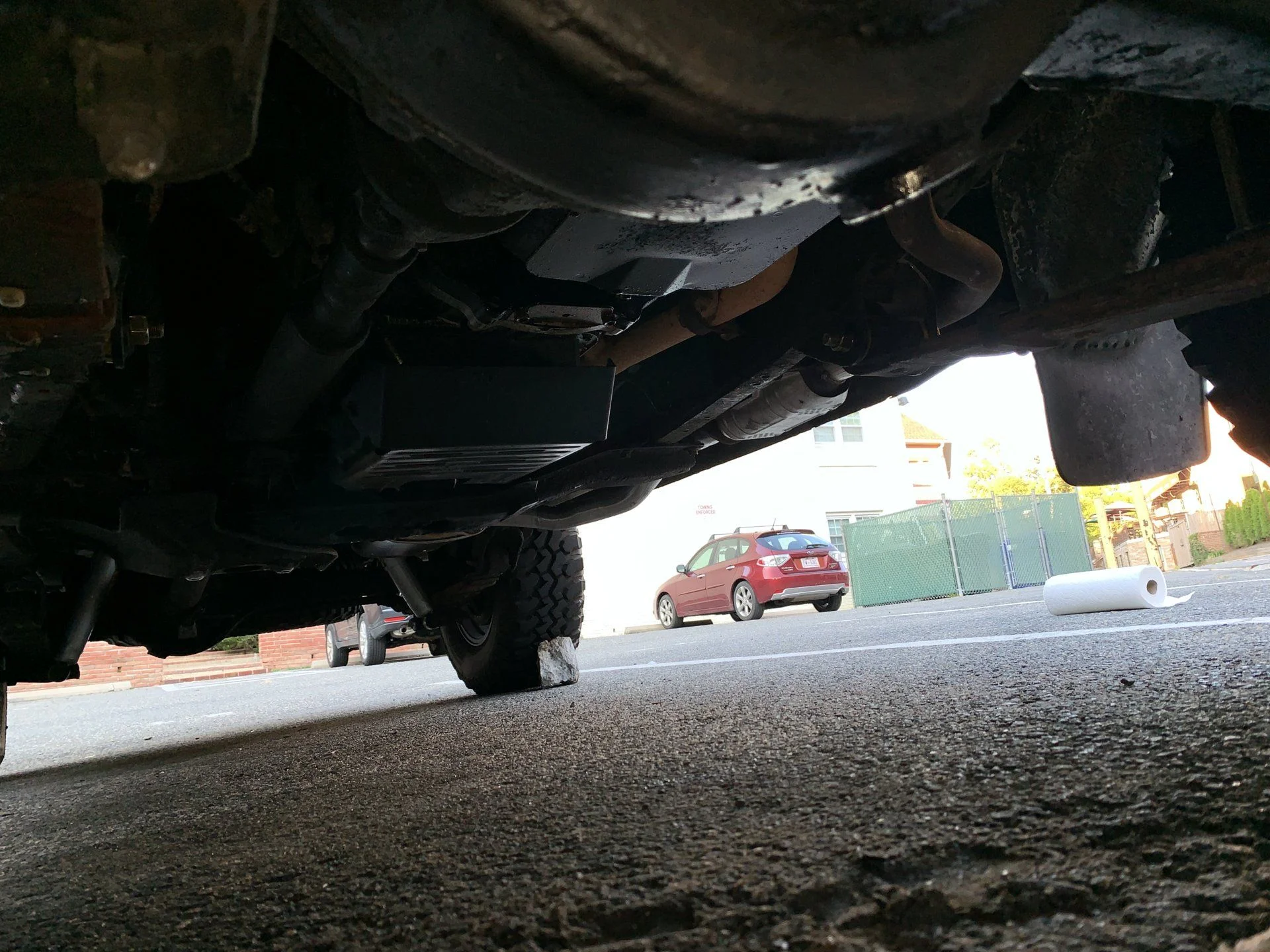

I’ve got an appointment for a Krown treatment at Line-X of South Central PA on Monday for the 62.
This past week I’ve hit some minor spots with the drill/wire wheel and rustoleum rust reformer.
Will report back and include pictures.
Mike and Jessica at Krown/LINE-X of South Central PA were super nice and looks to be a quality job. I’ll take more pictures when it’s dried a bit more.
Was definitely a trek with traffic but hopefully worth it. As of right now I plan to take the 100 in the fall.
Before:
