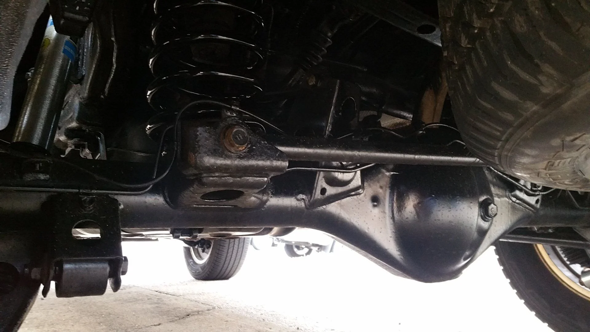

I was considering going there. They have excellent reviews. After watching too many YouTube videos, I got cold feet. Some people have horror stories about undercoating. Do you have any after pictures? I'd love to see the underneath.
FluidFilm seemed like a good compromise. I haven't done anything yet, but I plan to in the next month or so. I'm still open to other forms of rust protection.
Automotive Protection Services undercoat
Done about 8 months ago... on my 2006 4Runner
