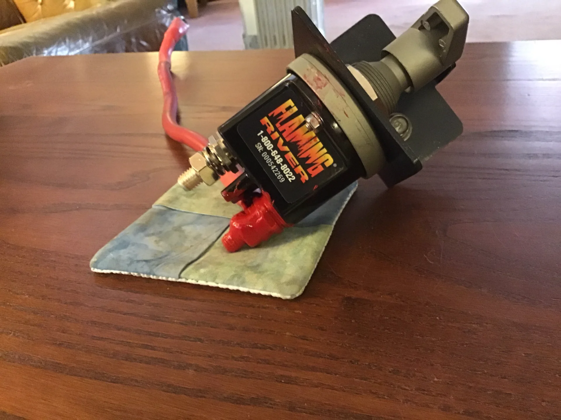

It a good idea to have more than one deterrent in each vehicle. Here is a good kill switch…WITH a padlock.
Question about that though, if a thief sees a locked switch in the vehicle, what stops them from yanking it out to then connect the leads behind it? I understand that locks only keep out the honest, and a determined enough thief will bypass any security measures given enough motivation and time, but my thinking is that a kill switch needs to be hidden or obscure while things like steering and pedal locks should be visual deterrents.

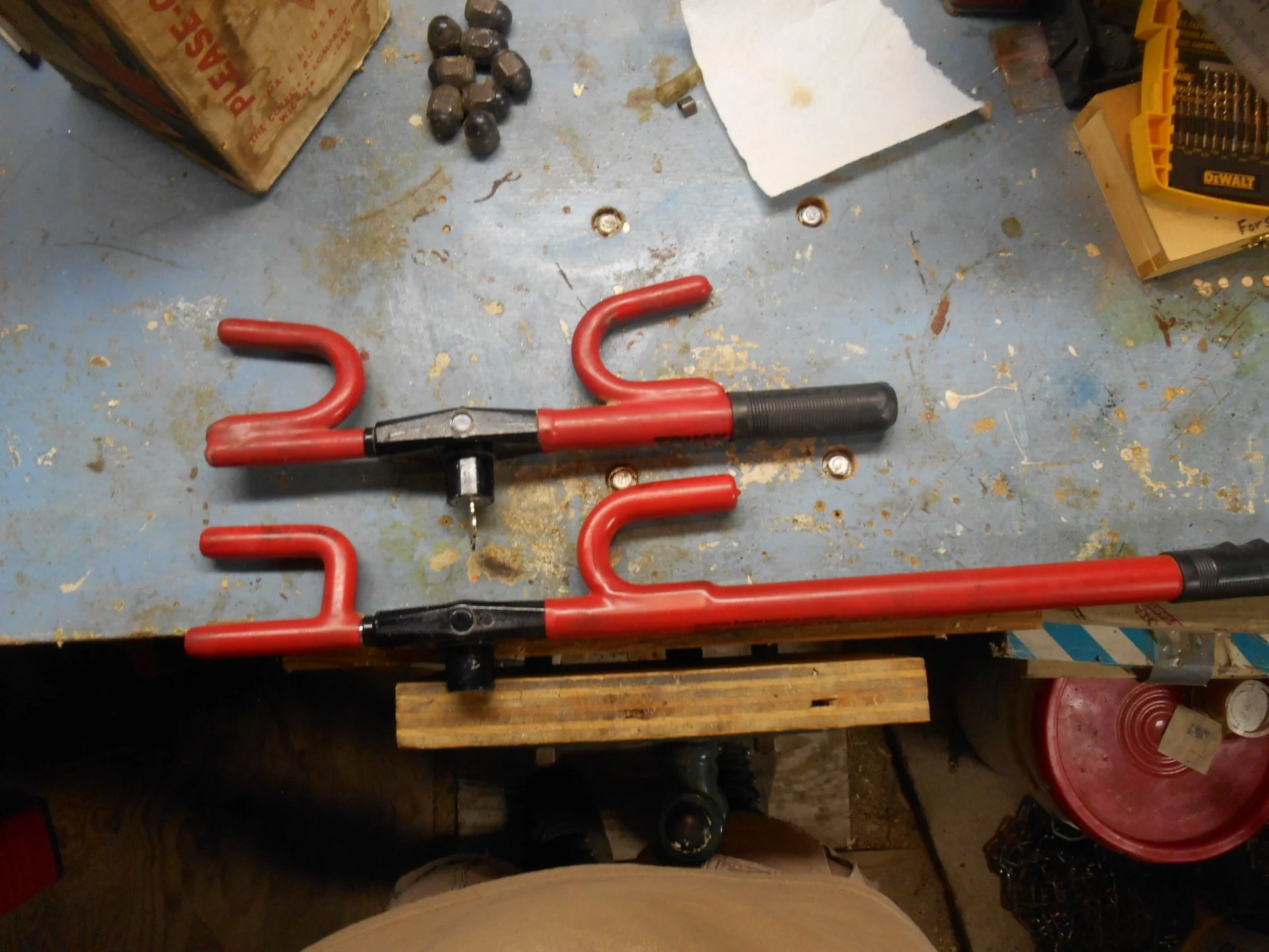

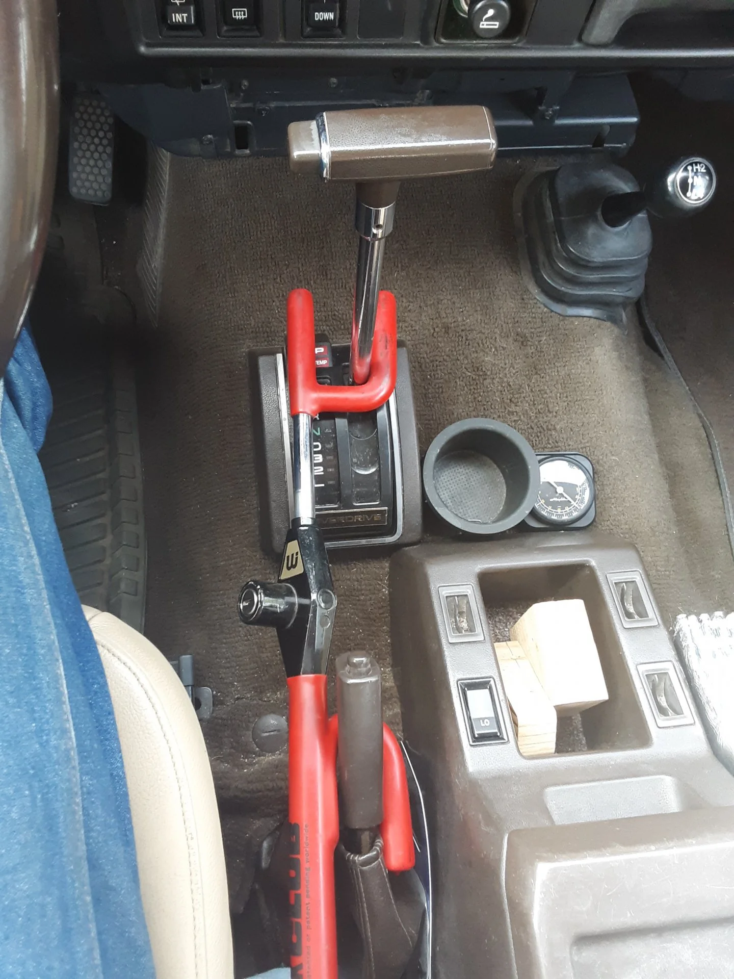

I was playing around with my Club this AM and discovered this. I might get another one at a thrift store and cut it down to fit here. Just another annoyance to slow me, er, the thief down.
Ok, so I did a couple things tonight I will explain with photos. I have used a Club for years, but decide to go further:

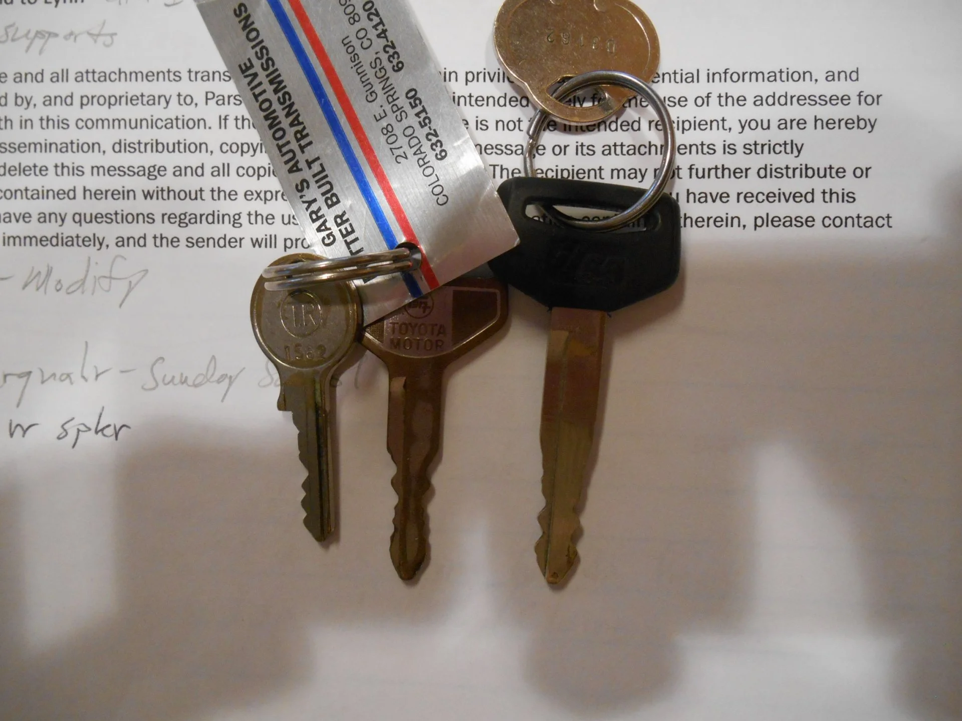

  1. Since Paul's stolen truck was found with a worn out key inside, I took my well-worn OEM 1978 FJ40 key and tried it in my FJ62 door locks - nada. But, I tried it in the ignition and with minimal jiggling, the cylinder turned. Ouch! This adds a data point that 'yes, a worn out old, different Toyota key will work in a Land Cruiser ignition'. Notice how the FJ40 key (left) and FJ62 key (right) are cut differently.

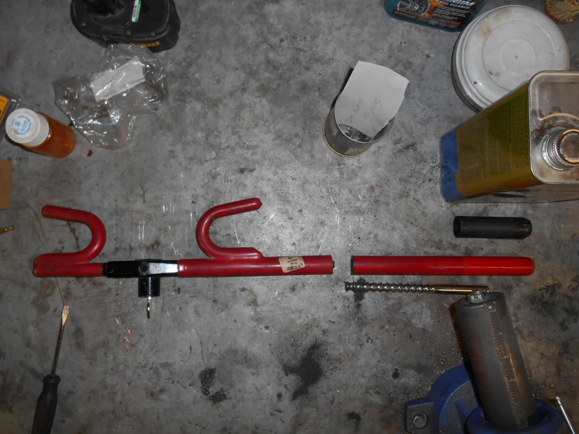

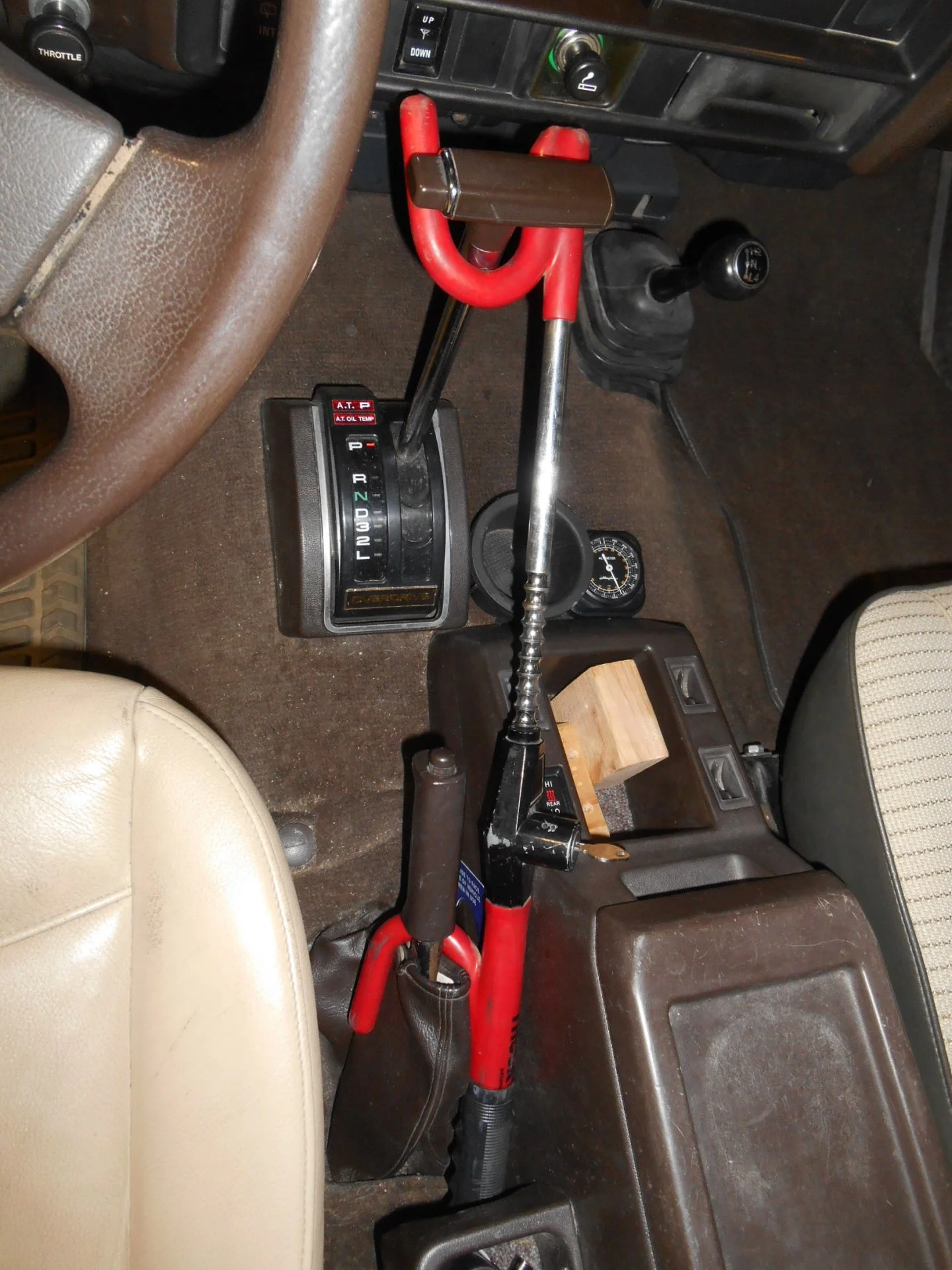

  2. Being a cheapskate, I went to Goodwill and bought a used Truck Club for $6.99. Seemed to fit the shifter/brake area pretty well, so I chop-sawed off 10" and refit the grab-handle sleeve. Now, it's lighter in weight, clears the console and seat mounting points, and securely locks the shifter against the actuated parking brake. Pretty slick. Not too time-consuming to deploy. I hope it makes my truck appear unappealing to loser criminals.
    So, I think 'Winner International' (the Club people) should be sending me a Christmas card pretty soon for pimping their products. I called a local locksmith and he can make me extra keys for my new shortened Club, since I only got a single key with it at Goodwill.
Good job @SteveH I like it!👍
