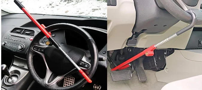

1. The Basics - Steering Wheel / Brake locks.
These are probably the most user friendly locks one could get. Easy to use and cheap to buy at most auto parts stores.
Pros: Easy to use, Cheap to buy.
Cons: A thief can hacksaw these off, cut your steering wheel to get these off, Damage your car trying to get these off, And increased wear on the brake system if you use the brake system.

Another solution I've seen is this:
While these aren't perfect, it will slow down/deter folks with a worn down Toyota key
