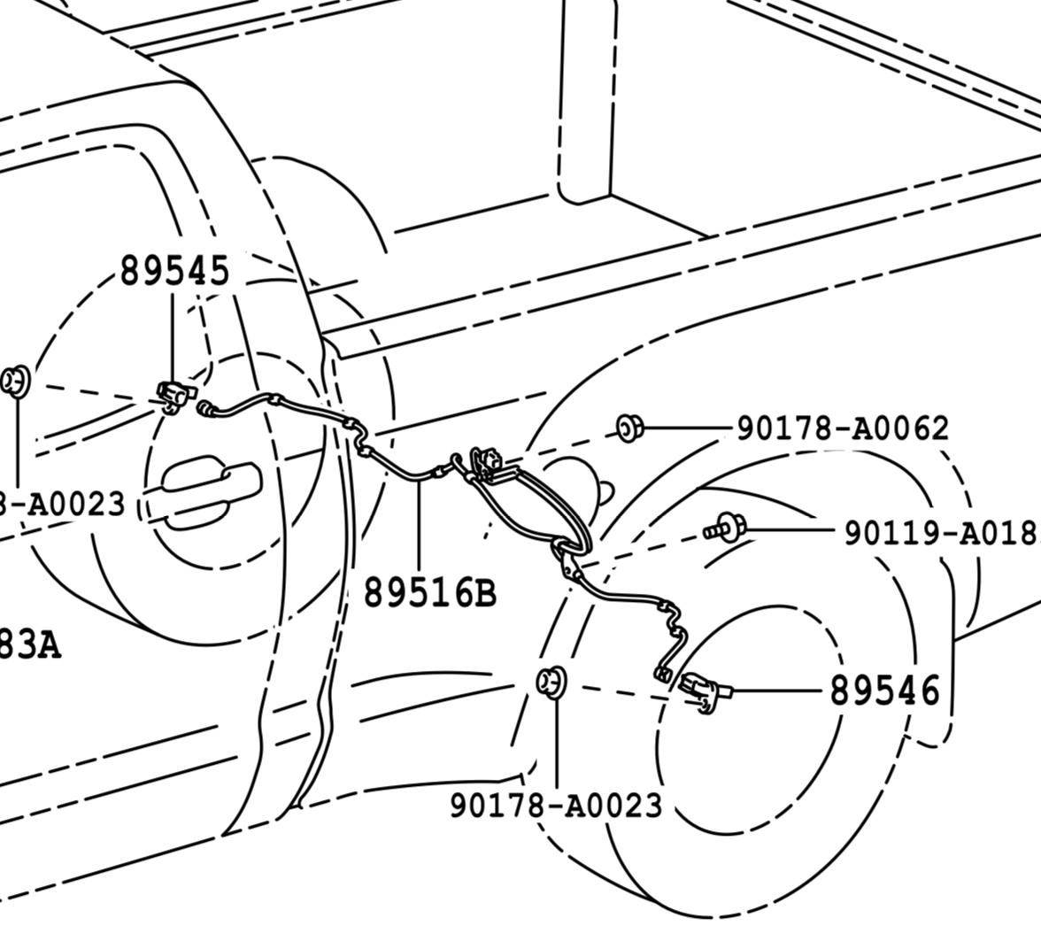

Sounds bizarre, but i had the same issue with my 2014 Tundra
Longgggg, painstakingly frustrating troubleshooting story short, a rock, or something on the freeway bounced out and mangled one of my ABS/Speeed sensors on the rear wheel.
It triggered the same warning lights, and issues, but never triggered any brake related warning lights.
Just my random FYI
Crazy thing, When i got the car. It also had all the lights. My friend had access to toyota Diag software and noticed that the braking speed was different on the front passenger side speed sensor. replaced the really expensive sensor ($300), fixed the problem.
Yeah, sounds like EXACTLY the same issue I had with the Tundra
After getting under it, I was baffled at how the speed sensor wiring was routed and how poorly attached it was. I went through and redid it all to keep it out of harms way.
If I’m not mistaken, it was enough of a vulnerability problem, some aftermarket companies make guards for them now.
Now you that bring this up again, I’m going to crawl under my 200 and see if it’s the same and if so, address it asap
I don't know if it can be guarded since the hardness goes through the knuckle. My friend who's a toyota mechanic had to drill out the sensor since i think the corrosion was what did it in. Its not really able to be protected. Just pray!
If they’re similar to the tundras in the REAR they most definitely can be protected.
The wiring harness is mounted to the front of the housing, really poor design.
