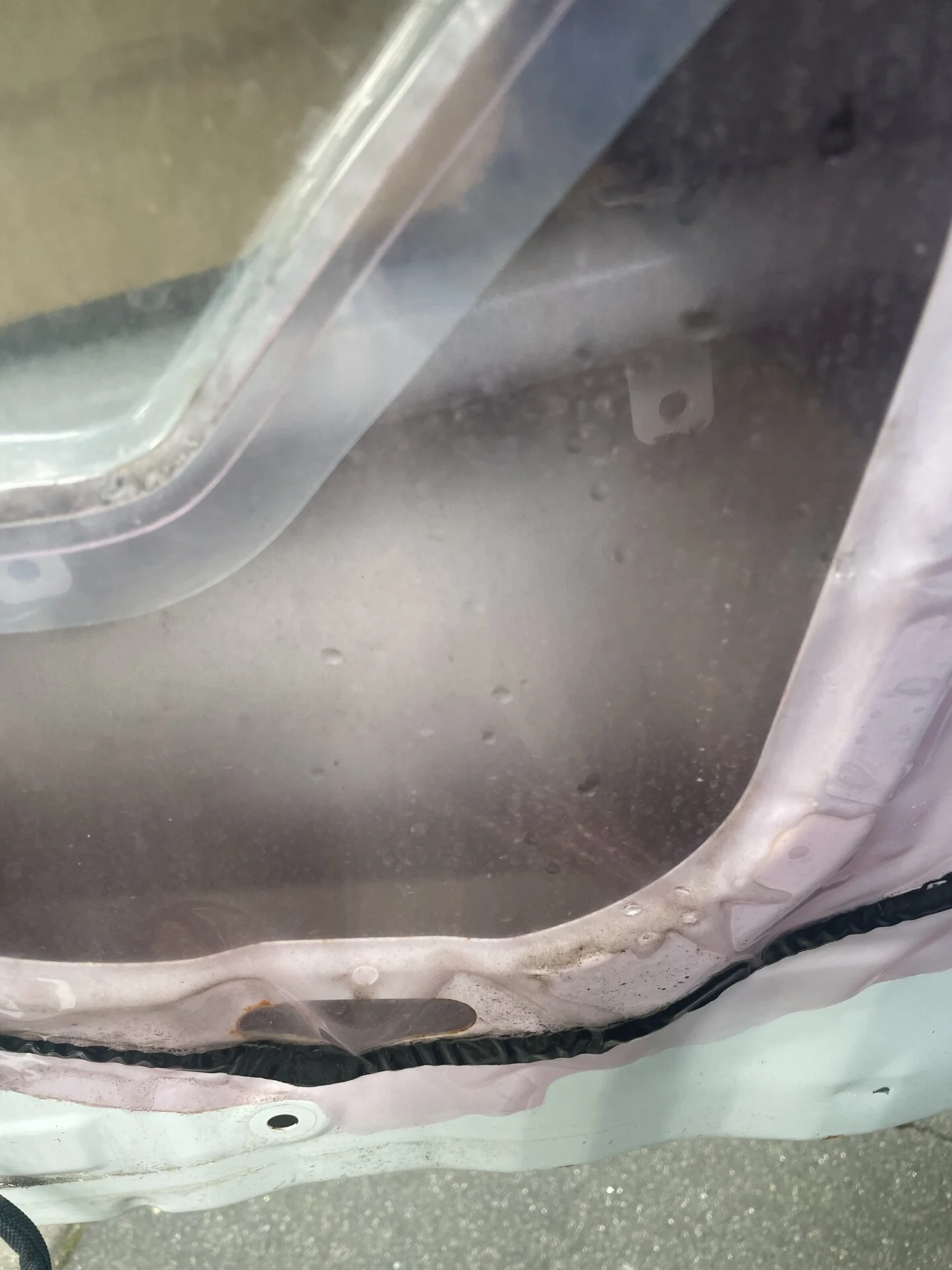

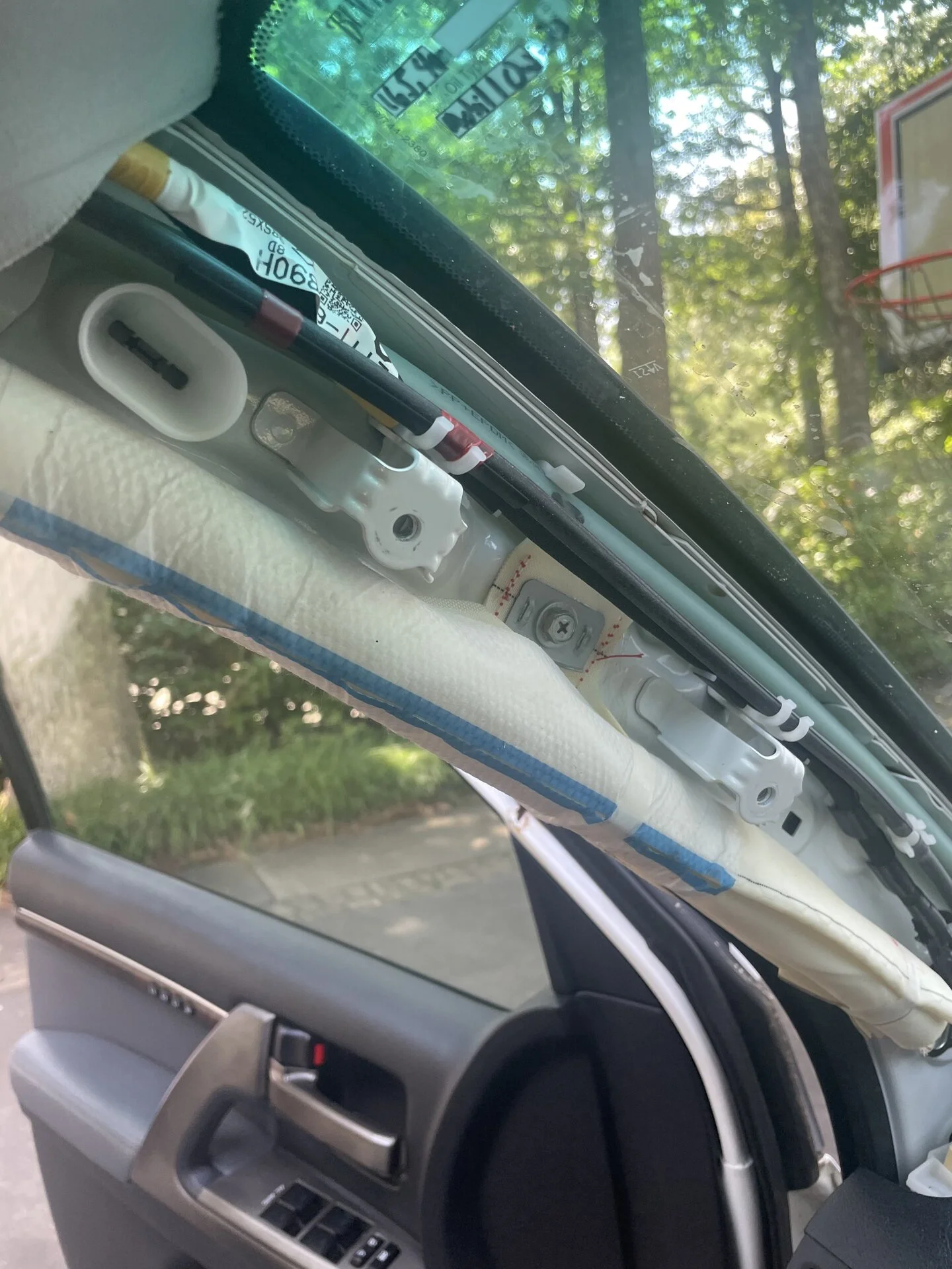

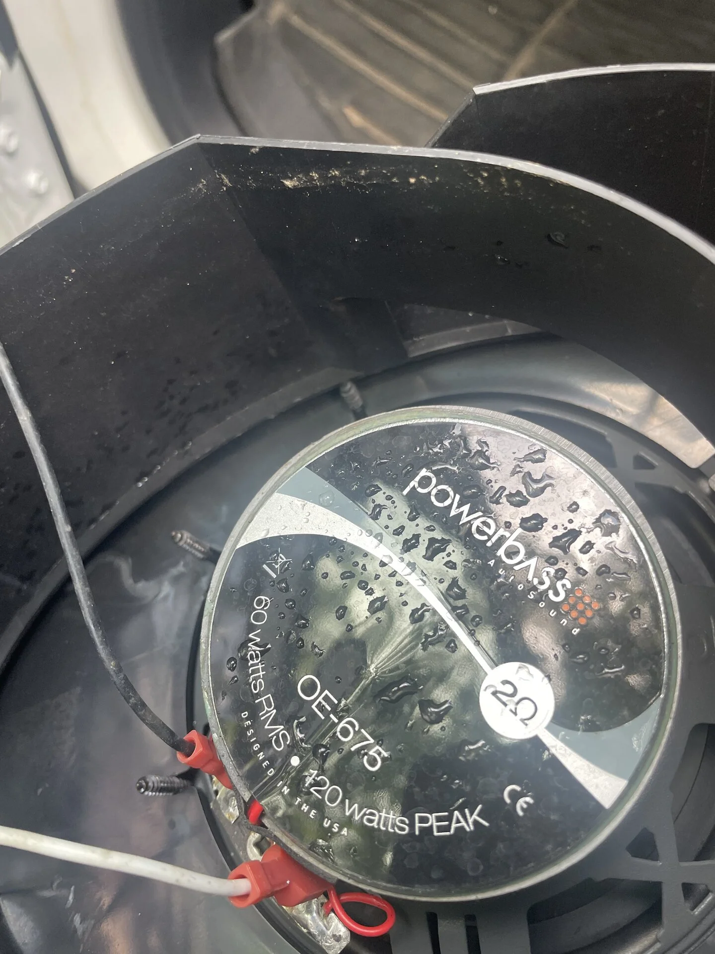

However, after the last incident, I noticed a significant amount of water pour out when I opened the driver door. The floor mats were bone dry, I pulled up the carpet on both sides and the padding under the carpet was also completely dry. I began taking the door off and started finding evidence of more water. The back of my speaker was damp and so was the rest of the inside of the door (the interior being on the inside of the outer shell and inside of the inner structure of the door). There are a few electrical components in that area, namely the window motor, rear view mirror ECU, window switch pack, and the speaker. Would any of these components taking on water cause those dash lights to come on?

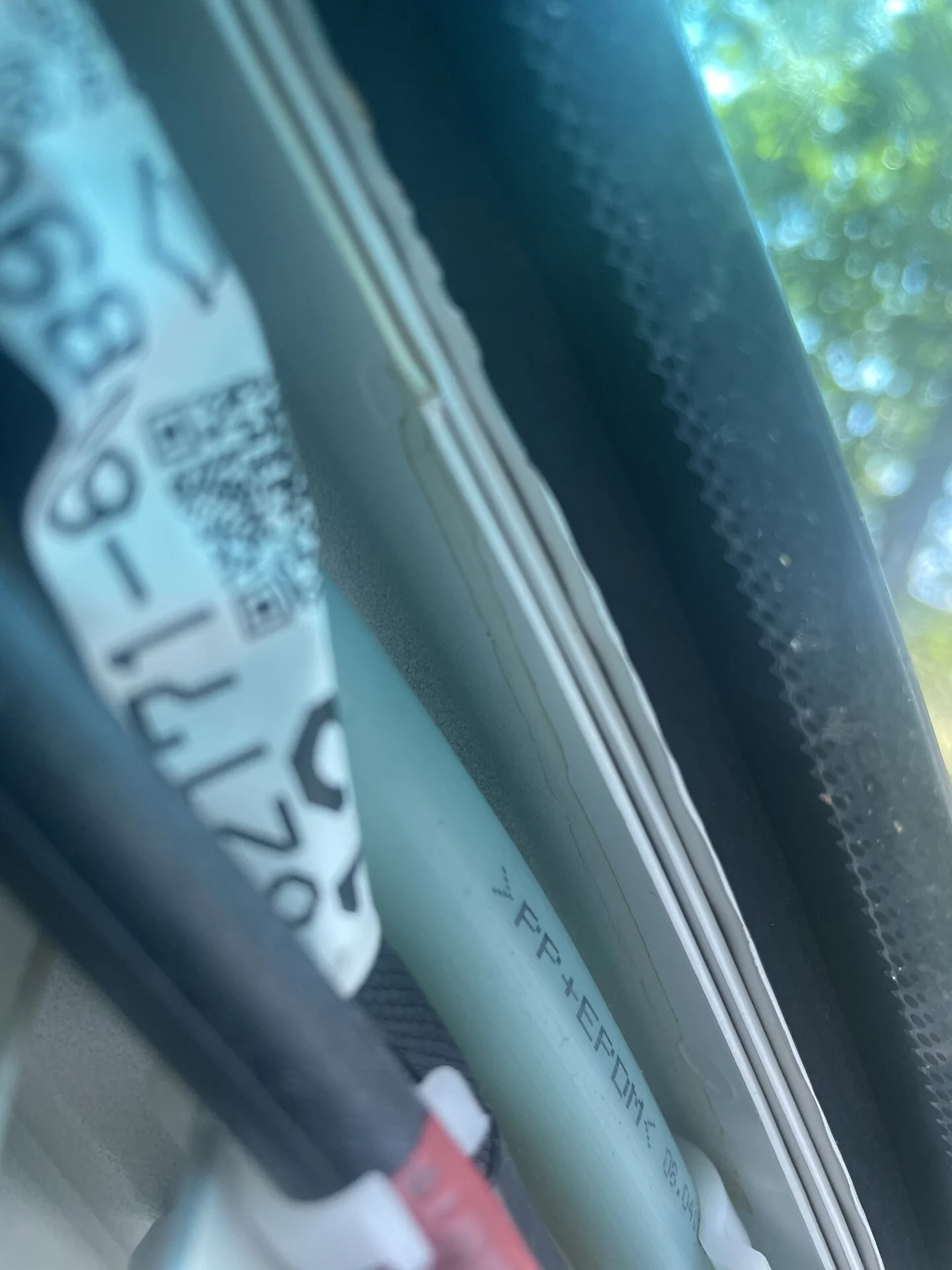

I suspect that the door seal itself has failed, there is a place where the seal on the door has a plug that goes into the door frame and is separated, and there is some rust around that hole. I suspect water is getting in there, going down the structure of the door, and getting something wet. Although it seems like a lot of water was in there, so maybe it is the window seal instead.

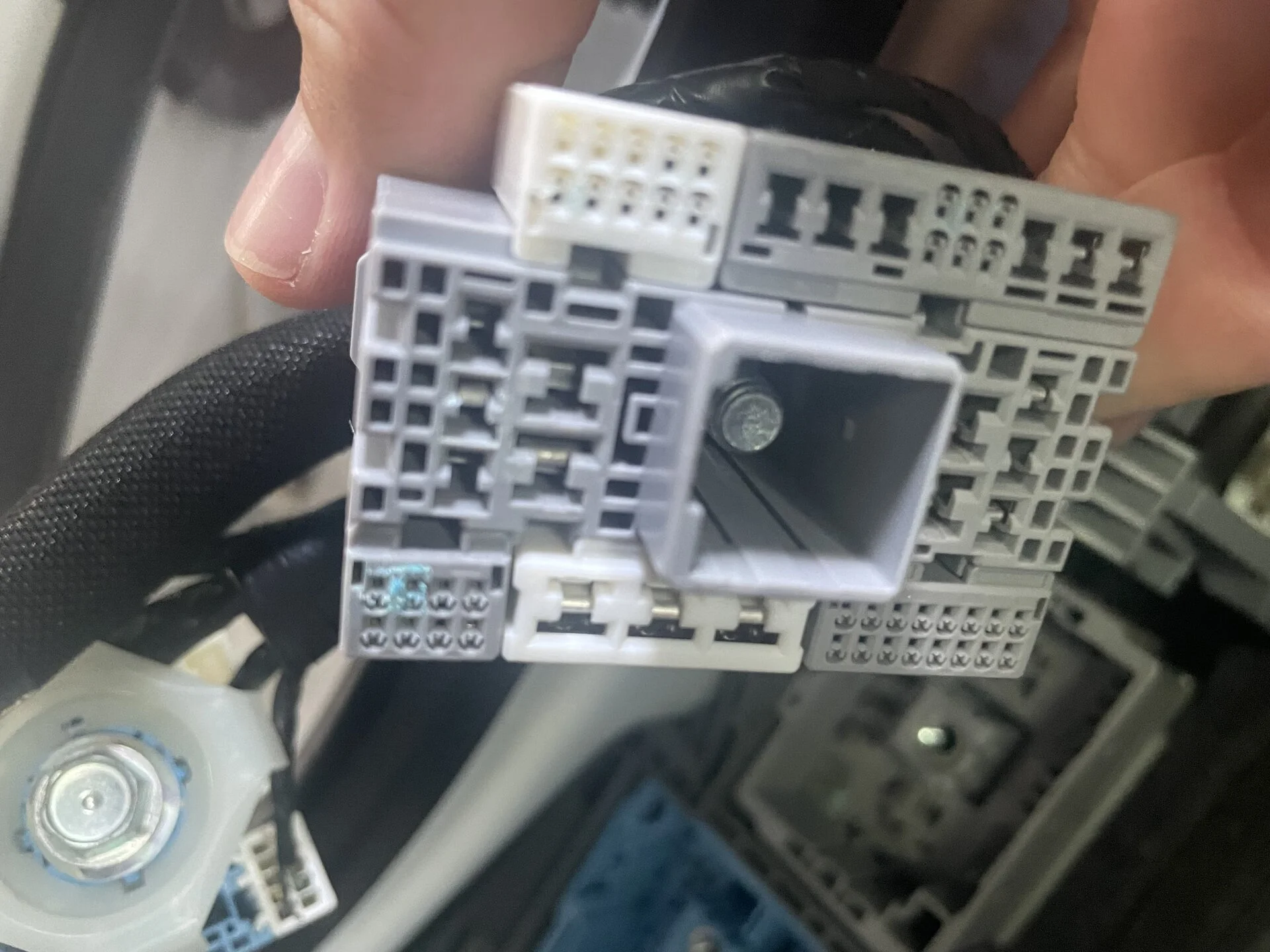

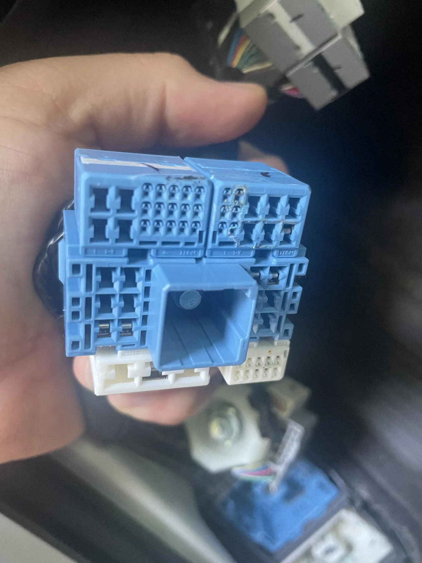

After the previous incident I pulled the trim and cleaned the connectors. They had some minor corrosion but were dry. I cleaned with electrical cleaner and a soft bristle toothbrush but the issue keeps occurring.
I suspect that corrosion is the culprit. You'll probably have to do a better job of cleaning the contacts after you fix the water leak. I bet the door seal leak let water run down into the wiring channel at the door sill along the floor and messed up those connectors, if you're certain the windshield and sunroof drains are ok. The wet speaker indicates the door seals. Maybe others on here will chime in with good contact cleaning advice.
The door is designed to have some water move through it. There just isn’t a great way to completely seal it out given the window needs to move up and down.
End of day, if water isn’t draining out of the door the small drains along the lower edge are clogged. I can imagine a scenario where it leaks into the cabin by draining into the door card area then flow on top of the weather strip where it’ll then go into the foot well.

The door still does have water moving through it, the drain plugs don't appear to be clogged since the water poured out when the door opened. The point at which the water was being held was lower than those body harness connectors in the panel.
Also, at the same time I removed the door and found the speaker had significant amounts of water on it, I had also pulled up the carpet and it was dry, and there was no water in the channel underneath the body harness, everything was dry.

Did you put the speakers in? Those aren’t stock. Someone was definitely inside that door.
Nope, those were there when I got the car. First thing I noticed when I took the doors off, how they hacked the harness to make them work.
They sound terrible, they aren’t appropriately powered. At max volume you can hold a conversation without really even raising your voice.

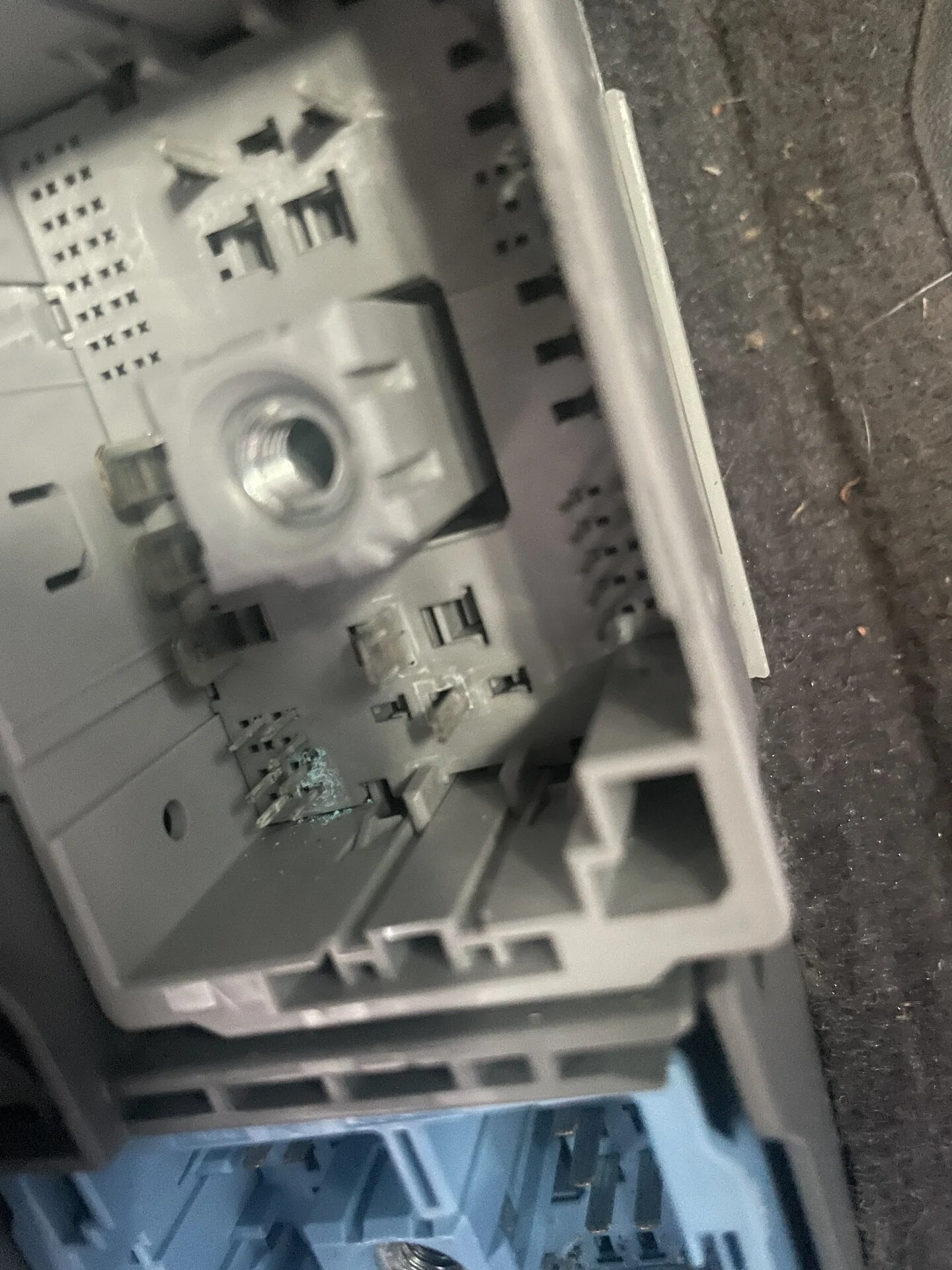

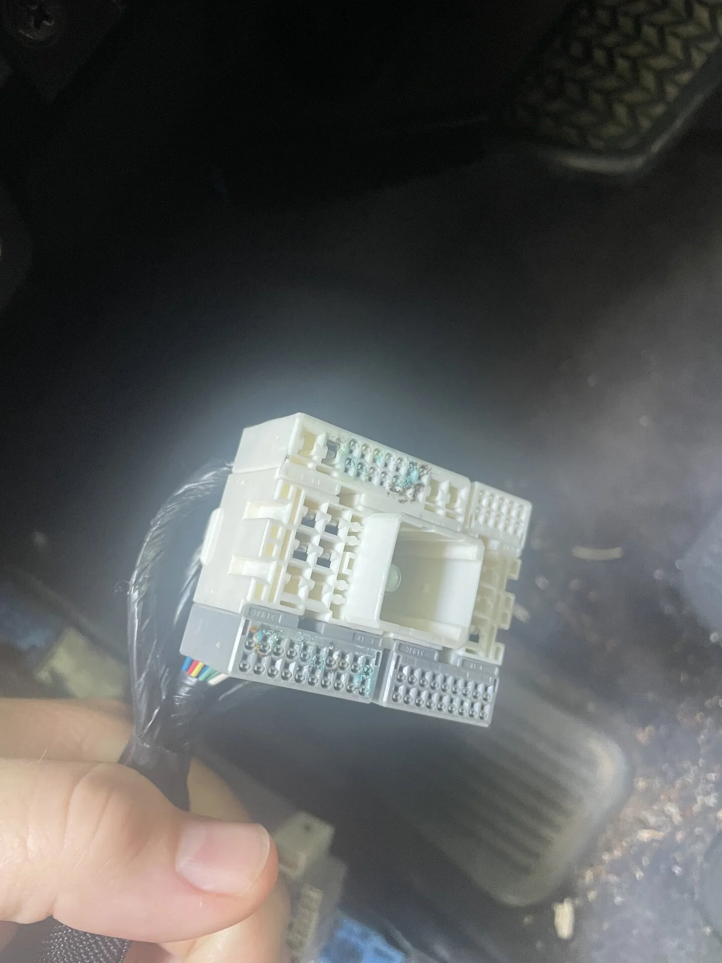

After the previous incident I pulled the trim and cleaned the connectors. They had some minor corrosion but were dry. I cleaned with electrical cleaner and a soft bristle toothbrush but the issue keeps occurring.View attachment 3387387
where are these connectors you are showing in this picture? Is it below driver side footing? If you can tell me how to get to them, I would like to check mine as I am having multiple error code pop up.
Check out this thread, it describes in detail on how to remove the kick panel and get to those connectors. I followed the procedure on the connectors on both the driver and passenger side.
